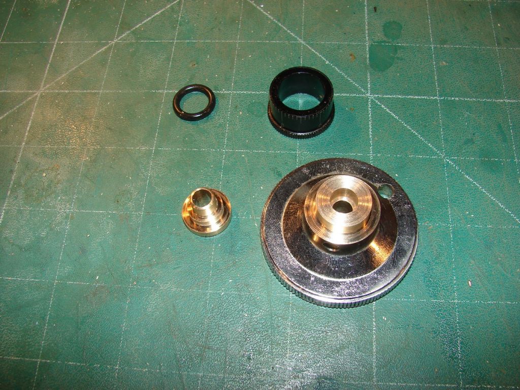

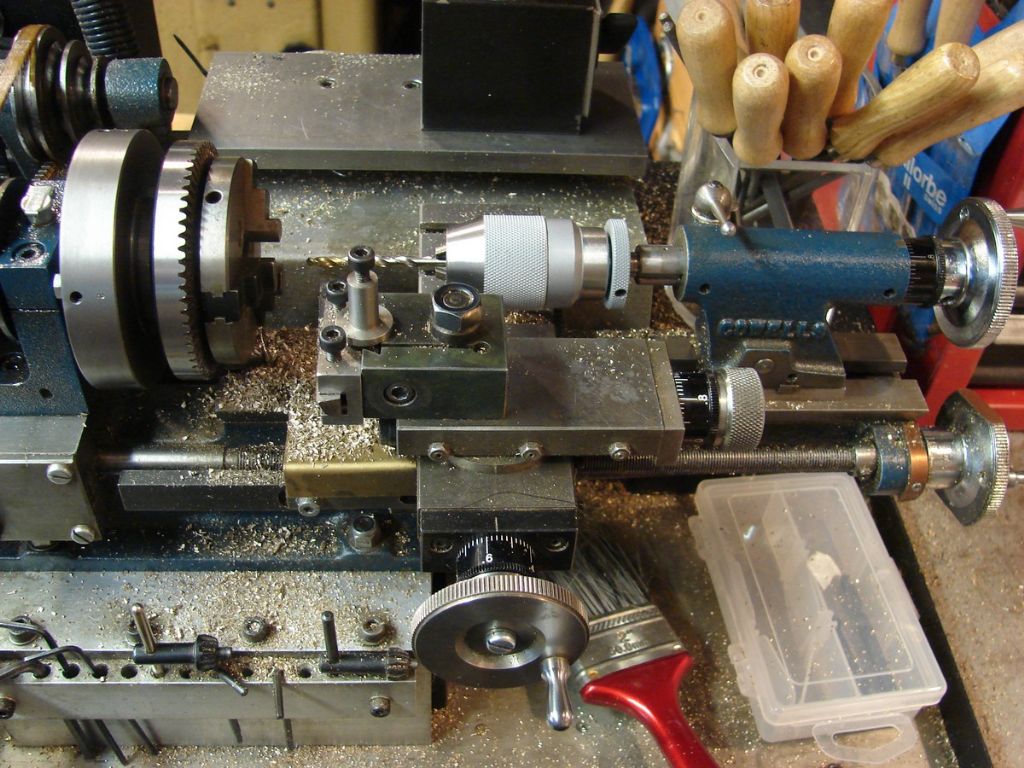

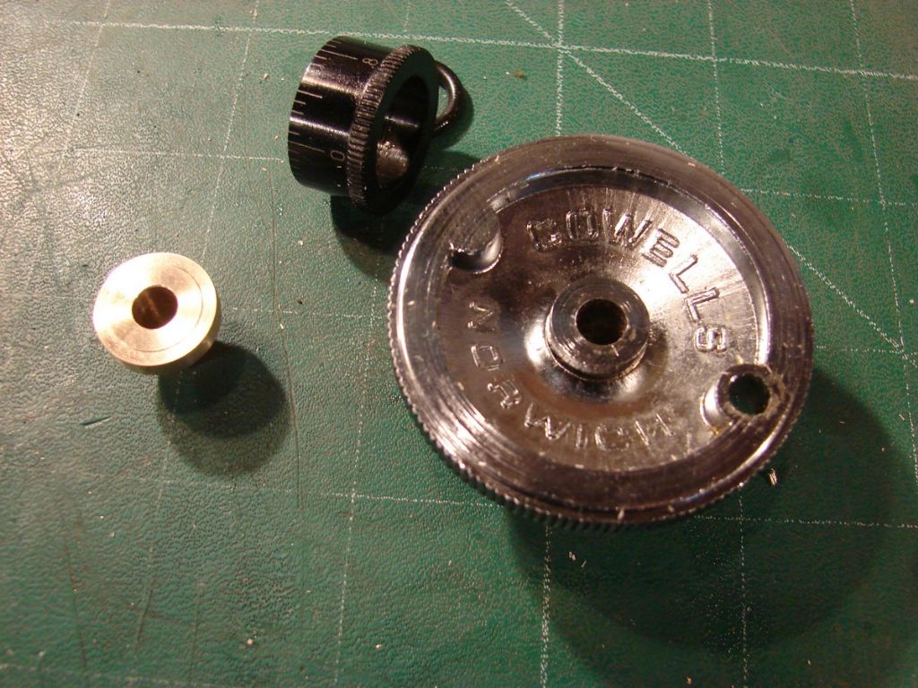

                Stephen Benson
                  @stephenbenson75261
                  I repair clocks also, just a few pointers on the Cowells lathe if the belt slips a lot then it is time for a new belt and you can easily upgrade the dials to resettable ones by ordering just the plastic dial and O ring from Cowells and modifying the handles yourself.
