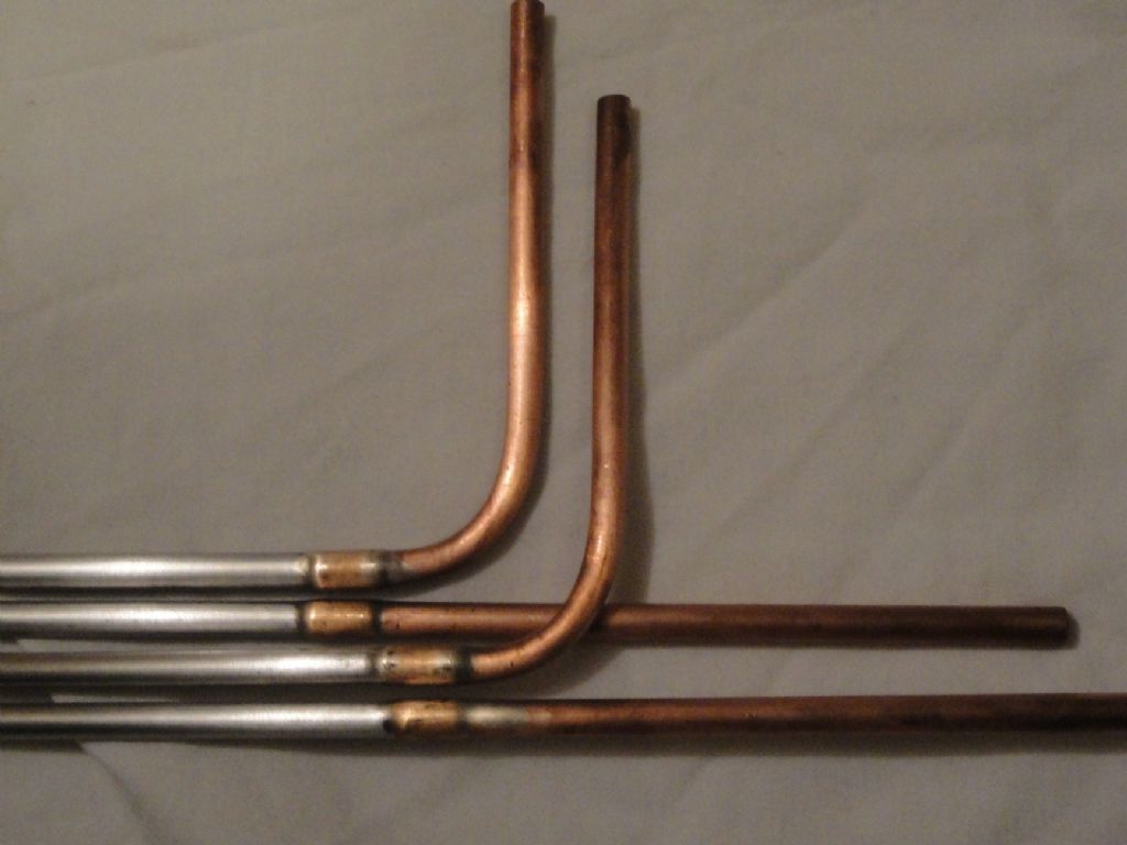

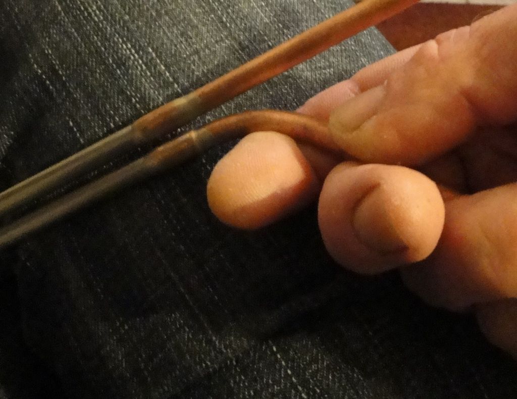

                                      julian atkins
                                        @julianatkins58923
                                        dsc00854.jpgi think many of you make things far too complicated! ive done many awkward pipe bends on my miniature locos.
                                        i bend the annealed tube between my knuckle joints. as soon as it gets 'tight' i re-anneal.
                                        here's a pic of me doing same to much larger tube for the radiant superheaters for my 5"g current project
                                        cheers,
                                        julian
                                        Edited By julian atkins on 12/03/2015 21:58:15

                                                Hi Julian
                                                Your bends look good but I consider them to be sweep bends which no doubt suits your purpose. I too make single bends in the fingers but when a tighter radius bend is needed I revert to a home made bender, especially useful for making multiple bends and sets in the same tube to exact dimensions. Even with machine bending it is as you say important to keep the tube annealed to prevent rippling or flattening.
                                                Neil, we don't all subscribe to MEW so not aware of any article but thanks for the link to Fields Metals
                                                Emgee
