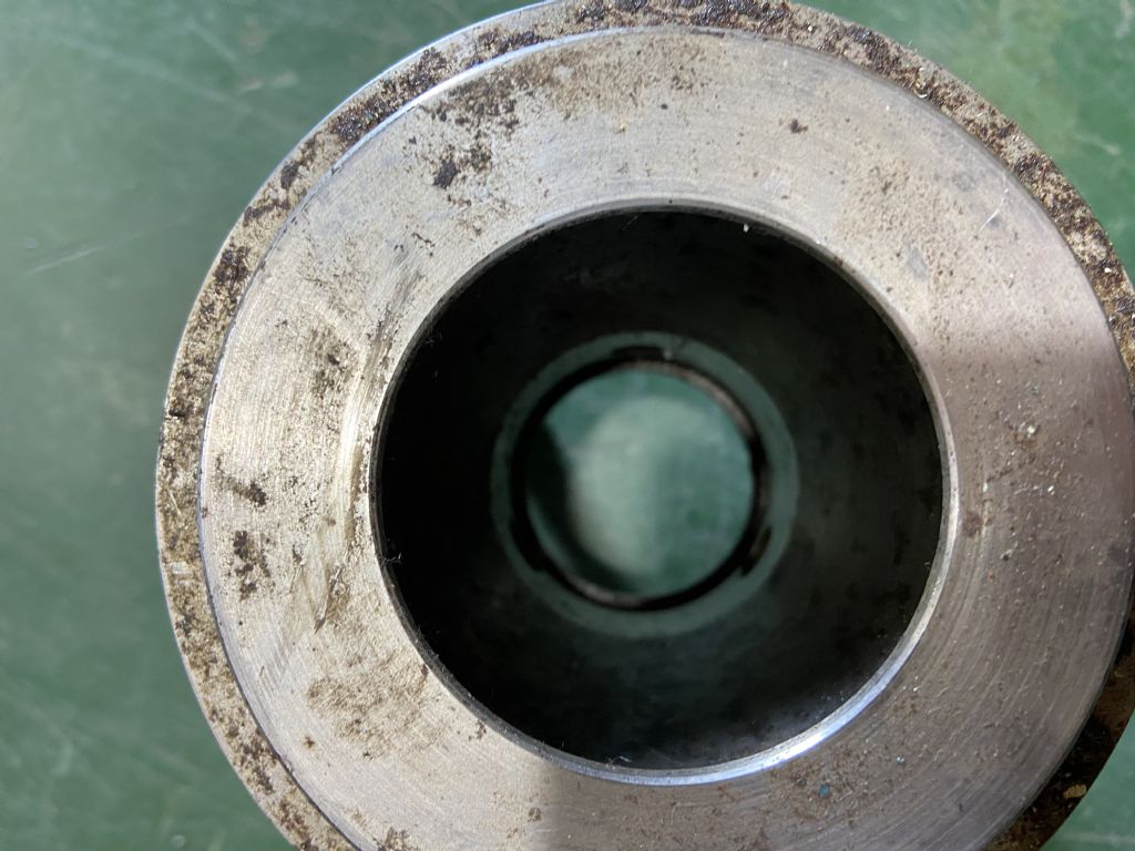

        got this chuck with my lathe, no collets came with it & I’d like to start collecting them.
        what are your thoughts? Burnerd multisize? Thats my guess so far lol.
        EC2-EC13 ?
        there are no markings or designations anywhere on the chuck at all, it is fitted with D1-3 mount for a colchester bantam.
        or … maybe its NOT a collet chuck & im barking up the wrong tree ?

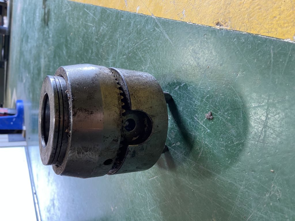

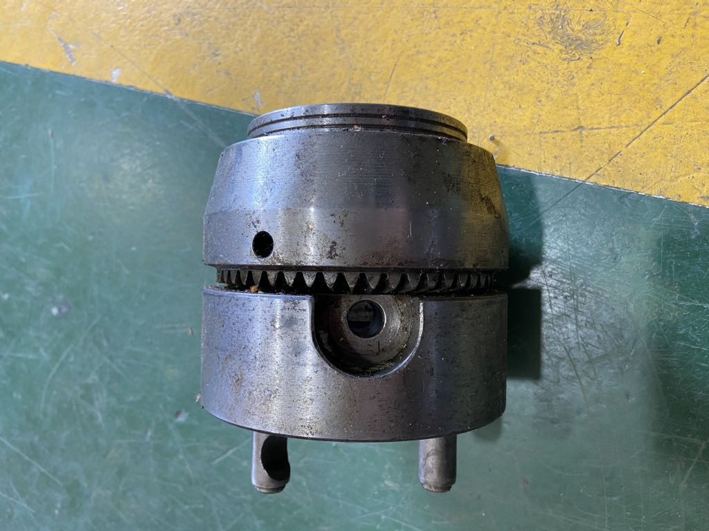

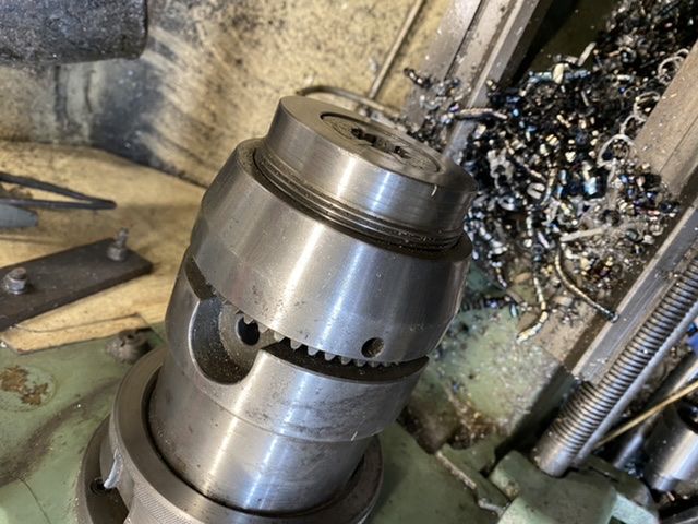

          NooNoo
            @noonoo22307
            d9b77b06-5cfa-4e22-9730-37d3fe635b68.jpeg3e1e158e-b0d9-4208-8d05-3fc3b046b3b1.jpeg37569a36-e680-4840-a684-8ead67c201b3.jpegLike this sir?

            Emgee
              @emgee
              Looks like your EC2 range collet choice is correct, check the dimensions of your chuck taper to compare with collet data to confirm.

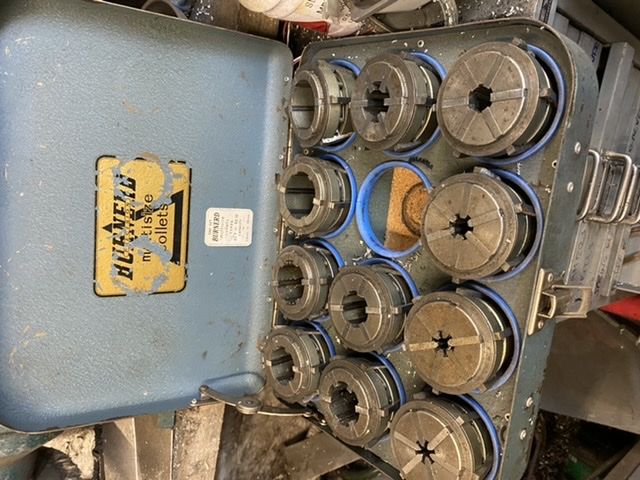

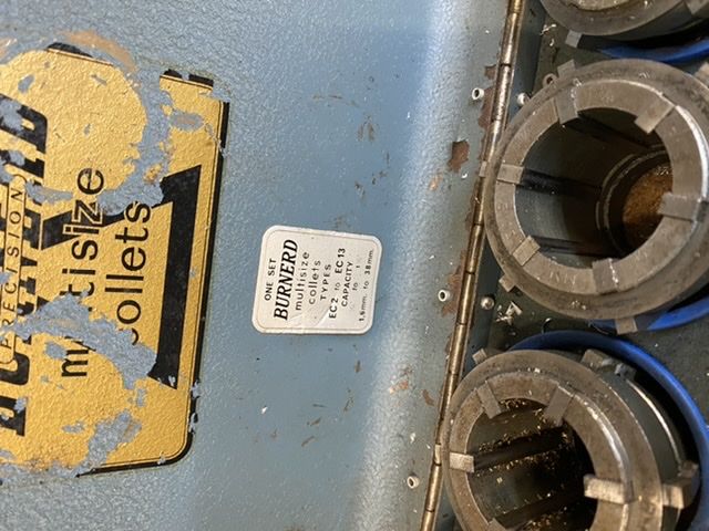

                  Ian Parkin
                    @ianparkin39383
                    83145873-aa85-4ea7-b071-a4d75ab38f95.jpeg5107c079-3b7f-490a-8b11-751b789564ac.jpegThese are what you want

                    #556858
                    NooNoo
                      @noonoo22307
                      Wow, thank you Mr Parkin, that does indeed look like mine … guess i was nervous as there are no designation, markings, makers mark or stamp … nothing !

                      Ian Parkin
                        @ianparkin39383
                        Mr Noo
                        theres only the size written on each collet
                        nothing as far as i can see on the chuck
