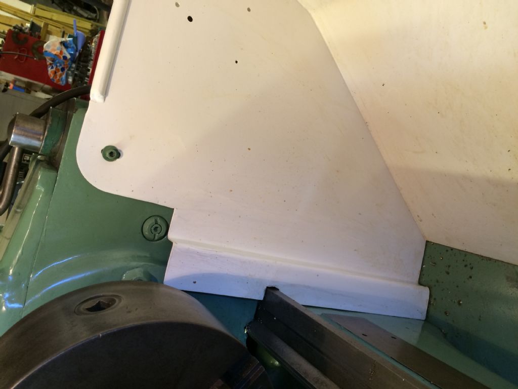

      Big compressor it is then! (one day)
      My belt grinder has a 2hp motor with vfd so I don't think it needs changing to run off air
      I'm not too sure what you mean by backsplash plate. My lathe doesn't have one like Phils does.

      #475935
      Phil Whitley
        @philwhitley94135

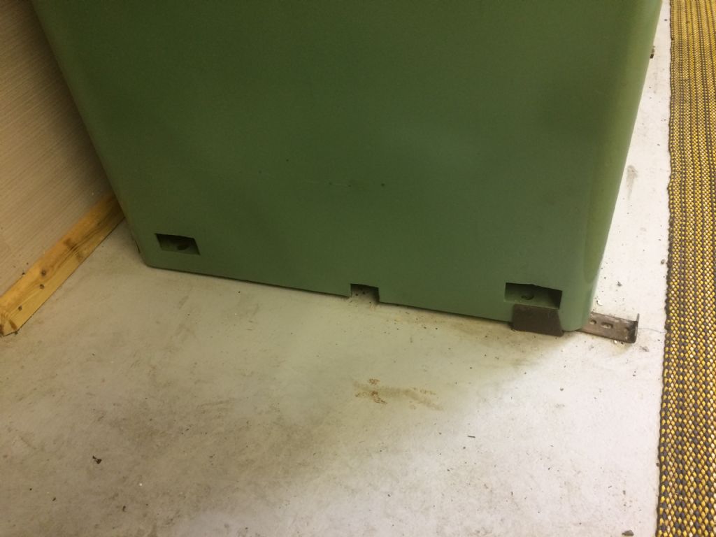

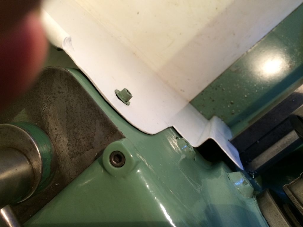

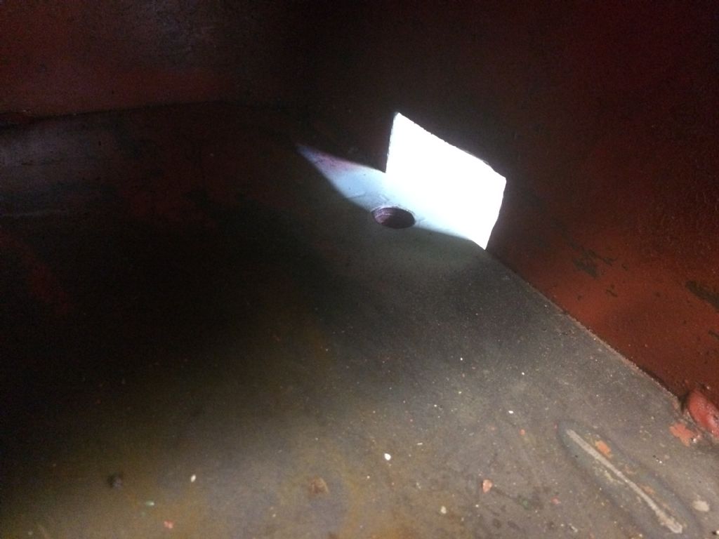

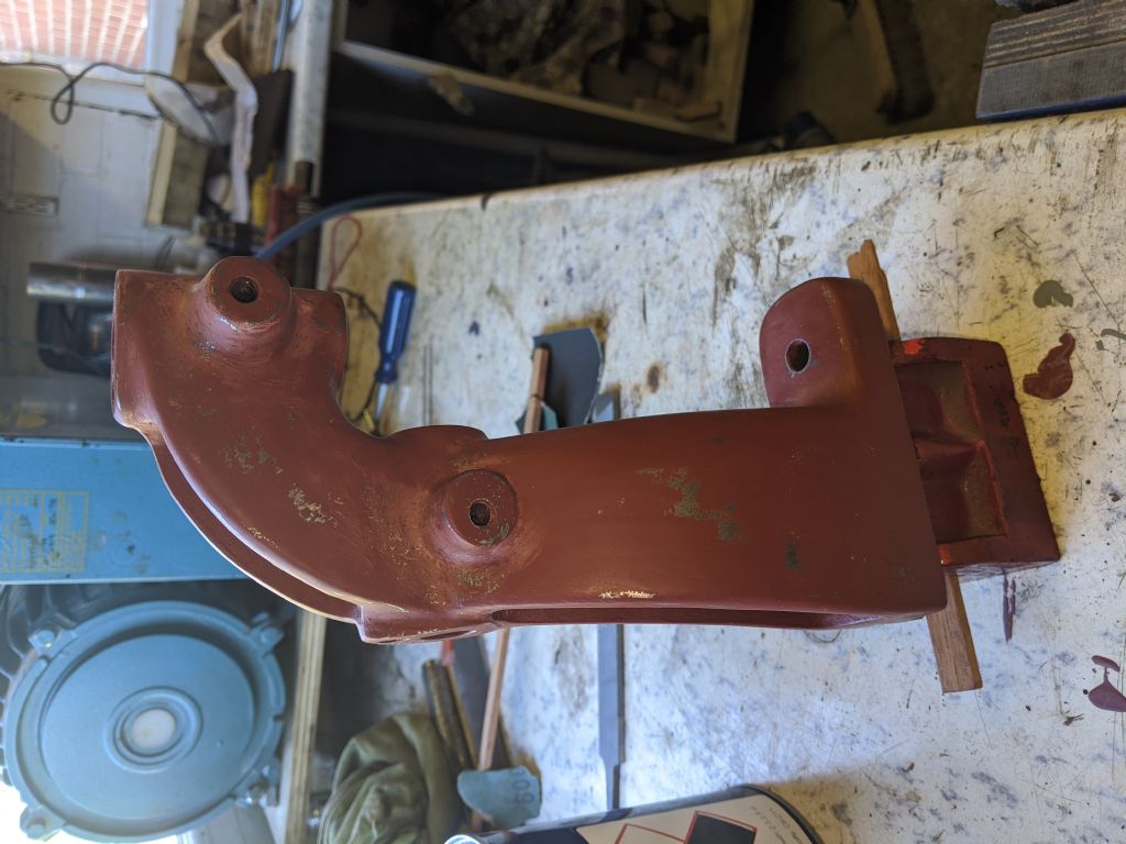

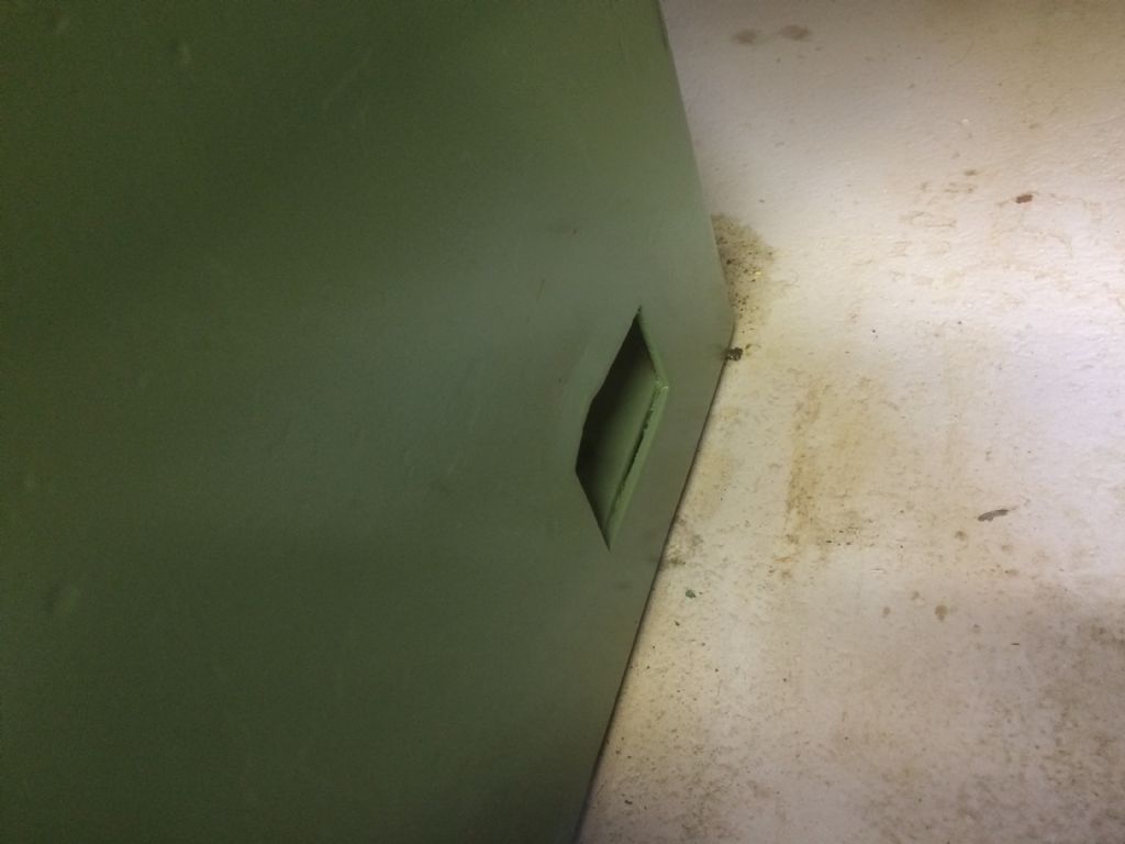

        here ya go Herman!
        #475939
        Herman van der Merwe
          @hermanvandermerwe76509
          Thanks @Phil, so I see the side plate is all straight with the last bit into a lip. I have a lot of panel beating ahead of me!

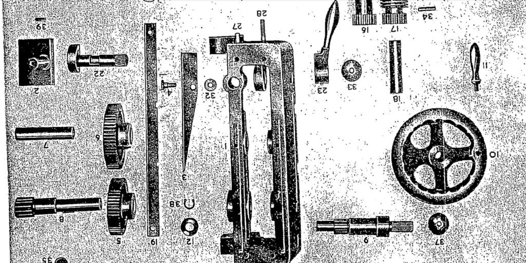

            #476135

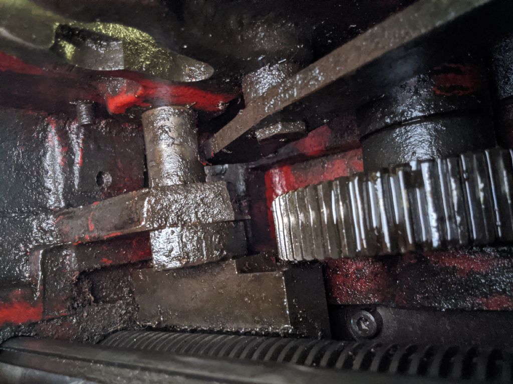

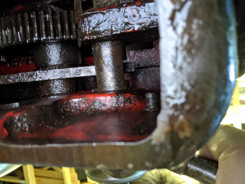

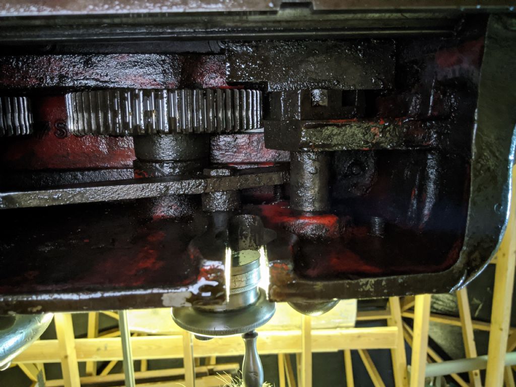

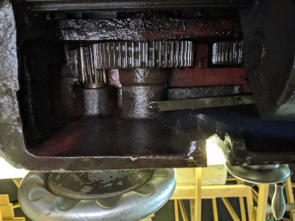

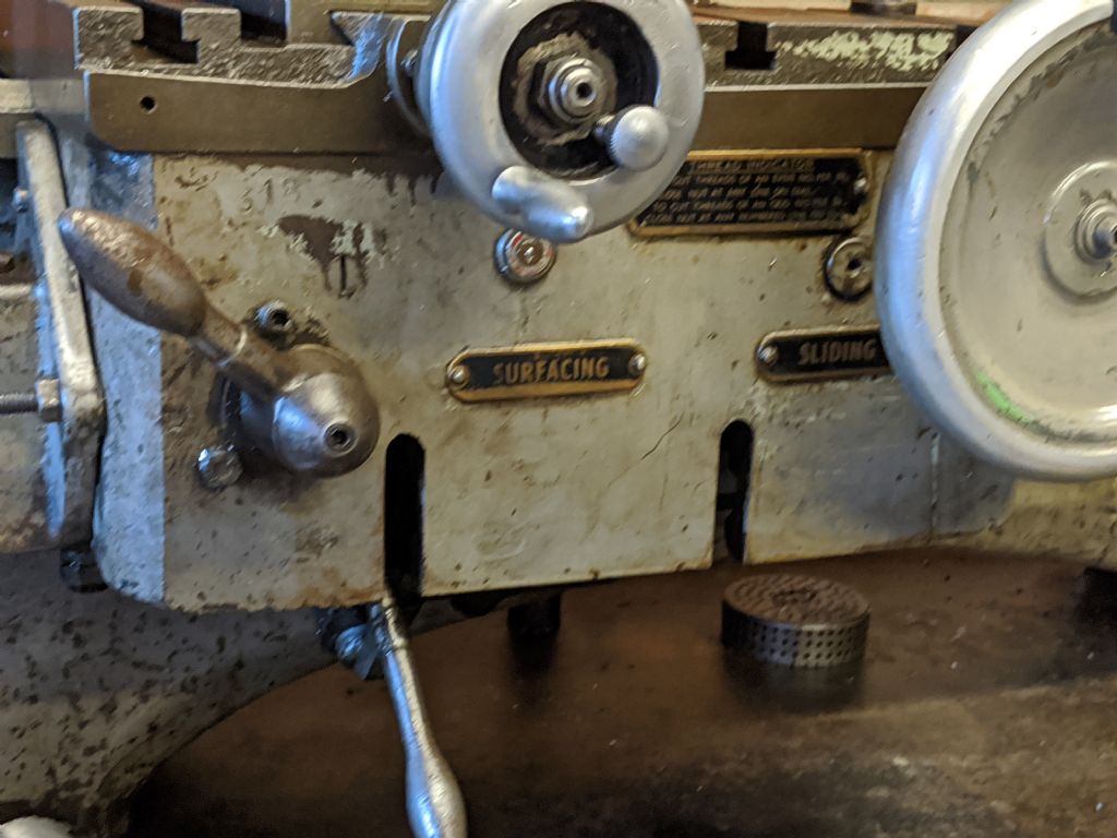

              Can you guys please post a picture of your lathe's apron? Not your kitchen one please
              We are trying to figure out what apron my funny lathe has and how it works.
              #476211
              Richard Kirkman 1
                @richardkirkman1

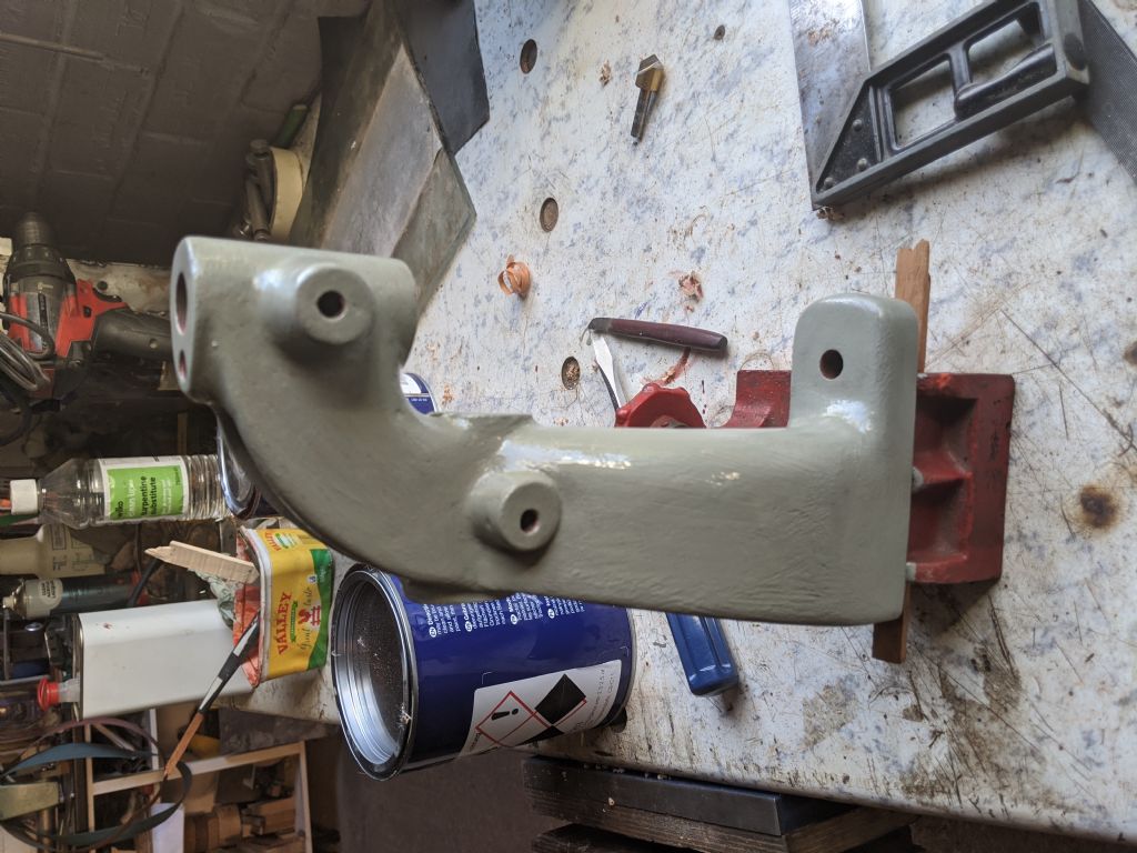

                I've made a little bit of progress with the traveling steady. Still getting better at painting, but I'm getting there. Sprayed it for the first time today, it gives a much better finish, I'm amazed, even with a wagner fence and decking sprayer. I just wish I had sprayed the primer on with it too! The finish could still do with improvement, but I'll sort it somehow.
                I think painting more things at once would be much better, so I might move onto doing a few lathe parts soon. I can feel the tailstock calling to me

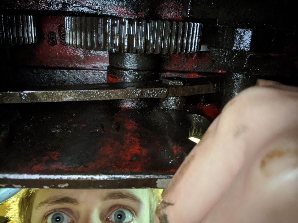

                Pictures and video of apron
                Video Link
                #476225
                  Paint work looks good! Keep hacking away at learning how to paint and then you will hit the wall … you will need a quality compressor ..
                  Thanks for the photos and the video. Seems like my lathe is missing the lockout arm thing. I will double check tomorrow if it maybe is not laying somewhere, but I doubt it.
                  I see your one gear is as bad as my lathe's! One day when you strip, clean and paint the apron you can take measurements of the lockout arm thing for me.
                  Thanks again @Richard!

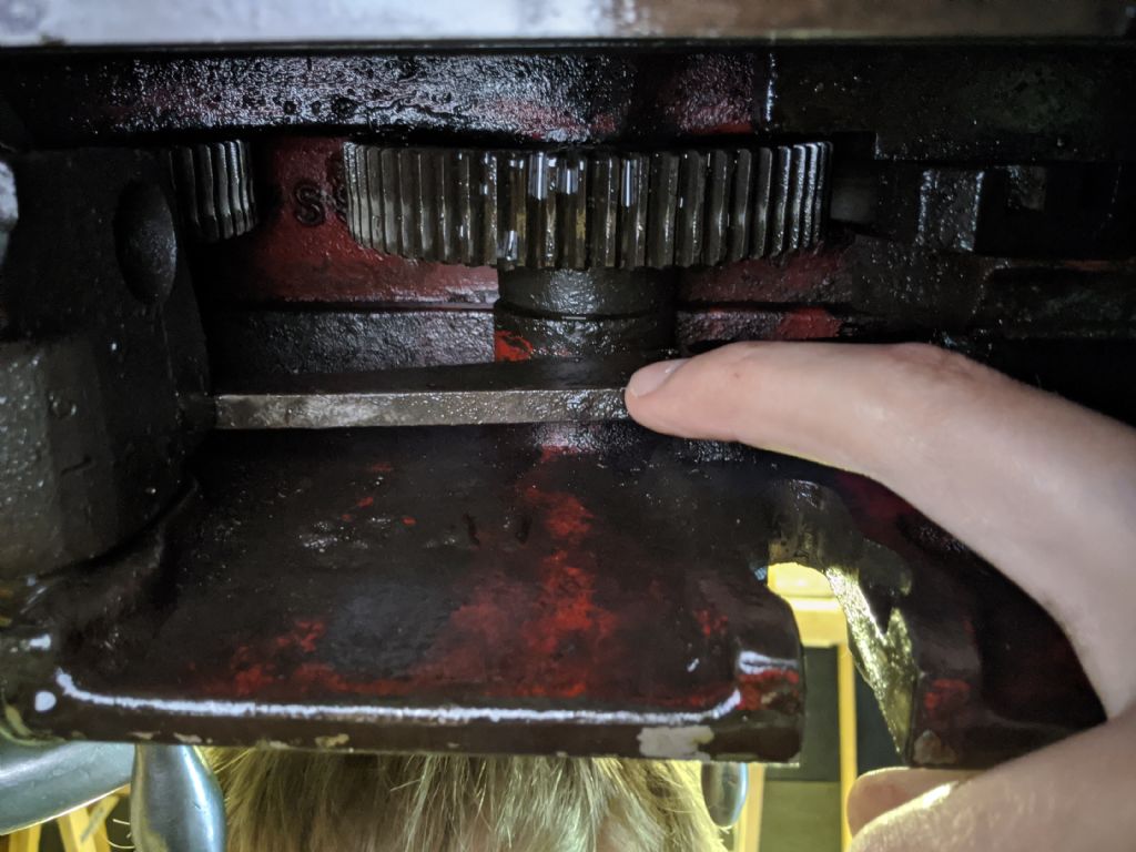

                  #476563

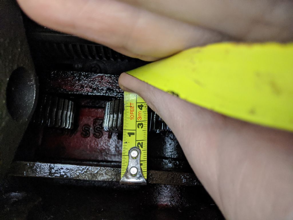

                    Posted by Richard Kirkman 1 on 30/05/2020 20:30:25:img_20200530_194337.jpg
                    Morning @Richard. Would it be possible to take some more pictures of the bolt thingy that holds the lockout arm in place?
                    I found a photo with dimensions on the Colchester groups.io page as below. Would it be possible to get something in the apron from underneath to check the length and possibly the width of the lockout arm against the sketch's dimensions?

                      More pics here. I don't think the thickness of it matters too much as long as it fits in the slots that are on the lead screw bit. As yours is in pieces i'm sure you can measure the slot and other parts. I can get even more pictures, but I think I've covered most angles that I can get to it
                      Just to be clear, my apron is shown in the manual that I sent in somewhere. So that's the place to look
                      i can't get a full measurement but the measurements from the picture seem right to me.
                      Look carefully at the shaft it's resting on, there's a flat.

                        Hi @Richard! Thanks for the detailed photos. These are really helpful!

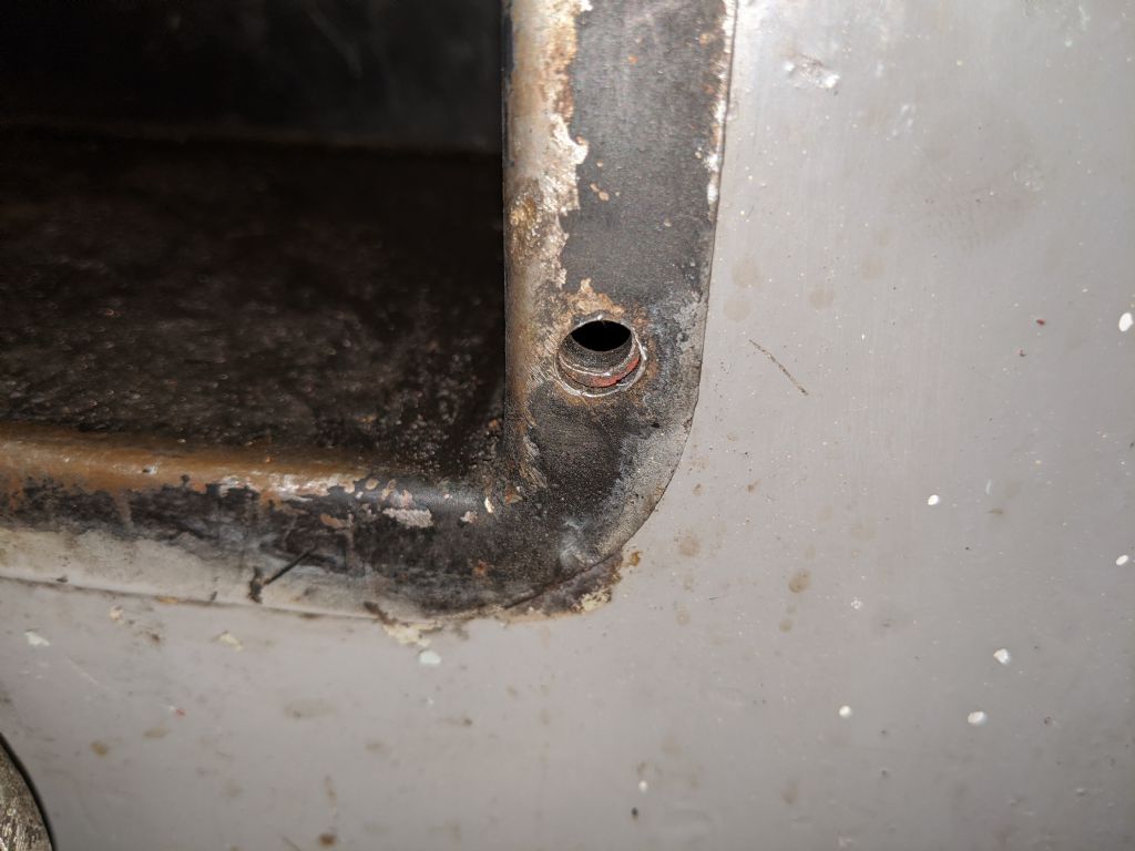

                          Posted by Phil Whitley on 25/05/2020 20:48:02:
                          Evening all!, well I was right, I haven't got the holes, or the threads, I have two bolting down holes without threads at the headstock end, and one,central, at the tailstock end
                          The hole that you guys have in the cupboard at the front of the lower shelf is not there on mine! Don't bother with the measuring Herman, it is sitting firmly on a level floor, and it is staying where it is until after I have replaced the spindle bearings and then do the alignment!
                          Phil
                          Edited By Phil Whitley on 25/05/2020 20:48:57
                          @Phil, while I was searching for details about the apron lockout key thinghy I read that your lathe must be fitted with leveling pads. These fit from the bottom of the holes and you adjust the nut on the pad's threaded rod to get the lathe level.
                          I would recommend you buy machine leveling pad with the ball joint in the top of the pad which allows the threaded rod to enter the lathe exactly perpendicular to the lathe's bottom plate.

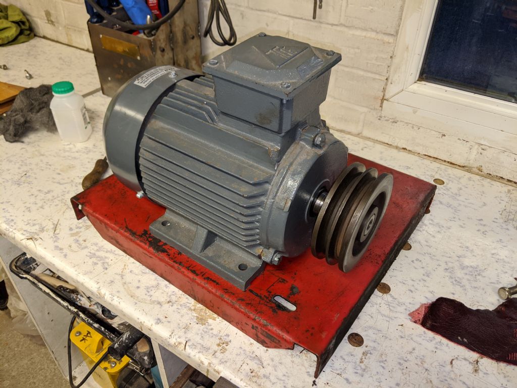

                                I have changed the motor. I am now using a TECO 2003 3hp three phase motor. So much more modern.
                                I understand and appreciate your concerns. However i don't see the issue, the literature shows that the converter can run any single motor 5hp or less due to the power compensation circuit which eliminates the need for selecting and deselecting different amounts of capacitors for different motors. So my understanding is that it doesn't need to be suited to the motor, since it adjusts itself and works for a range.

                                  My apologies. I was not aware that you changed the motor. I must have missed this post(s).
                                  In this case, yes buy the two running caps and the one starting cap with values matching the existing. I would simply buy three running caps from the Surplus store.

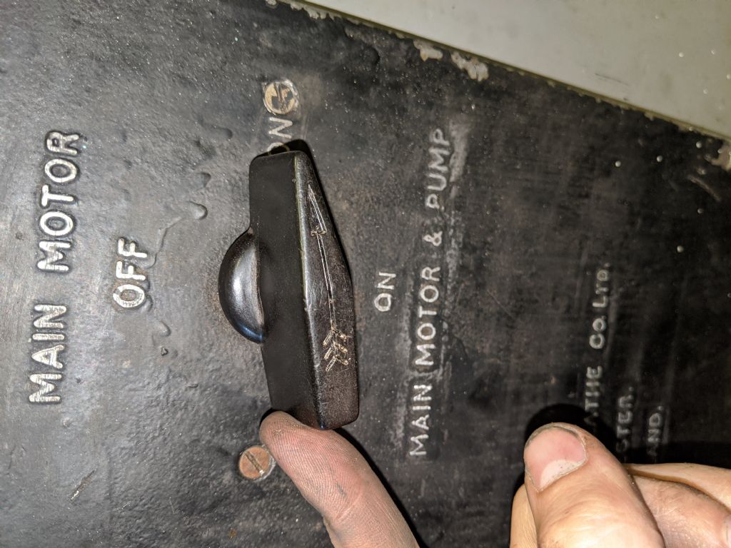

                                          I found the picture that I took of my apron in the manual, might help a little if you haven't looked it up
                                          Also, I have been speaking to the man who I bought the converter from. He seems very knowledgeable about these converters and what he's saying is very interesting. I'll let you know if anything comes of it

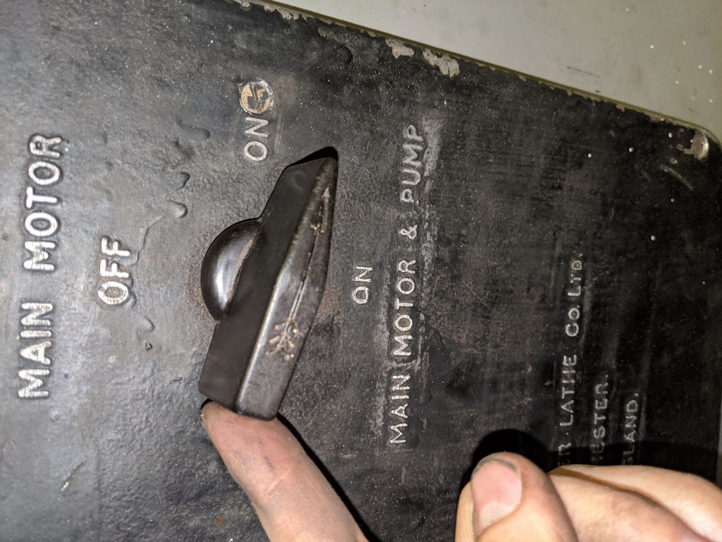

                                                  I've just had a little play. I think the capacitors aren't causing the lighting issue, I think its the vibration of the lathe shaking a connection loose. Have a look
                                                  VIDEO.
                                                  Yes, The lathe doesn't quite knock itself that hard. But it does vibrate. What is this caused by?
                                                  A bad connection perhaps? Contacts in need of cleaning somewhere?
                                                  I'll still be replacing the caps when the new ones arrive and the spade connector
                                                  #477265
                                                  Richard Kirkman 1
                                                    @richardkirkman1
                                                    Back to some actual fixing
                                                    I think it was just caused by the entire box not being secured properly. A few of the threads are stripped so it's hard for me to get the box all the way in, however when I managed it worked nicely. I also cleaned the 3 prongs that the power goes through, and the holes they go in. The box bit was bent out of shape too, so I have beaten it back into shape so it now fits nicely.
                                                    I managed to get two of the screws in and they held well enough to make it work nicely!
                                                    VIDEO
                                                    I'll drill and tap them M8 and buy some bolts, which I will turn down to the correct dimensions and put a slot-head on. This way I can get the exact fixings I want. I believe they're currently quarter inch, but I dont have any imperial taps, so m8 will do.
                                                    Also, while I'm working on the box area, I'll give everything a good clean and take a look at the starter switch. It's always had quite a bit of slop to it, so I'm going to sort that out by making a sleeve to go inside it. If I leave it wobbly then It's only going to keep wearing until it breaks fully. The only issue is, I'll need a longer bolt to fit inside for the way I want to do it, so I need to figure out what thread it is.
                                                    I'll also have a look at the forward and reverse switch as this seems to be loose too.
