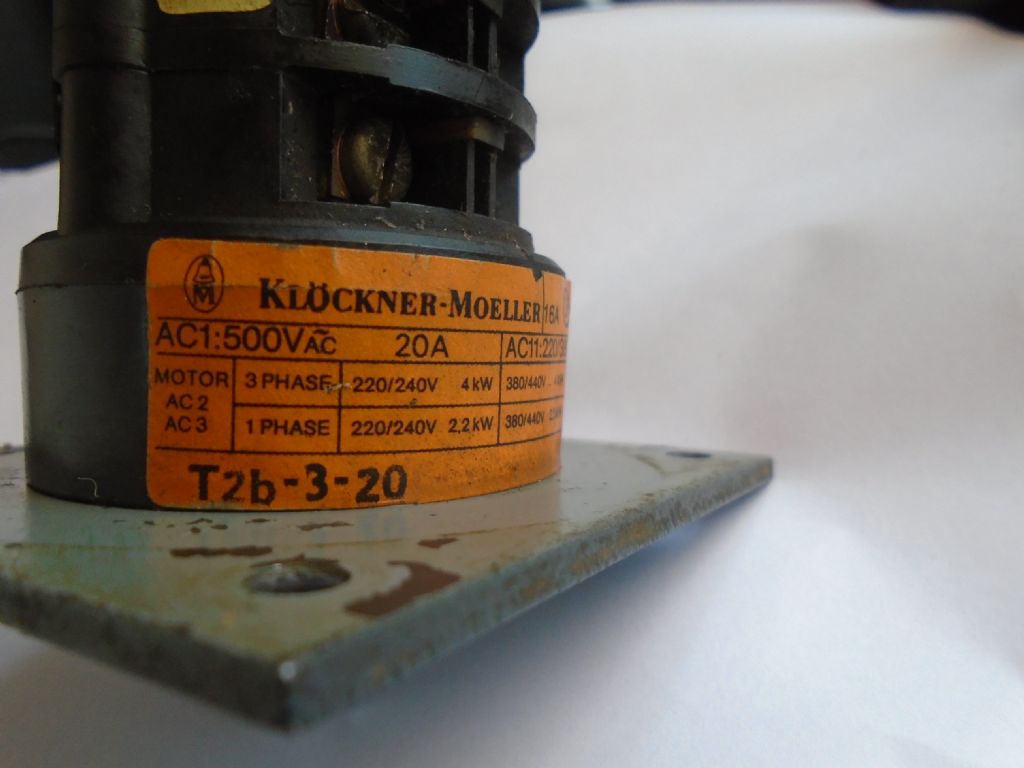

      Hi. I have a Colchester Bantam Mk2 800. It's a 3-phase machine running off a Transwave converter. Recently it won't start and I've now discovered why. The foward / reverse electrical switch mustb have developed and fault and has been arcing and burnt away part of the switch. No wonder the overloads kept tripping. Does anyone have a spare switch, know where I might obtain one or got any other suggestions? I realise I could fit a straight forward FORWARD/OFF/REVERSE switch and may have to go that route if I can't obtain one but it will be so much better and safer to use the standard operating lever as I have been for the past 20 years. Thanks. Tim

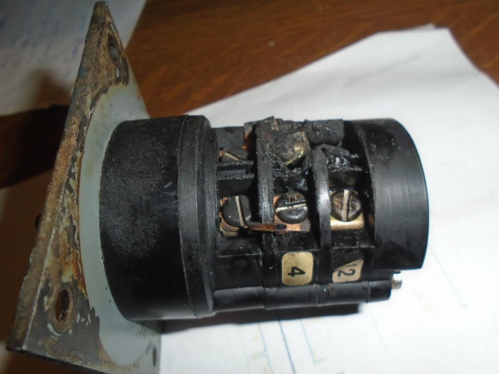

                Posted by Simon Williams 3 on 03/12/2020 12:24:24:
                My copy of the parts list shows a part number of the F/O/R switch but doesn't show a picture. It's a long time since I had the switchgear in pieces, and I can't readily get to it, so could you post a picture of the offending item? Does it have a manufacturer and a part number on it? The operating mechanism is a bit special, but the body of the switch if I remember right is a standard item.
                From the cct diagram it's drawn as a six pole cam switch with four changeover poles (i.e. two as on/off/off and two as off/off/on) , the third pole is on-off-on, and the fourth pole is off/on/off so it's nothing special. If you take the original to your local electrical wholesaler – City Electrical or Newey and Eyre or similar – they should be able to identify something functionally equivalent.
                HTH Simon
                Thanks Simon.. If I don't get any joy I will try somewhere. The switch is awkward to get to and took ages for me to get it off. As you say the funcitonality of it is fairly standard. The problem I envisage is that for a direct swap it must mate up with the operating mechanism and needs to turn by the same amount (about 30 deg in each direction).
                Here are a couple of photos of it
                F/R SWITCH 1
                F/R SWITCH 3
                If I don't get any joy I may be able to strip, clean and rebuild the switch so that it only uses the 1st undamaged segment. and only for feeding a contactor to bring in anothe FORWARD/REVERSE switch. That way the lathe will still be started and stopped in the same way and the rebuilt switch will only be operating on 110v and with minimal current to operate the contactor.
                Tim

                  If you put t2b-3-20 into Google, you obtain many results. Try this one as a starting place:
                  https://www.klocknermoeller.com/moeller.electric/2008/rotary-switches.pdf
                  It looks like the part numbers have changed, but I think the one you have is almost the exact centre of page 10.
                  As you say, it is an absolutely standard rotary drum switch. Every proper manufacturer will make one with the equivalent functionality.
                  If you cannot find one with an identical arc of operation, that is an engineering challenge that might easily be overcome with some thought.

                                It took a few months but I finally got there. I couldn't find a suitable switch anywhere. I did eventually manage to get another switch on ebay from a Colchester Student that looked similar but internally it was quite different and the connections were completely wrong. I did however manage to salvage enough from mine to build one out of the two, modifying some parts as necessary. I thought I had some photographs but can't find them and my memory's very hazy about what I actually did. It works absolutely fine now.
                                I found the problem had been caused by oil getting into the switch causing the arcing.
                                If I had to fix it again I would search for klockner moeller t2b on ebay. A switch with 3 or more segments would do. I would then hope I could make one out of the 2. When I was searching I did find a few on ebay that were from abroad but the only one that wasn't stupidly expensive kept refunding my money when I tried to but it. I wasn't prepared to pay a great deal of money for something that might instantly have proved to be totally unsuitable when it arrived.

                                                  My switch melted as oil got in it, causing arcing which melted parts of it and causing it to short. This could be the same problem. The new switch 'either does nothing or trips the overloads' depending on how it's wired up. It needs to be wired up correctly! It it's connected incorrectly then it is likely to either not work or trip something depending what is connected to what. 1st thing MUST be to ensure that the new switch is making the correct connections in the various positions. Unless you've got that it will never work. Once wired correctly if still not working then yes check the motor. The motor could be checked 1st but it still won't work unless the switch works correctly.
