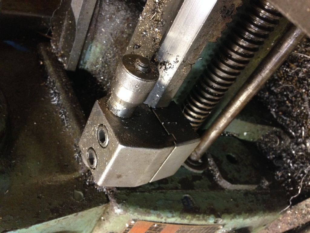

                                                  Sandy, if and when you get fixed up with a bed-stop and if you want to adjust the clutch to trip reliably I may be able to help with the relevant info.
                                                  I'm using a home made stop and yes it needs to be tight if the bedways are lubricated. I'd be keen to see dimensions of the Colchester stop.

                                                    This is the carriage stop that came with my Bantam. No idea of the parentage but it likes to be nipped up tight. I fitted the keyway and replaced the bottom piece so that it sat better on the ways. It's loose here, so not sitting square but you can see the idea. I've never found the micrometer dial worth bothering with. Instead I usually finesse the position using the top slide.
                                                    As ever, the picture is sideways as a testament to Windows 8 which knows better than me which way to orientate the photo.

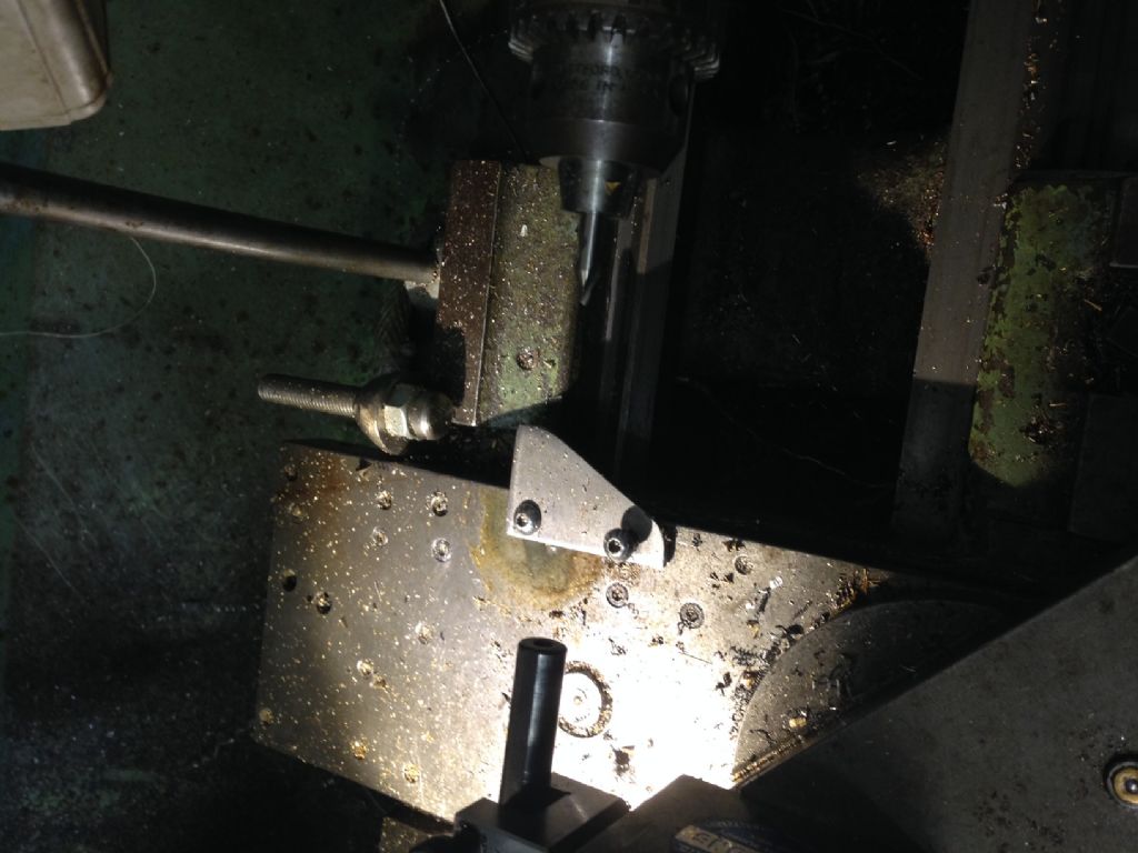

                                                    And here's my cross slide stop. It is pretty basic and only works for feed direction away from you due to impatience when I made it but it can be pretty handy when facing with power feed. There are 3 tapped holes which allow it to be fitted in 2 positions, giving me all the adjustment required in combination with the threaded stop bar. The transverse and longitudinal power feeds will trip out in both directions against any firm stop.
