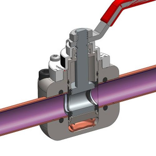

          Yes, very clever, but where did the swarf / piece of tube that was removed go to ??

            Interesting, and definitely useful to have for the house 'emergency kit'. But, I wonder how is it made so as to be able to contain the swarf and/or cut-out portion?

                It's designed so that the bottom of the valve has a punch built into it & the piece drops into the cavity underneath & out of the way of the valve body & flow…

                            I can see the removed tube ends up out of the flow but where does the swarf go?
                            I assume the copper tube is sawn through and not sheared so if the water is flowing whilst the valve is installed the swarf presumably is flushed through to your cup of tea.
