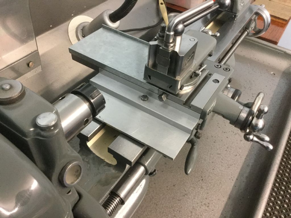

                        Jon
                        Do you have swarf trays fitted? They help a lot in keeping debris off the bedways and out of the slides. My own are shown below. I also have a wiper on the front of the tailstock.

                          Off topic but that is a really good photo Mike. Nice lighting and clear image.

                            Mike, that's very tidy. Are you using the mounting hole for the travelling steady? Sorry but I may just have to copy that.

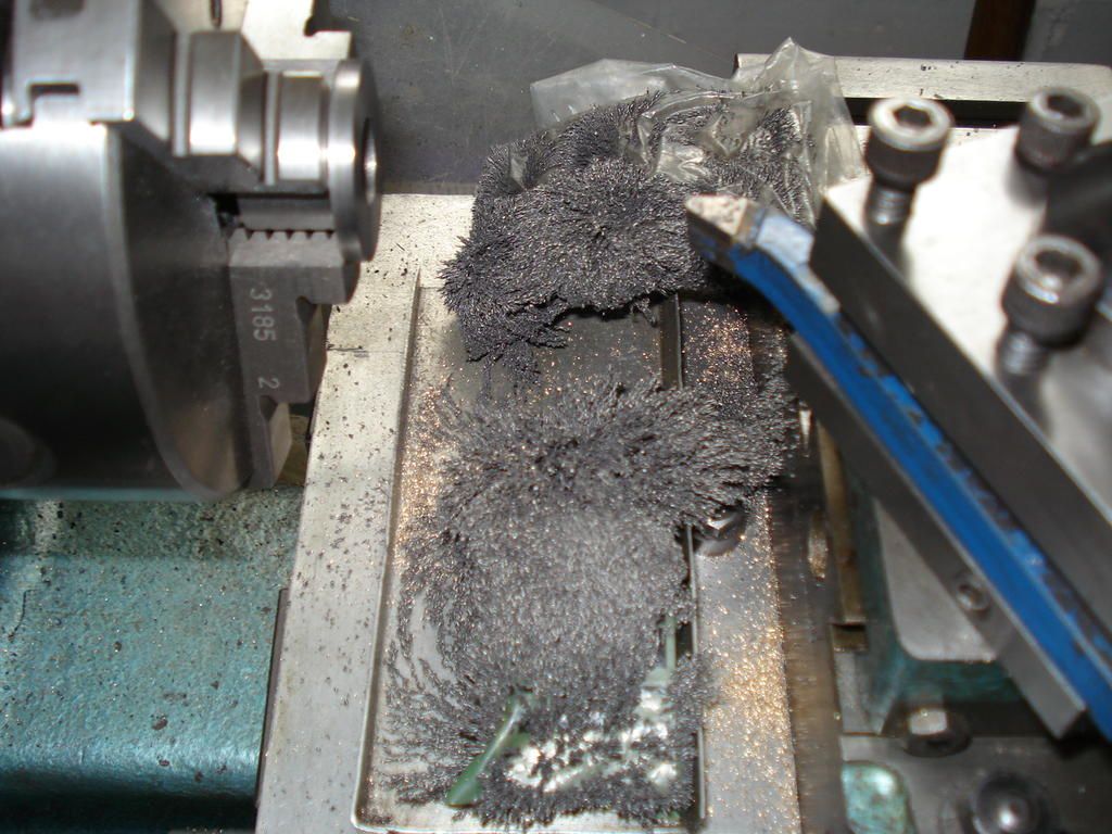

                                  "I'm getting worried about how much cast iron dust gets into the slide mechanism of my ML7, "
                                  Buy some rare-earth magnets, put it in small plastic bag and attach bag safely near or on cutting tool – even on exit end of a CI cylinder if using a between-centres boring bar.
                                  You'll collect a good %age of the CI dust which can then be dumped by taking magnets out of the plastic bag.
                                  I bought a pack of these and super-glued 2 rows of 5 into drilled holes in a piece of brass = flat outer surface..
                                  **LINK**

                                      Posted by Fowlers Fury on 08/08/2018 15:22:21:
                                      **LINK**
                                      ​Ditto… have a couple of these sat on my machine permanently.

                                          A cruder version of what Fowlers Fury is suggesting is to place a strong magnet beneath where the swarf is going to fall, and then to drape newspaper over the bed, so that it won't get gathered up by the chuck. (Thin plastic sheet would do, as long as long as the swarf will not melt it and burn through).
                                          When you have finished, or have so much that you need to unload it; shake/brush/push the swarf into a pile (most will be over the magnet anyway), then lift off the paper, without spilling the swarf, and tip it into a suitable receptacle.
                                          This should keep most of it off the lathe bed.

                                                + 1 for using magnets . Collects most of it and if careful, you can remove the magnet from the plastic bag and the dust falls into your preferred receptacle-

                                                    I use magnets for collecting swarf in the tray of my hobber. I t stops th fine stuff from clogging up the oil pump thought I've just bought some paint filters to use when hobbing cast iron.
                                                    The only big drawback from using magnets is that they tend to magnetise all your tools, which in turn causes the swarf to stick to them and that gets very annoying. I have to have de-magnetising sessions every now and again.
