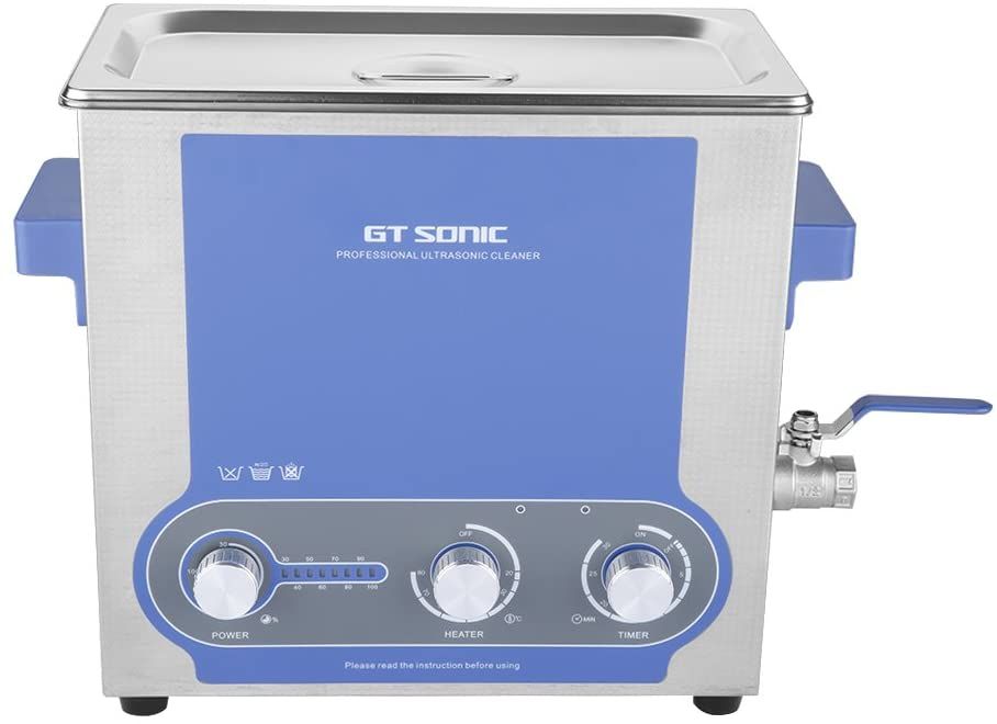

                                    I bought this one from Amazon. it was £105 but its worked handsomely for the last 2 years. I think its a digital one now.
                                    Ultrasonic Frequency: 40KHz
                                    Ultrasonic Power: 45-150W
                                    Heating Power: 300W
                                    Tank Material: Stainless Steel
                                    Tank Capacity: 6L
                                    Tank Size: 30x15x15cm(LxWxH)
