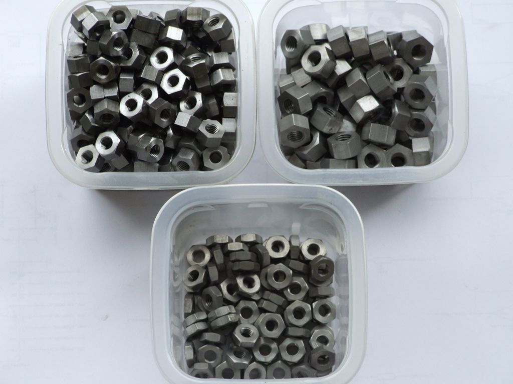

                    It's simple enough to buy 1/2" steel round bar. My (commercial) steel stockholder has a variety of grades varying from £3.21p to £4.38p (plus VAT) for 3m lengths. I've also bought 1/4" BSF fasteners, and they were nothing like the prices mentioned? Although it is best to avoid those companies serving the vehicle restoration market, as they seem to have 'how much?' pricing for imperial fasteners.
                    When I made my own 1/4" BSF nuts (and bolts) I used 11mm AF hex; conveniently I had a 11mm hex collet:
                    Andrew

                        Nice nuts Andrew. I never knew that BSF/BSW was so rare that you had to make em. Although, I appreciate that yours are a bit fuller than normal and the others "half nuts" ? or lock nuts. Last time I visited Oz, BSF/BSW were quite common alongside metric. I also went to an outboard repair shop, and he had the lot including UNF/UNC, but I suppose Oz is a bit far to go.

                                Posted by Speedy Builder5 on 17/08/2016 13:51:58:
                                Thanks Bob, but they're not rare, it's just that the commercial ones don't come anywhere near the standard I expect. I did buy some cheap commercial 1/4" BSF bolts and nuts but they simply didn't 'measure' up. They're now relegated to jigs and fixtures. The nuts, and locknuts, are based on the old Whitworth standards, although the AF dimension was determined by the hex collets I have, and in the case of the 5/16" BSF nuts the available space on the cylinder casting.
                                Of course having a repetition lathe helps, once set up it is easy to churn out parts quickly. All the nuts shown only took a few hours over a few evenings. And all done with freehand ground HSS tooling, not a jig in sight. smile
                                I've also made my own BSF studs and bolts. These are all highly visible parts of the engine, on the cylinder block and motion work, so I want them to stand out. And it allows you to get one over on the rivet counters. wink 2
