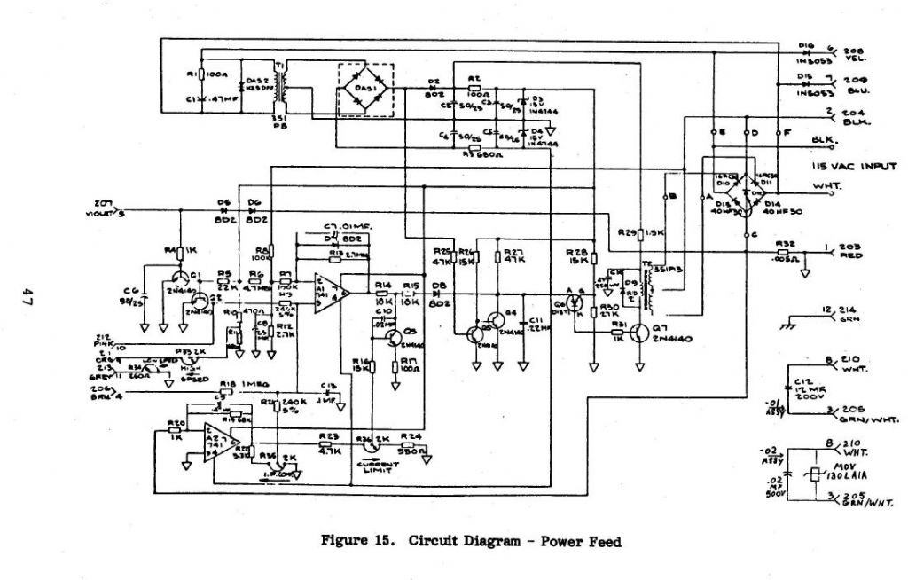

                      Don't know which ones you've been given as I can't read your PMs. However, from an early US manual here is one schematic for power feed. Sounds as if it's probably different to yours but it's quite interesting. The old 741 opamp is in there along with lots of old transistors. Quite a lost art designing that kind of stuff…
                      Merry

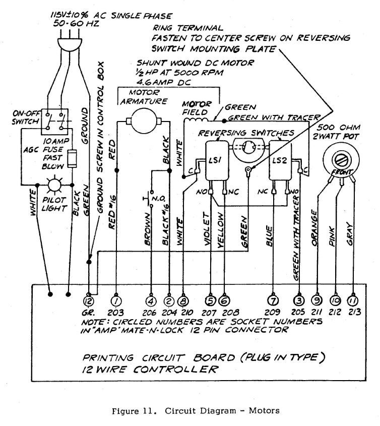

                        I have copy of the Erskine PCB layout with all the component values, if you send me an email with your address and phone number I will post you a copy and explain a few details. The table motor is a 110 volt DC shunt wound motor and to test it I fixed up a yellow 110 volt power tool transformer and a bridge rectifier, you can see where the 4 wires go inside of the control box. Mark the 4 wires that go to the table motor and disconnect them. Then connect them to the temporary 110 volt supply. One of the faults I have found is the variable (pot) speed controller failure, its an easy job to change.Another fault is a resistor on the board over heater, you can see by the burn marks it should be green ceramic colour,it needs a higher wattage if you have to change it as it might be open circuit. I haven't fixed one for a long time and can't rember other details, but as the day goes on I'll get back to you.Ted

                              Hi, does any one have a circuit diagram for the F6 feed PCB, ie the UK version which differs from the USA version as per the manuals show and is reproduce above, mine is a "Easkine revision 4" … I am particularly interested in finding out the value of R6 as mine has been damaged (burnt out) due to a micro switch problem.. and comparing other values from the PCB they dont match the circuit diagram.
                              Many Thanks Mark
