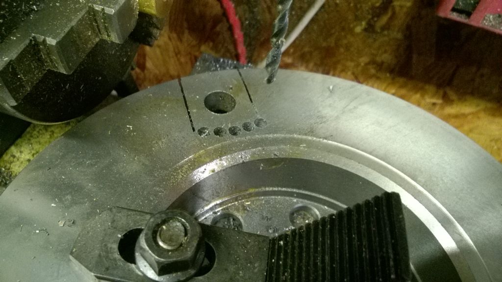

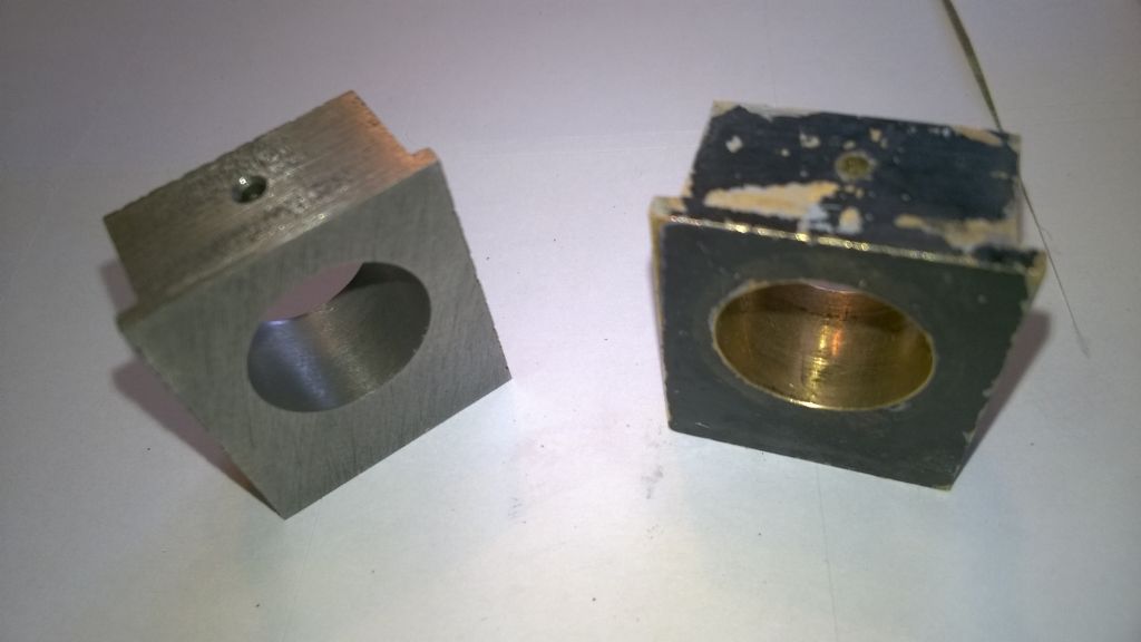

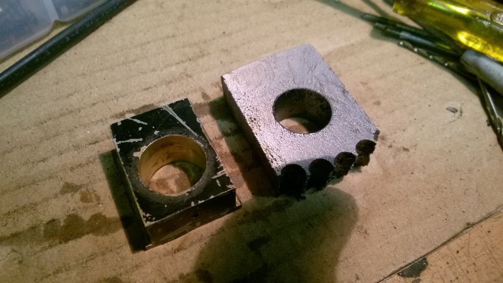

      I need to make some replacement axle boxes for a MW 14xx kit that I am putting together and improving on the way.
      The axle boxes are brass as you may know so I want to make some CI ones but finding it difficult to locate 1/2" think CI machines plate or block – I'm being a bit lazy and not wanting to go machining a big chunk of CI down.
      Is brake disc material suitable CI for axle boxes ? (assuming I can find a solid disc 1/2" or more thick) ?
      ta

                            That's great guys and nice and cheap too! Solid discs aren't too difficult to find tbh, but I just wanted to hear opinion on the material

                                            I ordered a Nova disc yesterday from ebay and it arrived already. Looks to be perfect with a ground finish to 1/2", well 12.6mm so ready to go! I'll update once on the job
                                            Lee

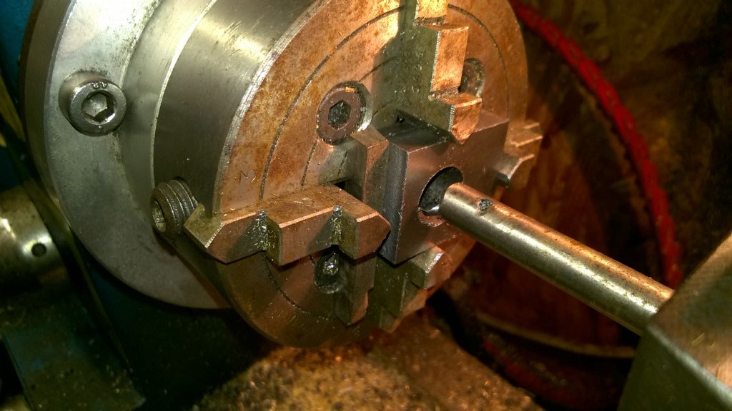

                                                      Worked out well and nice to machine. Much cheaper then buying a bar form one of the usual suppliers. £7 inc 24 hour delivery I could probably make at least 10 axle boxes from one disc.
