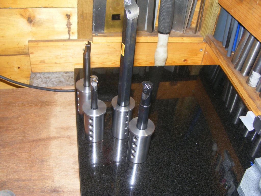

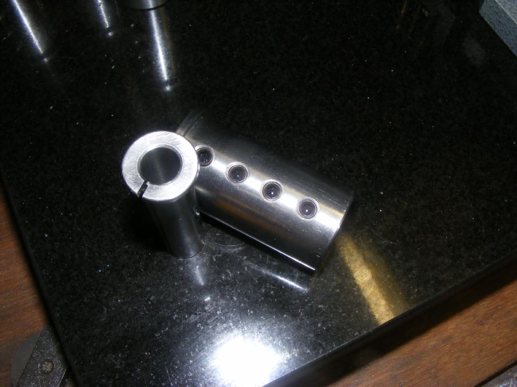

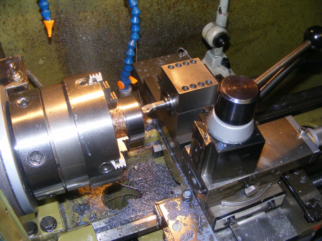

      0018.jpgDuring a recent thread concerning boring bars which included a discussion on methods of holding the bars. I am a firm believer in sleeving all bars. Solid sleeves for steel bars, and Split sleeves for Carbide bars. The reason for split sleeves for Carbide is that no screws are to bear directly on the Carbide because that really is a "no no ". This is a picture of my method of holding all me boring bars. The steel in shot is En 24t and is for thick washers for slitting saw arbors. All the sleeves are made from EN24t
      What are fellow members preferred method of holding their boring bars.0015.jpg0007.jpg0006.jpg

              I use sleeves like you Raymond, except for one boring bar made from square bar.

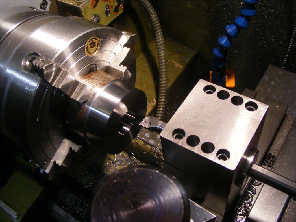

                    Hi Jason, The toolblock in the photo is En 19 and it is "split " Once the sleeve is in, the cap heads on top are tightened up that stops the sleeve from moving. It results in a very rigid set up. All is machined so every bar is at exact ctr height. I did think about making an index pin, but often its a good thing if you can slightly turn the bar [depends on the Material and the insert ] so decided against the locating pin. If I ever needed a tapered bore I have a toolholder for the QC toolpost that accepts the sleeves to allow me to use the top slide.
                    Chris, I will post a pic of the toolblock It is straight forward to make, Just make sure that the bore is a very precise fit to your sleeves { what ever size you decide to make them ] and it pays to have a very smooth surface finish on the bore of the tool block and the external / internal dia of the sleeves. Achieve those 2 critical areas and you will have a very rigid set up. Me biggest Carbide bar is 32mm and me biggest STEEL shank one is 40mm . I have the same set up for those {just bigger } The one in the pic accepts up to 25 mm dia.

                      Michael, The advantage is in "Rigidity " If your method keeps you happy then thats fine.
                      The toolblock and sleeve method is far, far, more rigid than any QC tool holders. and that is reflected in the surface finish. Prior to me toolblock, I used the normal method and, like you was very pleased.. Then it was pointed out to me about the toolblock /sleeve style and It is chalk and cheese.

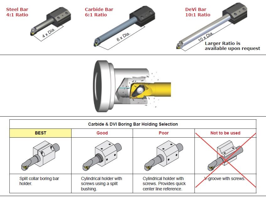

                              Hi Muzzer, On the basis that me brother [who is a foreman turner ] pointed it out to me, and I think he knows a bit more about it than me. smile p Re, the flats on Carbide bars,. I cant answer that, but Sandvik ,Walter,. Arno, et al, all say NO screws should bear directly on a "CARBIDE " bar and prior to knowing about that I broke a Carbide bar by having the screws directly on the bar [ broke right at the middle screw ] That was an expensive lesson that I have no intention of repeating. A lathe is no different from a milling machine in respect of Rigidity, the more the better. If you were to try the normal style over the sleeve / toolblock style then you would see the difference. [It would probably make no difference to what most of us make ] but the difference is apparent.

                                    The finish you see is typical of what I get now. Prior to the sleeve /toolblock style, I used the normal style and although rhe finish was nice it was nothing like what I get now. Even on EN3 [ which is usually a swine to get a great finish on ] the finish is much the same as in the pic. the correct insert also helps.
                                    HasBean, Normal steel shank bars can go out to around 3 x bar diameter. Carbide up to around 7 x because Carbide is more rigid [ there's that word again ] smile p

                                      That's funny. When I look at the brochure for the carbide shank boring bars I bought recently, the sleeves they sell for them have grub screws to hold the bar in place. Perhaps your brother should write to them to tell them where they are going wrong? When he's at it, he should also get in touch with Simtek who also don't seem to know what they are doing.
                                      If it really is necessary to avoid contact with the set screw, I would use a "packing piece". I often do this if I'm concerned about damaging the top of the tool. Much less palaver than making up a vast system of sleeves and holders?

                                        I am aware of at least one manufacturer that makes the following distinction on the set screw issue. The http://www.ultradexusa.com catalog offers, "Use the right set screw! Flat point, not cup point!"

                                          Muzzer, Try reading the post correctly ,it is Sandvik, Walter, Arno, ect that recommend that no screws should bear directly on the Carbide bar. Maybe once you break one, then you will understand why !! You stick with you're set up, I will certainly stick with mine. In fact, if you could bore a piece of EN3 with the "normal set up and stick up a pic I will do the same using a Toolblock This post was originally intended to see what other members use nothing else., and certainly not to get into the technicalities. And if you can find the time, check with messers Sandvik / Walter / Arno
