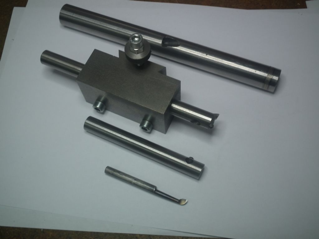

                          Russell Eberhardt
                            @russelleberhardt48058
                            No, I didn't make them. That was just a random picture to show the principle. Here are a few I have made:
                            The one at the front is for small holes. The next one has the hole for the toolbit at 90° for internal threading. The one in the homemade holder is for general use and the between centres version at the back has the hole at 40° to the axis and a 40 tpi screw behind the bit so that each turn of the screw increases the cutting radius by 16 thou.
                            Drilling the hole at an angle is no problem.  I set the bar up at the required angle in it's holder, made a flat with a slot drill in the chuck and then replaced the slot drill with centre drill followed by a just undersized drill.  Finish off with a reamer in the chuck if you have one, if not use the final size drill.
                            Russell.

                            Ian S C
                              @iansc
                              When making this type of boring bar, it's worth making it double ended, one end with the hole at right angles, and the other end at about 45*, you don't need to have a tool in each end all the time, but it is one less lump of metal taking up room in the lathe tool draw. Ian S C
