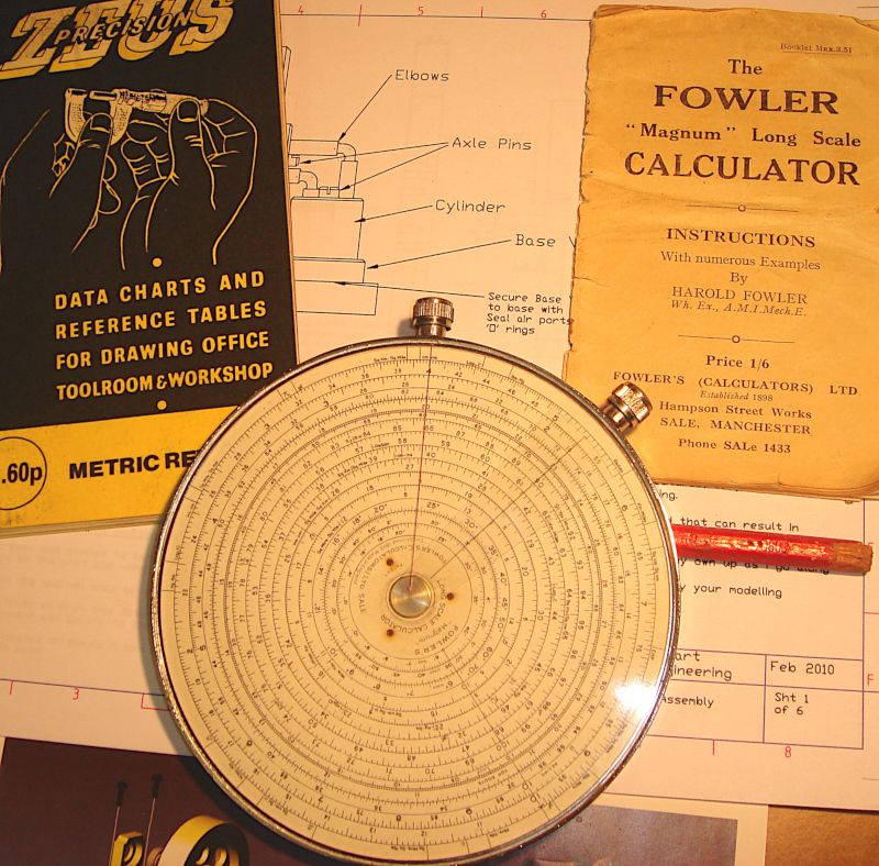

                                        Journeyman
                                          @journeyman
                                          As we appear to have drifted slightly off-topic. I used to use slide rules and still have a couple lying about in the darker reaches of the workshop. This is one of the less common variety, essentially a circular slide rule.
                                          Apparently the advantage is in the length of scale. The red line at 12 o'clock is on the glass cover the black line at 2 o'clock is on a transparent (celluloid) cursor. The dial and cursor are rotated by the two knobs. Can't remember ever having used it in anger.
                                          As far as bike pedals go, touch wood, mine have always stayed firmly screwed in!
