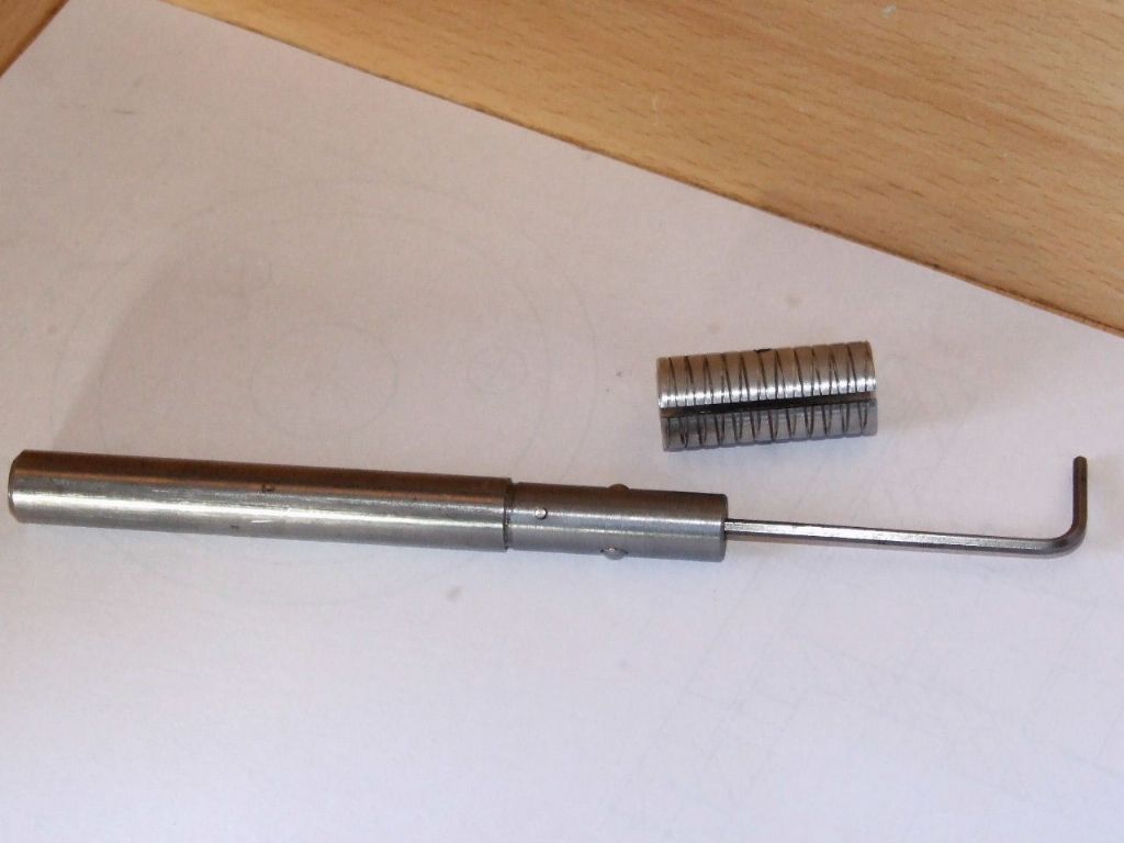

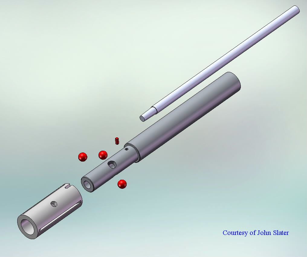

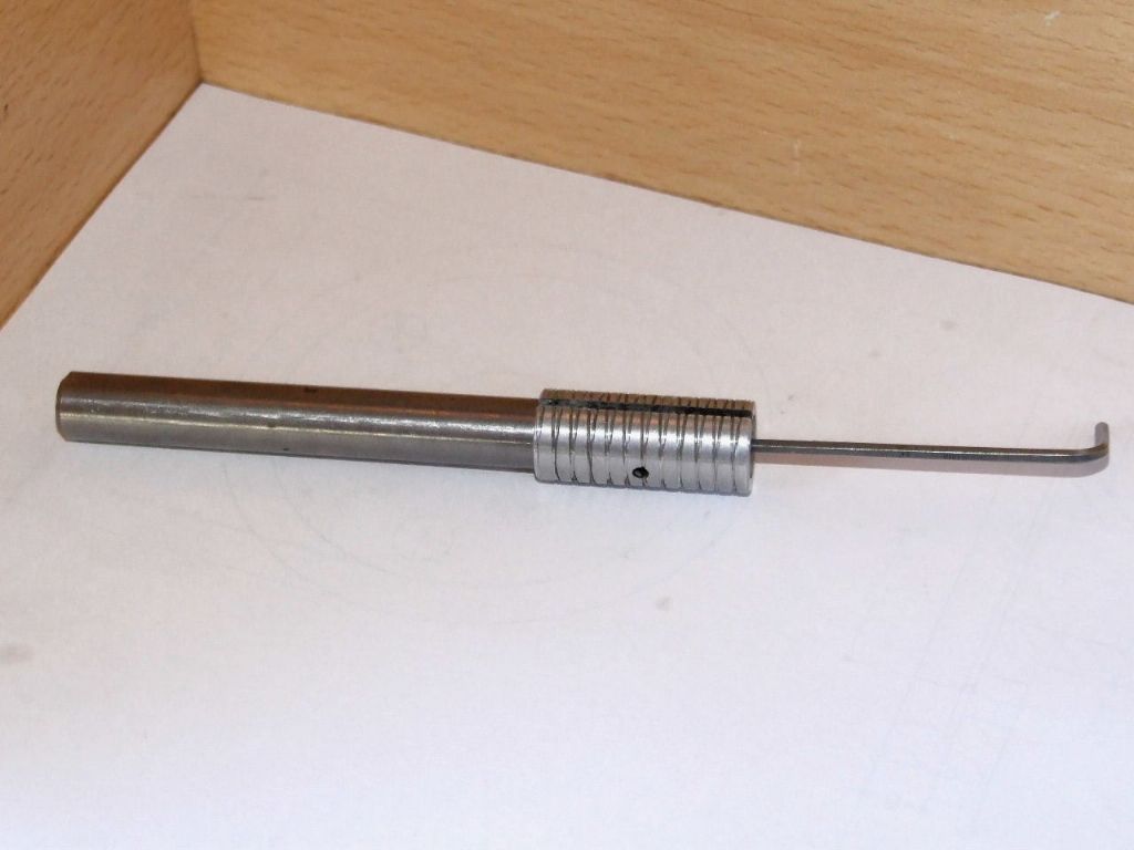

              This has been another project like my Lathe Tool Honing Machine that has been kicking around in my Journal for some while. This current project has been mulled over for about 12 months. It started with the lapping mandrel shown below.
              I wanted to remove about 0.025 mm, 0.001", from the bores of my steam wagon. The O-rings were just a little too snug a fit.
              A taper was turned on the end of an Allen grub screw such that one full turn advanced the balls 0.025 mm in total. Thus any fraction of a turn would give quite a precise control over how much cut was being applied.
              What is not shown in the photographs is the partial split on the other side of the lap. The two balls in this design make the lapping sleeve barrel shaped. A newer trial has shown that three balls and three partial slits in the sleeve gives a better "feel" when lapping a bore. This therefore will be the final design of lap that I will include in the above machine design.
              As the sleeves are interchangeable there is only need to make one mandrel per size range. The rest is taken care of by individual sleeves.

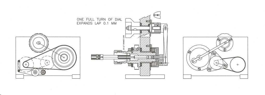

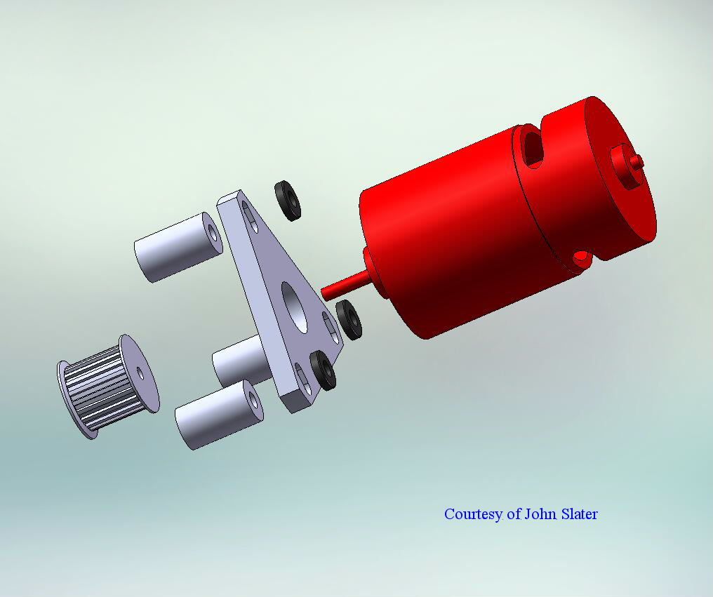

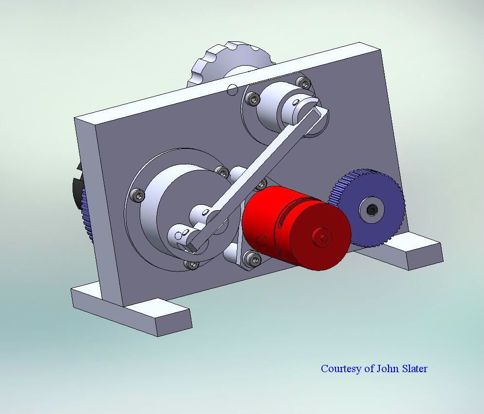

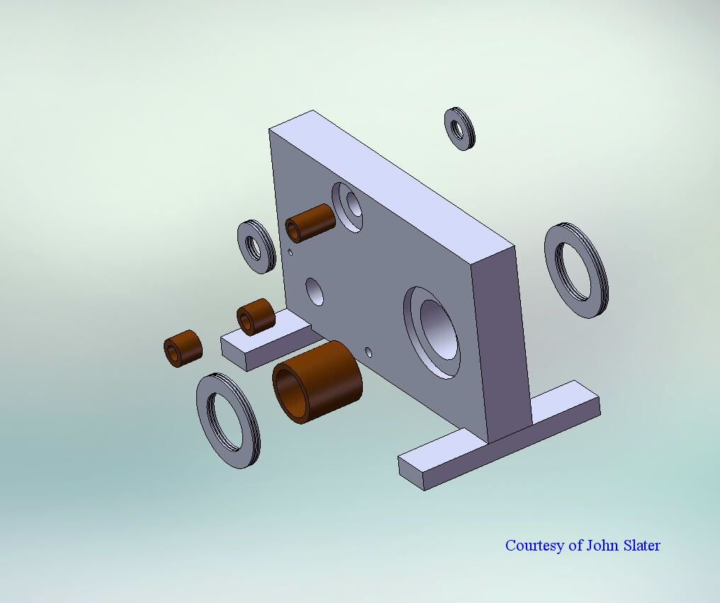

                          #522477
                          Graham Meek
                            @grahammeek88282

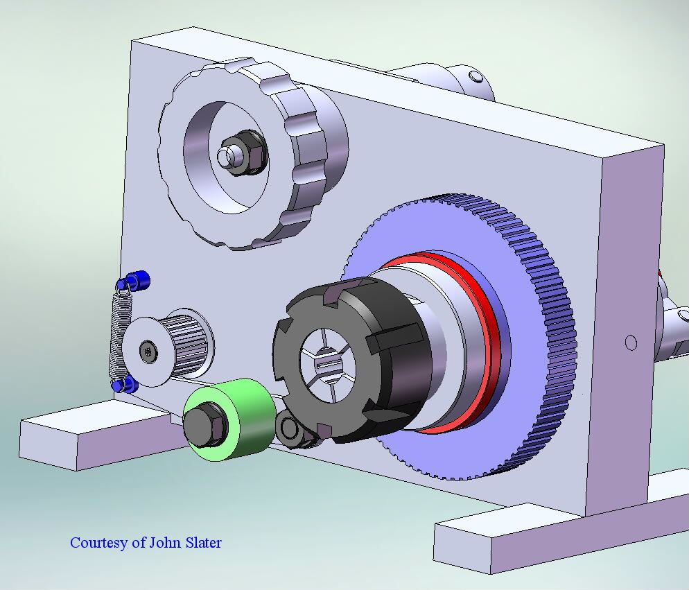

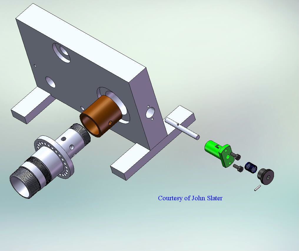

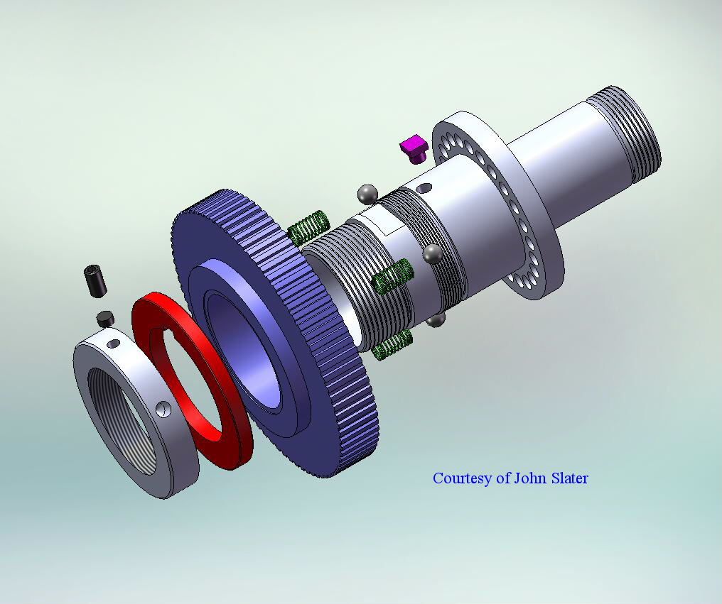

                            John Slater has been busy on my behalf converting my scribbles into something more realistic. We have left off the drive belts on purpose. The belts tend to hide some of the detail.
                            In due course we hope to share with you some 3D views of the Laps and Hones. I have yet to finalise the design on the hones so its down to me for holding things up.
                            Regards
                            Gray,

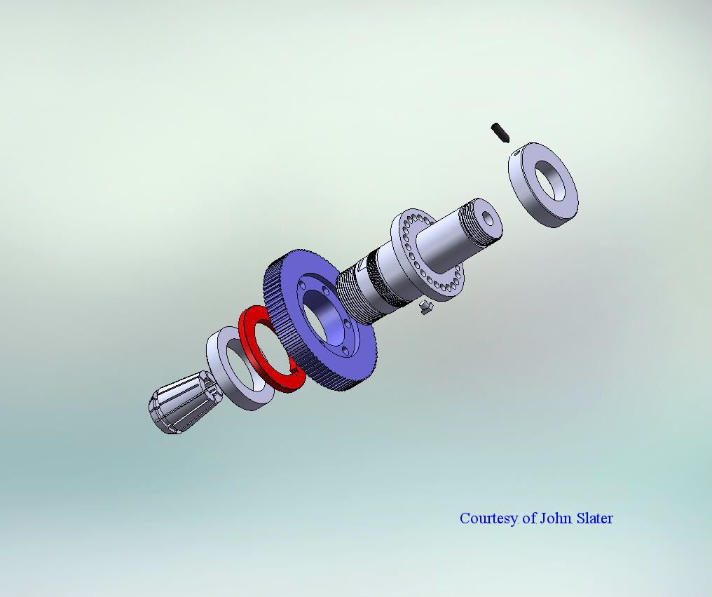

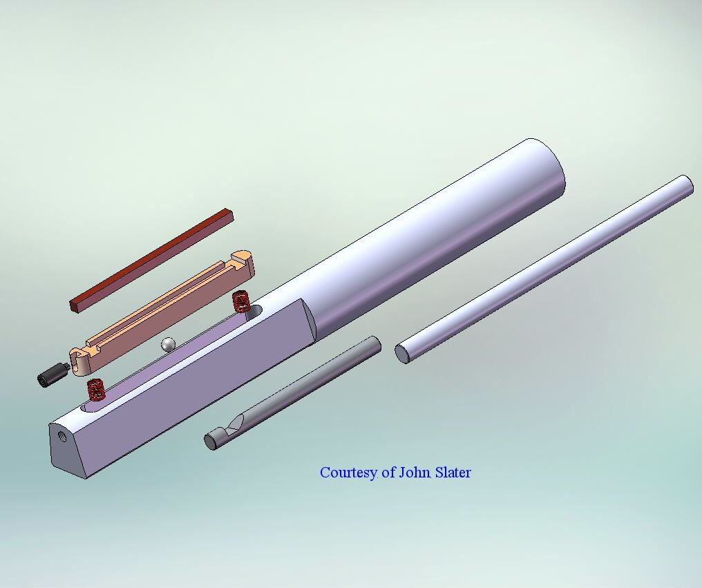

                                  Graham Meek
                                    @grahammeek88282
                                    John has completed the 3D views for this project. The first shows a more detailed view of the Adjustable spring loaded clutch.
                                    The second image shows the Hone assembly. The stone used in this version is 1.5 mm square and this particular design has a range of 9.5 to 11.2 mm diameter, 3/8" to 7/16" or there abouts. Each Mandrel uses the same design of stone holder. Individual stones could be made for each mandrel, or a few stones could be made and loaded into each mandrel as and when they are required. Currently the mandrels are designed to cover diameters up to 26 mm or about 1". Above this the design changes slightly and for me hones in this range of sizes would be made as and when they are needed.
                                    The smallest adjustable lap so far designed is 3mm or 1/8" diameter.
