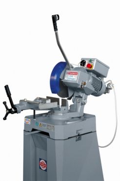

          Hi guys, I need an advise on a band saw…
          I was looking to buy a band saw for my workshop a while ago, but now as I started a new project, I definitely need one. The problem is that my knowledge in band saws is very limited and I don't want to waste my money for the band saw which wouldn't fulfill my needs. I need to cut quite few pieces of 70mm diameter stainless steel and 60mm diameter titanium bars. As we all know titanium is very hard material, and it's recommended to cut it with carbide blade, but on a tight budget I think I would get away with bi-metal blade (slow speed, small down pressure). The cuts have to be straight.
          What are the cheapest non automatic band saw options for the job?
          Any advice or opinion would be highly appreciated!

              There is another option and that is a pull down saw, I do not mean the abrasive cut off saws but the ones that can use a TCT blade like this
              I have a large 3 phase industrial band saw that takes 1.25" wide blade and I run a M42 blade, machine is 2 speed and has coolant pump which although it is well adjusted in terms of the guides etc it does not cut 100% square close very close but not 100%.
