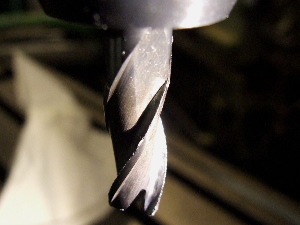

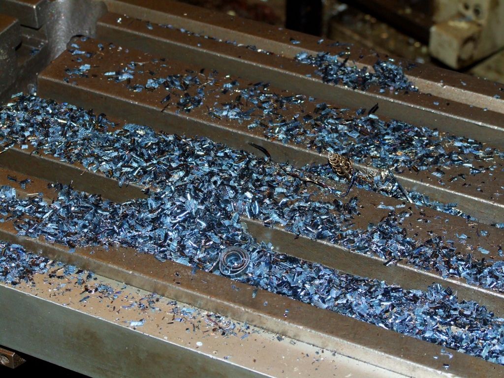

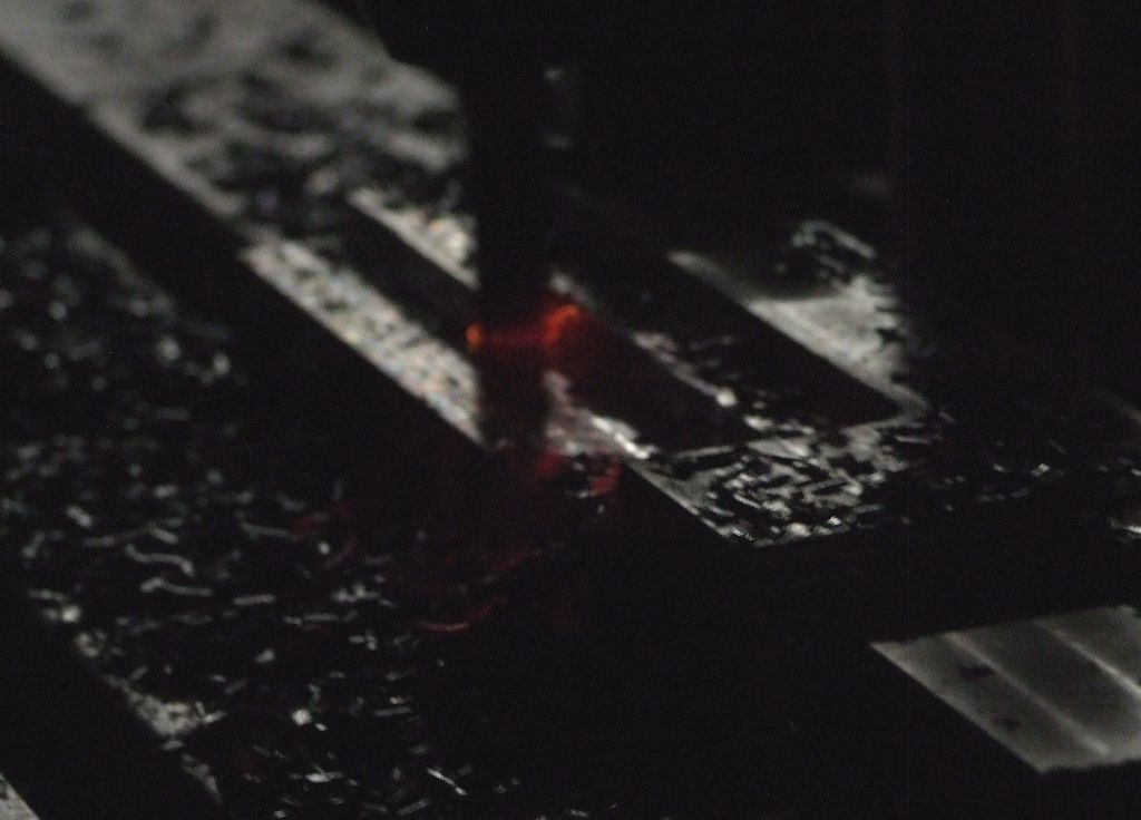

      This is what you get when you push hard; cutter glowing dull red and the swarf is bright red:
      Old, and blunt, Garr 10mm uncoated 3-flute carbide cutter at 2000rpm, DOC 5mm, WOC 8mm and hand feed about 300mm/min. Material is hot rolled steel. In daylight the swarf on the table is dark blue/purple and smoking.
      The cut was in the climb milling direction, relatively easy to wind the handle. Whereas with the same parameters conventional milling I could barely move the handle. Hooray for climb milling!
      Before anybody says, yes I know it's a Bridgeport, but it's old and only has a 1.5hp motor, so equivalent to many mid size hobby mills.
      So which one are you? smile

                Is there a benefit from having a cutter glowing?
                Alan
                #365920
                David Standing 1
                  @davidstanding1
                  Posted by AJW on 06/08/2018 17:32:02:
                  Alan
                  Saves on the workshop lighting bill when milling after dark, lights off! wink
                            Alan
                            Yes, when speed matters more than cutter life. The heat softens the metal, making it even easier to remove quickly, a dubious advantage in my genteel cowardly workshop.
                            There's an economic trade-off between cutter life and metal removal rate. Time is money. I'm a hobbyist who prefers to maximise the working life of my equipment. Production is a different game and they tend to drive machines and cutters close to maximum, optimising power consumption, finish, & removal rate rather than cutter life. They're much more prepared to wear out cutters in short order when it pays to do so.
                            Running red hot destroys HSS – it can't take the heat.
                            I'm not aware of any research into optimum amateur removal rates. I reckon I'm over-cautious. Couple of times I've been advised to up the ante, and it worked. 'Don't pussyfoot' and 'Increase the feed-rate'.
                              Alan
                              Time saving. thumbs up
                              Carbide cutters retain their hardness at high temperature, the cutter in question is worn anyway, and I get bored waiting for slow cuts to finish. I'm not really interesting in machining, unless it's a new technique, but in using the finished part.
                              Andrew

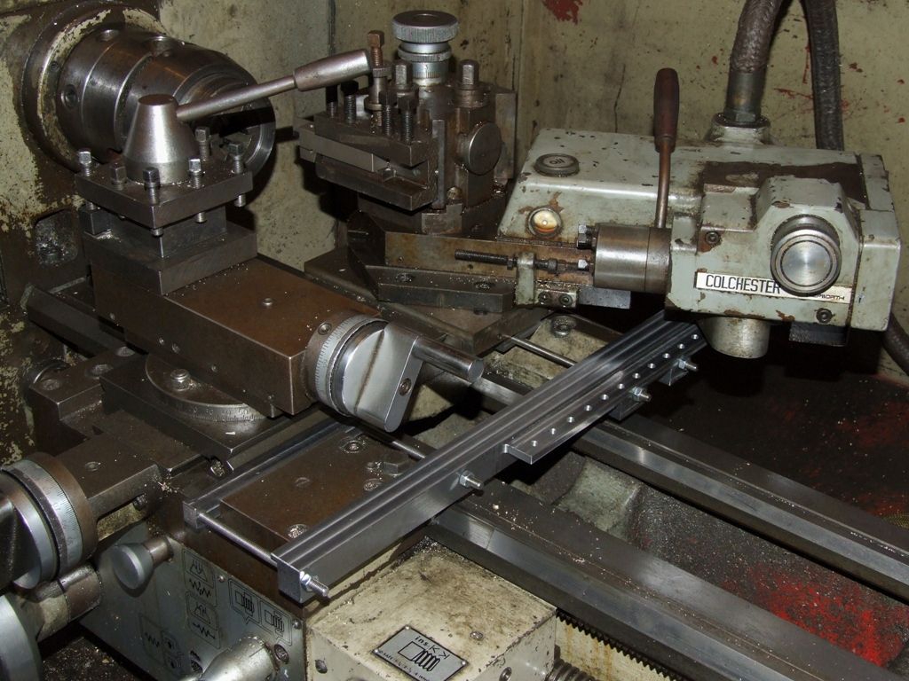

                                        Posted by JasonB on 06/08/2018 17:55:38:
                                        Andrew, is there any chance of a photo of the finished surface as you seem to be keeping us in the dark on that one. No need to get the surface comparitor out.
                                        Would a sharp cutter have got so hot?
                                        I suspect that a sharp cutter would have run slightly cooler, but the swarf would still be red hot. Here's the part, about 20" in length:
                                        I did get the surface roughness meter out, but I can say that the finish on all surfaces is smooth to the touch with no tearing, which can be a problem with hot rolled steel. The final finish isn't necessarily indicative of the roughing cuts. To finish the rebates I took a climb milling pass at full depth, 15mm, and up to 1mm width.Here's the swarf, nice 'n' blue:
                                        And here's the bar in situ on the lathe, in preparation for using the hydraulic copy unit for face profiling:
                                        Andrew

                                            #366040
                                            Anonymous
                                              Posted by JasonB on 07/08/2018 07:05:28:
                                              Warning not for the faint hearted unless you like the sound of a mouse squealing in a trap!
                                              Good grief that's noisy! The machine that is not the cutting. Clearly plenty of vibration but the mouse must have escaped? I had a little vibration, the knee handle swung free, but no chatter or squealing. The non-cutting axes were not locked.
                                              The surface roughness measurements I got were as follows. On the vertical surface within the rebate 5µm Ra. Not surprising really as the cutter flutes are fudged:
                                              On the bottom surface of the rebate I got 3µm Ra. On the top surface of the block,where I took ~1mm DOC and 8mm WOC surfacing cuts to get rid of the mill scale, I got 2µm Ra.
                                              Andrew

                                                #366066
                                                Anonymous
                                                  It's a carbide cutter so can be run pretty hot. To be fair it doesn't look red in normal lighting. If you run HSS at that sort of temperature you'll fudge it pretty quickly. Some of the more esoteric coatings on carbide cutters need to be run hot for them to function properly. So running slow ''n' steady can actually decrease cutter life.
                                                  In terms of speeds, feeds, DOC and WOC it's a matter of experience. Clearly a benchtop mill isn't going to have the same capabilities as a 8000lb floor mounted mill. But as said earlier I suspect that many users of smaller machines don't run anywhere close to the limits. A rule of thumb is that 1hp will remove 1 cubic inch of material per minute in low carbon steel. So one could assume that the machine would be capable of achieving that. As an industrial machine the Bridgeport does achieve that. I don't know about minimills, although JasonB pushes his mill fairly hard. If the mill isn't capable of utilising the available spindle power then it's a bit of a fundamental design flaw.
                                                  Horses for courses really.
                                                  Andrew
