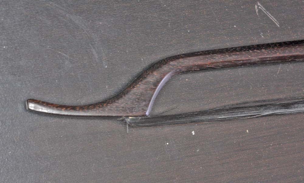

              I've been away from the internet in Mull for the last week or so and have come late to the discussion. I've made a few "historical " bows in the past to go with the Viols and Baroque style violins and violas that I had a go at making. These bows were rather less sophisticated than the modern Tourte bow with a simpler frog and a positive camber caused by the hair tension which, in the case of the viol bows, is adjusted while playing using the fingers in an underhand grip. Although Snakewood seemed to be the go to wood for earlier bows I could never justify the expense – this bow was made from Partridgewood.
              I used to buy my tonewood from Maurice Bouette at the Newark school. I never met him but used to receive charming hand written letters discussing my requirements. Some years (decades really!) ago I was buying some supplies at Timberline. They reckoned that many modern bows were made from Beefwood (Mimusops Huberi) and sold me two baulks of the stuff for a very reasonable price compared with Pernambuco. It's a bit denser than Pernambuco and a bit darker but produces a nice shiny finish with wet'n'dry.
              Nice to have you aboard,
              Rod

                  Posted by Roderick Jenkins on 15/07/2019 15:56:33:
                  Hi Mike,
                  Rod
                  Rod you have your beef and bullets mixed up, Your refering to Bulletwood also collectively known as abeille ,manilkara or massaranduba.smiley

                      I drilled the hole for the screw on my bows by poking the stick down the headstock and rotating it held in a self-centering 4 jaw chuck. However, my bows didn't have a camber. At what stage do you bend your sticks?
                      Mark,
                      I see that Mimusops seems to more generally known by the name of Manikara these days. It was definitely sold to me as Beefwood and I see that one of the common names for the Manikara Huberi is the Cow Tree so it would not seem unreasonable that it produces Beefwood – such is the timber trade. You can only really go by the botanical name if you want to accurately know what you are buying – even if they do keep changing those angry
                      Cheers,
                      Rod

                        Posted by Roderick Jenkins on 15/07/2019 22:11:30:
                        Mike,
                        Mark,
                        Cheers,
                        Rod
                        Beefwood is an Australian timber a bit like lacewood. Probably the person Robert Smith at timberline ?? -was confused as well.
                        It (Manilkara) is known as Abeille as i mentioned above ,its french word for bee and often known as bee-wood as well in English. There was 100`s of thousand ,if not millions , of bows made from the stuff of varying qualities.
                        Another interesting thing is that the latex rubber from these trees was used in golf balls. Called `Gutta Balata` (Balata being another name for this wood.)
