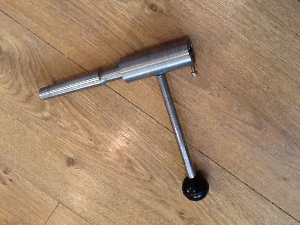

              Well finished my tail stock die holder. My father in law came to the rescue. He brought down a cheap set of 'Workzone' taps and dies. I think they are Aldi's make. They worked a treat.
              Tail stock die holder

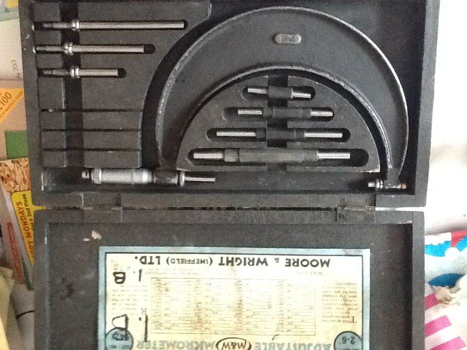

              Not only that but he got me these two items from a car boot sale
              moore and wright 2-6 micrometer
              Micrometer

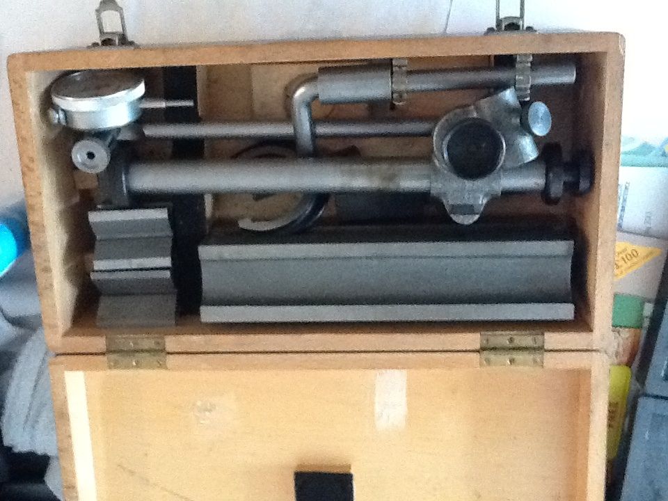

              and a Mercer comparator
              not a bad day after all
