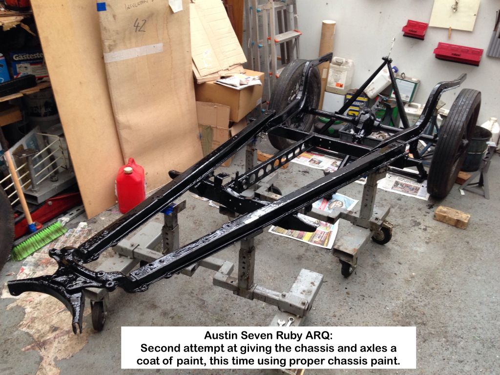

If you zoom into the photo, to the NS chassis leg above the front CT (CarTrolley) upright, you will see an unpainted section.
This has the chassis number stamped on. Austin originally riveted chassis number plates onto the OS rail, but changed to punching the numbers on around the time my car was constructed.
However, when I stripped the chassis to bare metal I was somewhat taken aback to see what appeared to be an outline of a chassis plate impression in the steel.
Ah, unless of course it was from the punch that made the rivet holes. Just thought of that

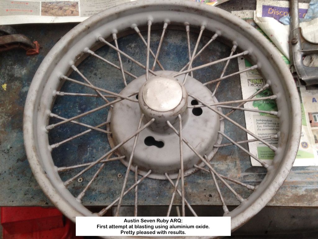

I found the best paint stripper I've ever used full stop.
Biostrip
Water based BUT it works an absolute treat, with no nasty smell. The usual disclaimer but I've recommended it enough times now I think I should throw them a hint as I need some more.
Most strippers have been so diluted by EU Regs as to make them useless now.
I gave the bare metal a wipe over with GibbsBrand but where there was any rust, a spray of phosphoric acid.
Another method of protecting bare metal is to use Agfa CopyRapid, a water based clear coat used in the printing industry to stop aluminium plates oxidising.
