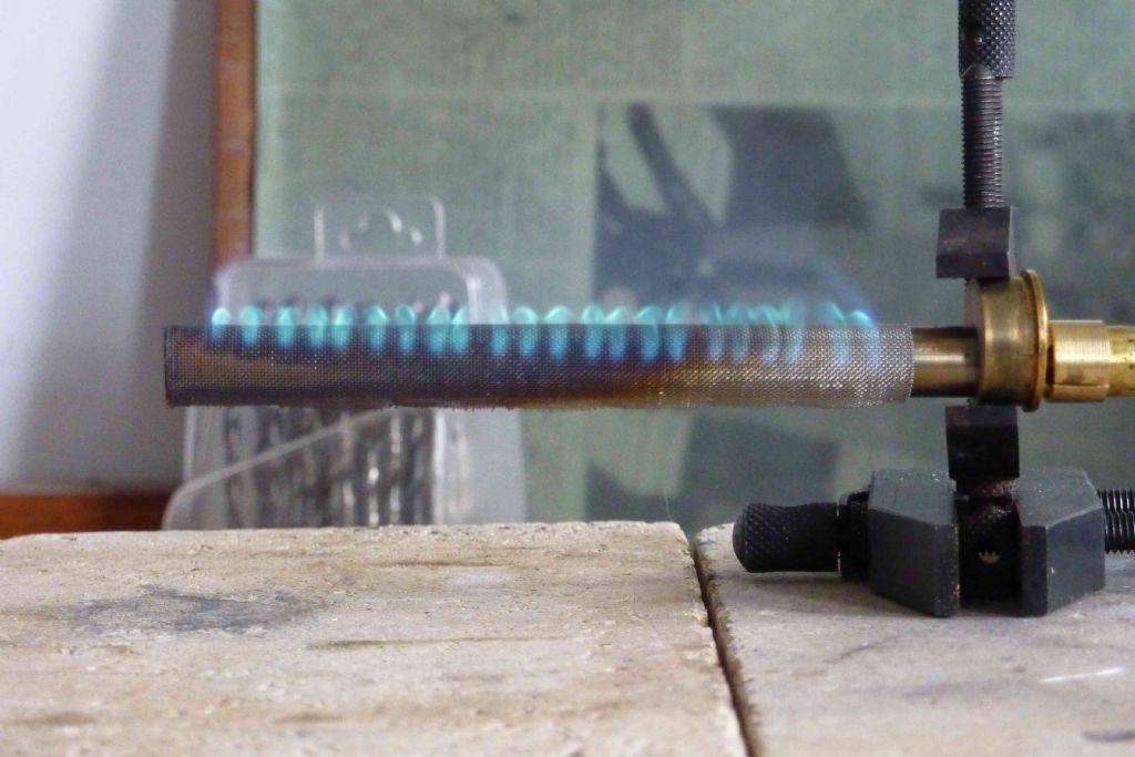

    The radiant burner is formed by wrapping two separate layers of stainless steel mesh around the poker burner tube. I obtained some pieces of stainless steel mesh and chose a #60 mesh. I think this refers to the number of openings per inch. The first layer was wrapped around the firetube and held in place with 0.2 mm stainless wire. I think this layer is intended to act as a sort of diffuser and this is a photo of the flame.

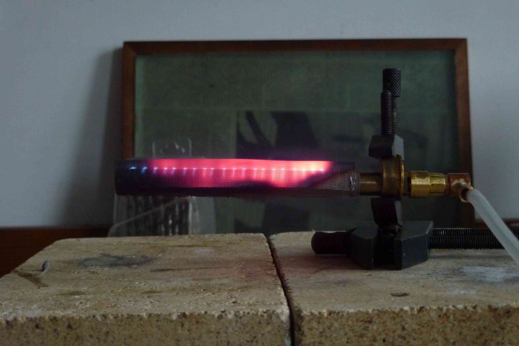

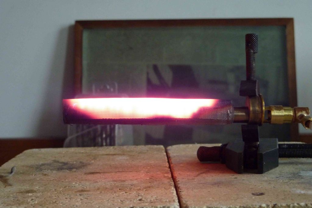

    The next step is to attach a second layer of mesh, but in a loop above the burner so that there is a space of 3 or 4 mm above the first layer. This proved to be quite difficult, but I eventually managed it with lengths of stainless wire holding it in place. The result of lighting the gas is quite startling. The gas starts to burn with a blue flame as before, but then quite suddenly the gauze glows red and you have a radiant heater. This is what it looks like.
    This was with a No. 5 jet. As you can see it is glowing brightly – too brightly. So I put in a No. 3 jet and this is the result.
    I think this would be more acceptable. It is not so intense a glow and is probably using less gas. However, these images are for burns in the open. When placed in a fire tube the results were not so encouraging. With the No. 5 jet the whole poker tube started to glow red. As it is only thin-wall brass I quickly turned it off. With the No. 3 jet the results were a little inconclusive. Certainly the poker tube did not glow red, but neither did the gauze. I suspect the problem lies with the limited diameter of the firetube. Perhaps Gauge 1 Astors have a larger diameter firetube. So not entirely successful, but I had noted that there was far greater control of the flame with the single layer of mesh than without it, so I decided to use this in the boiler. The results were excellent. It was far easier to light the gas in the first place, and there was a greater degree of control with the gas regulator valve, from a low flame to a high flame. Working pressure was reached in about 4-5 mins, and there was no loss of pressure when the throttle was opened. This was with the No. 5 jet.
    So I haven’t managed to produce a proper working radiant heater, but I have managed to improve the control of the burner by wrapping one layer of ss mesh around the burner. The Southern Steam Train writer produced a number of different burners with one and two pokers per burner and achieved greatly improved gas duration. Some more research is obviously required for the smaller diameter firetubes.
