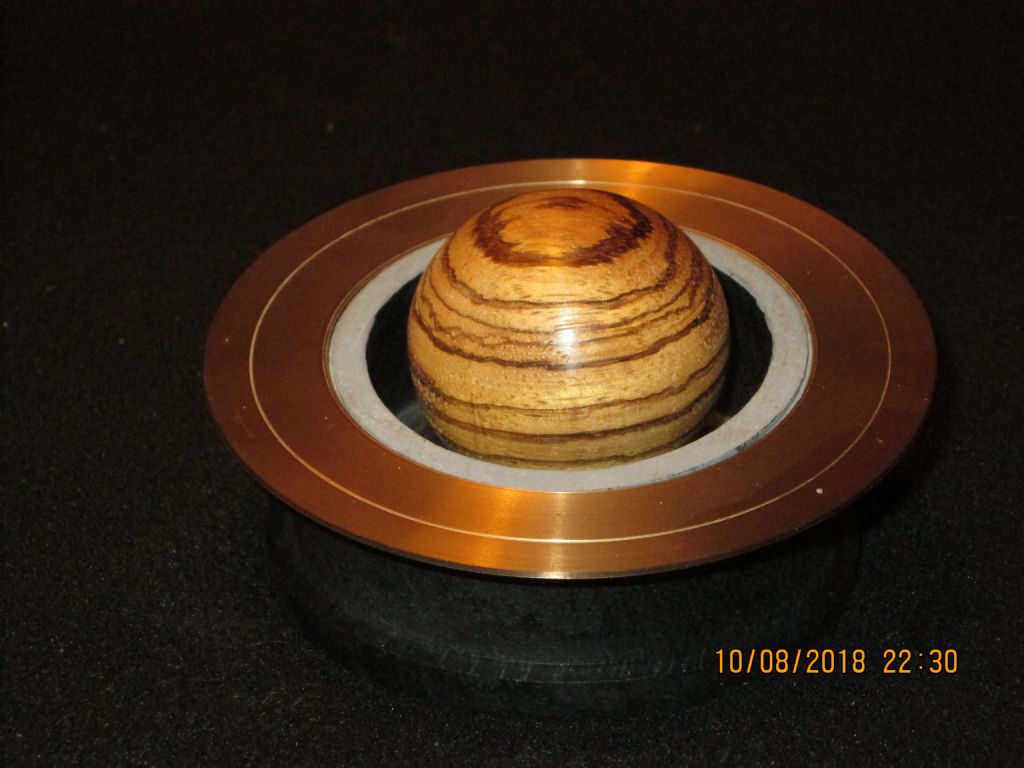

              Mick B1
                @mickb1
                Posted by Ian S C on 24/10/2018 12:43:32:
                For turning wooden balls, get a bit of steel tube and make sure the cutting end is square and sharpen it like a leather punch with the taper on the outside…
                …just don't use soft new Radiata Pine, you'll have a real hard job even on a wood lathe with the sharpest tools.
                Ian S C
                That looks like a pretty good way to do it – do you mean feed the tube-tool in square to the axis, from the side?
                I managed *sort of * OK with my hand-gouge on Zebrano for Saturn:-
                But sticking a caliper across it a few ways will expose its out-of-roundness pretty mercilessly… surprise

                              Posted by Mick B1 on 24/10/2018 13:32:07:
                              Don't worry, Saturn is out of round itself by a ratio of about 9:1
                              #377455
                              Mick B1
                                @mickb1
                                Posted by Neil Wyatt on 24/10/2018 16:58:05:
                                …but not in the plane mine is… blushlaugh

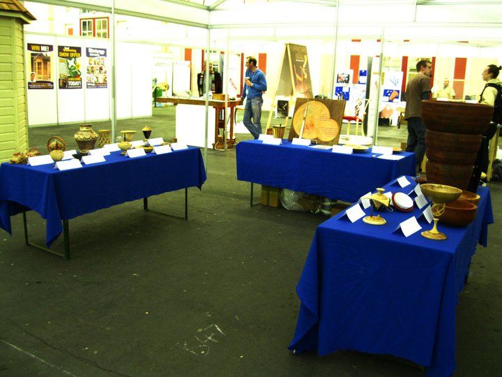

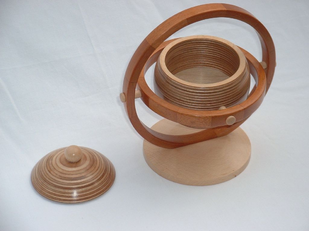

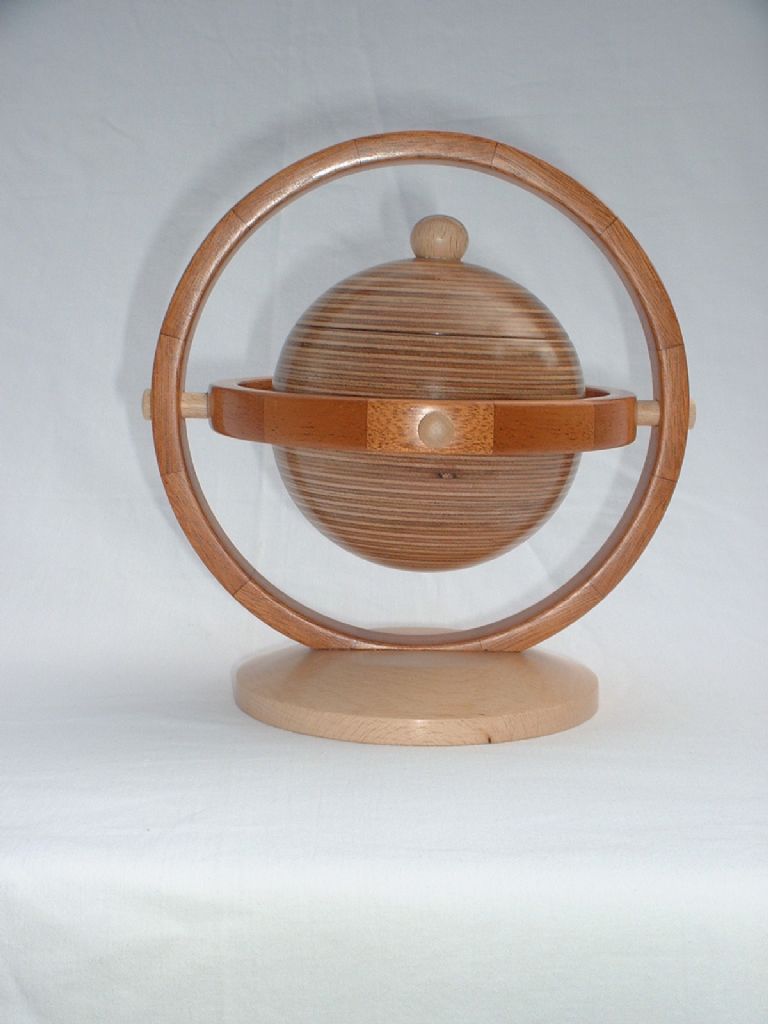

                                    With tools held in a metal lathe the finish is not always too good as hand held woodturning tools you rub the bevel before cutting the wood so in effect are planing the wood. Ball are easy to do by hand if only doing small quantities as some of the jigs can be expensive.
                                    This was done free hand and is near as possible a perfect sphere it did require the sharpening of the tool quite a bit as ply knocks off the edge very quick. The sphere is 4" diameter.
                                    This came third in the last woodworking show at Alexander palace some years ago

                                        Derek Lane 2:
                                        It is a long time since I visited the Woodworker exhibition at the Palace but I am sure I should have remembered your piece if I had had the pleasure of seeing it in the wood.
                                        Hollowing the sphere and managing the lid must have taken some planning!

                                          Posted by ega on 24/10/2018 21:43:36:
                                          Derek Lane 2:
                                          The hollowing was done first.
                                          This was the table for the last one and also the winners table

                                          #377584
                                          ega
                                            @ega
                                            Derek Lane 2:
                                            Looking at your second photo, were you third equal?
                                            I very much like those plates.

                                                #377616
                                                Dalboy
                                                  @dalboy
                                                  Posted by ega on 25/10/2018 11:58:46:
                                                  Derek Lane 2:
                                                  Two different classes one for those that had entered competitions before and the other for first time of showing mine was the second class
