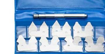

      As an aside, I wondered what differences there might be between the Starrett gauge and the ArcEuro offerings.
      This ArcEuro example is a tidied up stamping I think […]
      May I suggest that you look at the ARC product which Jason linked on the other thread

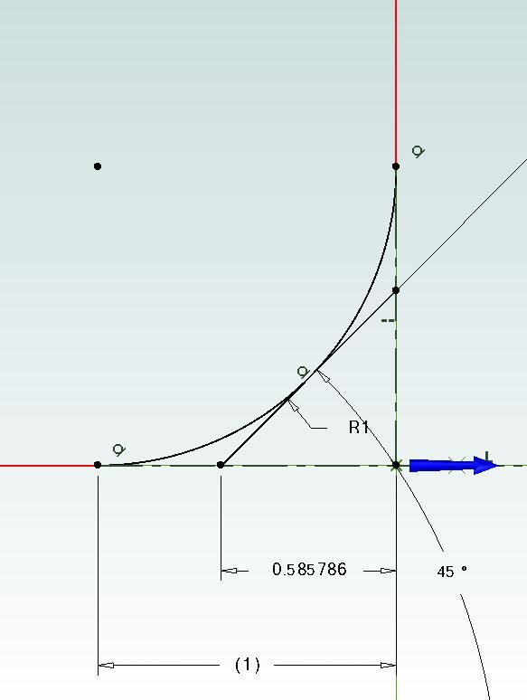

                        While we are here, can anyone tell me how to convert a 45° chamfer measurement into a fillet arc (albeit one that assumes a 90° circular arc), in mm units if that's important?
                        I've been trying to work out if the geometry and whether there is a simple number I need to multiply the chamfer measurements by, or whether it's more complacted that that.

                            Multiply the reading on the calliper by 1.7070789 and you will be quite close to your radius, better if you have more characters on your calculator display.
                            This will work with both metric or imperial readings

                              Yes, I did a digital sketch and multiplying by "1.7070789" does work (to within the accuracy of my drawing).
                              Out of interest, what is the equation for it? Where did it come from?
                              #578716
                                I just drew it out in CAD. First did the 1mm radius and then a line tangent to that at 45 degrees and took the 0.586 dimension from that. It is then just the reciprical of that (1/0.586) to get the multiplier of 1.707

                                        Just to let you folks know that I have – albeit through gritted teeth – finally bought that set of Imperial radius gauges from ARC, because sourcing individual Starretts that could be delivered in a half-reasonable period of time proved to be impossible, here in the UK.
                                        Meanwhile, in slow time, I shall see if I can find a metric set of those Starretts on eBay. Yes, there are a number out there, but they always seem to be coming from the US which then of course incurs hidden time & fincancial penalties…
