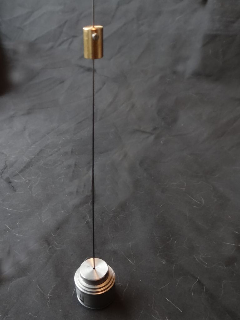

      I also tried making one of these, a moveable brass weight on a length of piano wire with a solid base, it's an upside down pendulum:
      The idea is to put the thing on a running machine and then tune the brass bob for maximum wobble. At max wobble the pendulum should be resonant with one of the lathe vibrations, and the frequency can be calculated with the pendulum equation. So far I can't get it to work! It might be that the piano wire is loose in the base.
