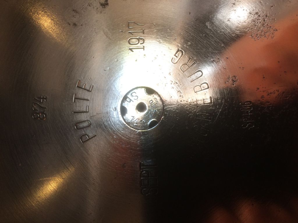

                            An update on the thread **LINK**
                            Have now cleaned up the two WW1 150mm German Howitzer cartridges and mounted them to make a couple of gongs. The 'hammer heads' were made from a semi hard ball from a toy shop covered in wet chamois leather. I now have to decide which auction site would be best for selling them.

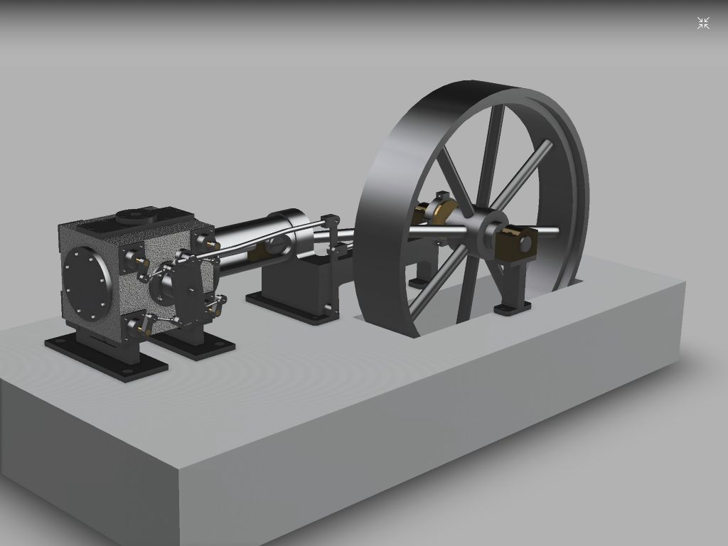

                                            Well, yesterday, really. But I had some difficulty uploading a screenshot to my album…
                                            I have a desirement to build a Corliss engine, so I have modelled it up in CAD. This found the two missing dimensions before metal is cut. Doing the CAD model first also allows me to see how it all goes together, where the significant dimensions are and, especially for the Corliss, animate it to see how the valve gear works. The drawings that I have taken this engine from are actually very good, but I have found that some drawings are so poor (or just plain wrong) that they will never work. I have taken to making a CAD model of most things before I start, now.
                                            Next step: try to accumulate bits of metal without SWMBO noticing!

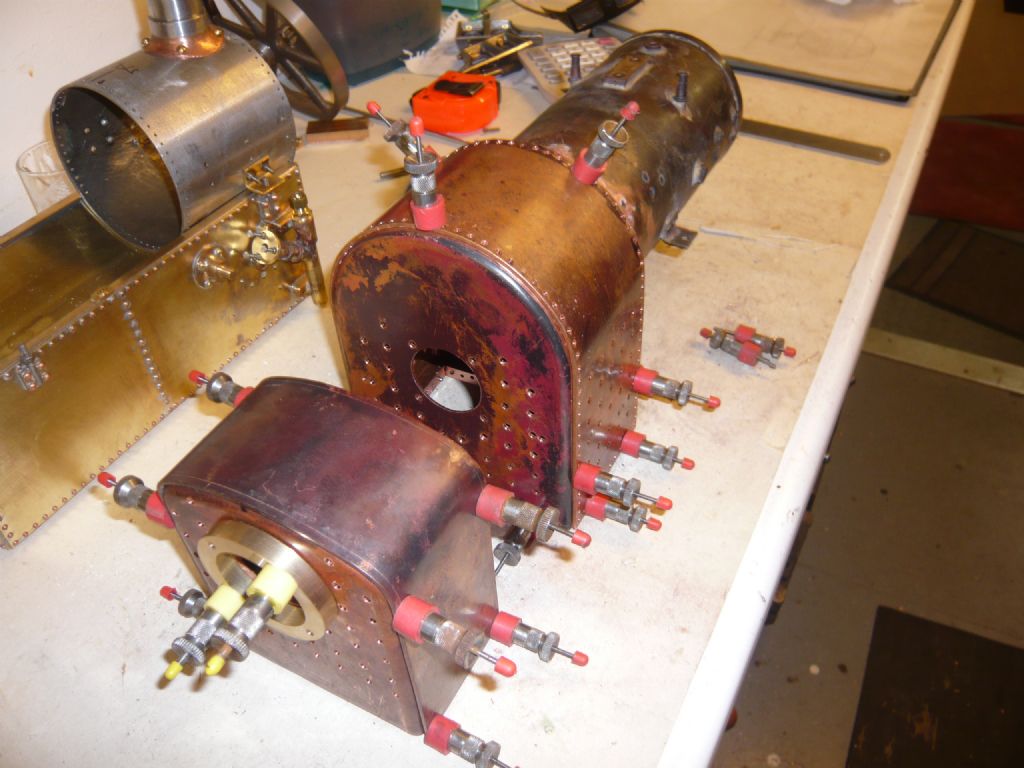

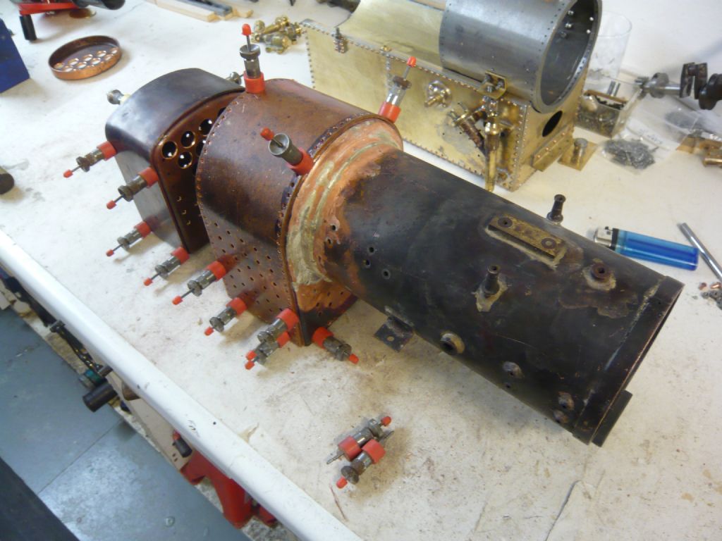

                                                    I've been cracking on with the boiler for my Burrell-Boydell road loco.
                                                    Boiler Assy 1
                                                    Boiler Assy 2
                                                    The things holding it all together are called skin pins and are used in the aircraft industry for fastening sheet components together for drilling and riveting. The red ones are 3/32" and the yellow ones are 1/8". They are not expensive and are much less fiddly that BA screws etc.
                                                    The boiler barrell is 3 3/4" in diameter
