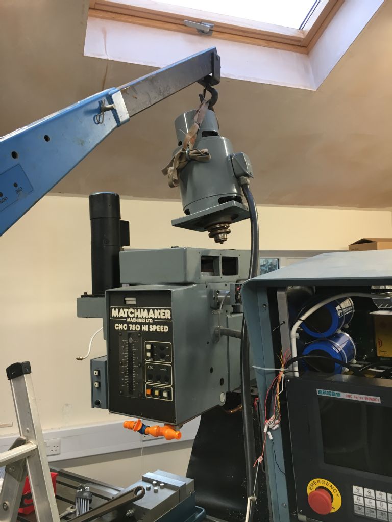

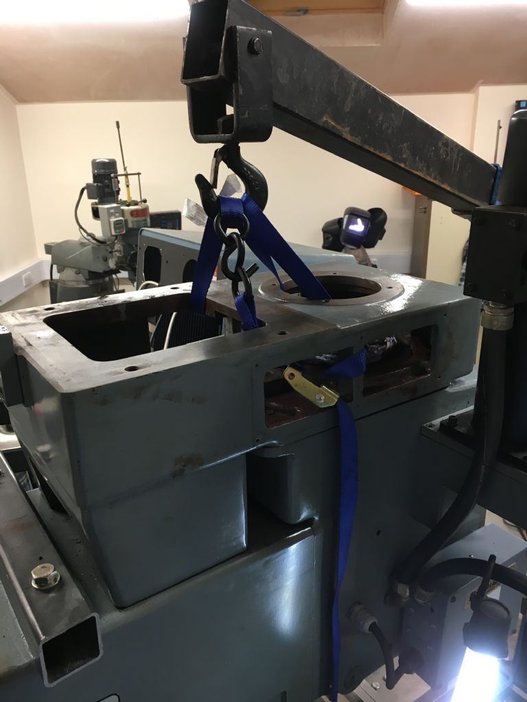

      I finally got irked enough by the strange graunchy noise coming from the spindle of my CNC machine to actually do something about it. It's clearly not coming from the actual spindle bearings themselves, yet doesn't sound like the sort of noise motor bearings could make either. Have a listen here. The only way to fix it is to remove the motor and belt housing to have a closer look. There are other benefits to doing so: the belt looks as if it's not long for this world, the back gear assembly is one area I haven't overhauled and I would like to fit a shaft encoder to the spindle so that I can do rigid tapping at some point. Finally, there will come a point soon when I will need to extract the machine from the workshop through the roller doors that are only 7' high. This will require me to remove the motor / drawbar / belt housing etc, so it would be sensible to have a dry run up front. The workshop was built around the machine, so getting it in wasn't a problem.
      The main issue is that the motor is big and heavy (50kg?) and is over 2m from ground level. And the belt housing isn't a lot smaller or lighter, being a large cast iron jobby.
      Managed to extend the boom of the engine crane sufficiently to reach above the motor and bring it down in a controlled(!) fashion. Ditto the housing. No death, hospital visits or changes of underwear were required.
      Motor out
      Belt housing out

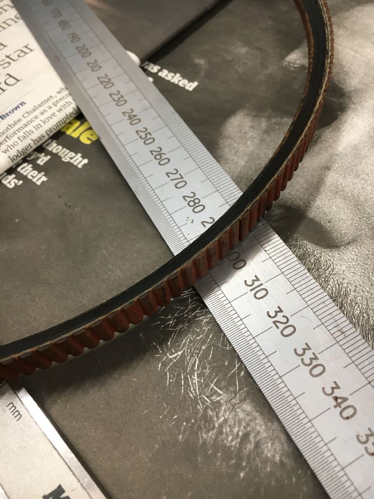

      It's now clear that the funny noise was due to the perished belt which is hard and shiny in places. But what surprises me is that it has 60 degree faces on the vees. It measures about 11mm across the top of the vees. Has anyone seen 60 degree vee belts before? It's a new one on me. Having said that, the motor and spindle pulleys are clearly worn in places, so I may as well remachine them to a 60 degree profile.
      Weird 60 degree pulley
      60 degree belt
      The next step is to remove a couple of kg of heavy grease from the gear chamber, then degrease everything, check bearings, regrease and reassemble. Before regreasing, i will fit a couple of proximity sensors next to the main spindle gear. By placing these apart by 1/4 of the pitch of a tooth I should get a quadrature signal that indicates spindle direction as well as speed.

          Nah, it's not the worn belt. It's the cigarette card held against it with a clothes peg that's making the noise. cheeky
          As to the belt angle, might be better to get the new belt before re-turning the sheaves, If you end up with a 40°, it'd be upsetting if you'd just turned the sheaves to match a 60° belt. ( when turning them, don't forget that the sheave angle is less than that of the belt, dependant on the pulley diameter)

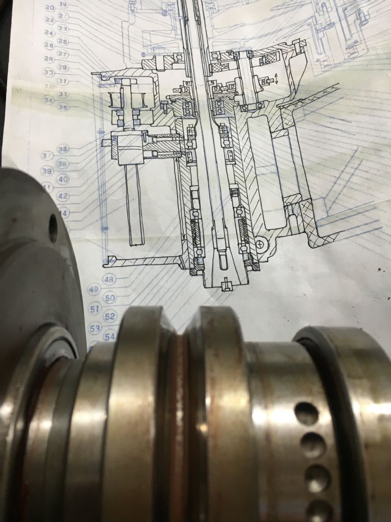

            Sorry, that was a senior moment. I was planning to remachine it at 40 degrees, not 60! I've ordered a SPZ772 belt from beltingonline.com which should arrive before I've remachined the motor and spindle pulleys.
            Managed to remove the motor pulley. The spindle assembly bearings pulled off easily enough but the gear and pulley seem to be pressed together. I've had to mount the assembly in the 4 jaw and although the gear end won't fit inside the body of the chuck, the stick out is fairly limited. The question is whether it's hardened or not ie can I use a simple HSS form tool or do I need to use carbide.
            I looked closely at the shiny tops of the gear teeth, thinking this indicated where there was no wear. In fact, the shiny bits are ground, to take the bearing (which I have removed. The matt finish bits are a slightly smaller diameter. The gear is pressed into the pulley body, also contacting the shiny bits. There is a key and keyway in there too, to take the load.

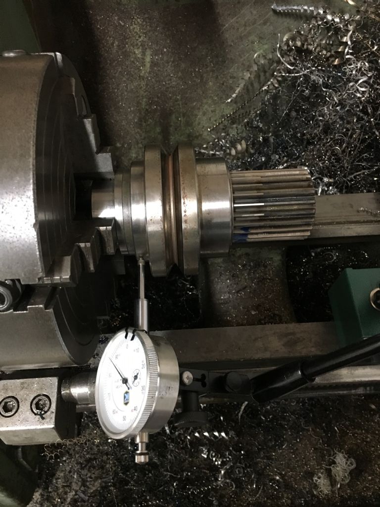

                  I looked closely at the shiny tops of the gear teeth, thinking this indicated where there was no wear. In fact, the shiny bits are ground. Murray
                  Not sure if you were also asking an open question to readers?.
                  To me, if it has been 'Ground' very close to the pulley 'V', then I would expect it to be hardened.
                  To confirm it, I would use a medium cut file to test the deflection from the surface in the 'V'. If the file stroke just slides over the surface and only polishes it, then it's also a hardened areal, so a TC Bit req'd, or grinding.
                  Lastly, if the stub shaft has been 'Centred' at the splined end, It would benefit from support with a Live Centre.
                  No 'egg sucking tuition' intended.

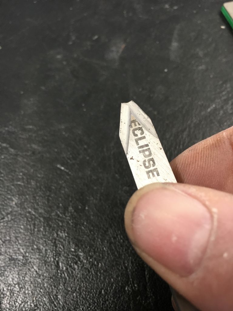

                    No problem – as you guessed, the splined core is hardened but luckily the actual (outer) pulley is not. So I was able to make up a 40 degree form tool from a 1/2" HSS blank and set to. I ground the tool to give a large top rake by grinding a groove in the top surface and then honed it with a diamond tool.
                    The result was pretty good – lots of very fine "bum fluff" swarf during finishing but also some half decent swarf during the roughing part.
                    So job done – and even as we speak, the belt has been dispatched 1st class. However, before I get to reassemble everything I have a mass of old grease to scrape, wipe and degrease from the reduction gear mechanism. That'll take a while….

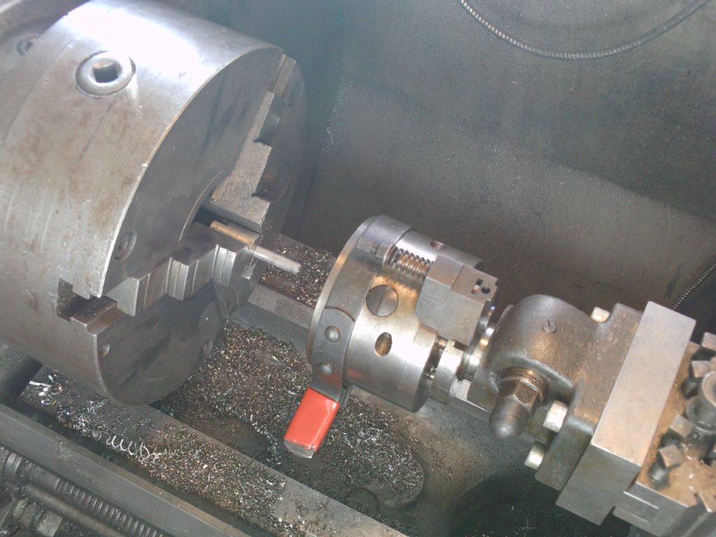

                          Today I shortened 200 M8 bolts and used a Coventry die head to put a 5/16" BSF thread on the remaining plain part of the bolt.
                          This got me thinking, is a die head an obsolete piece of workshop equipment? Obsolete as is a shaper or planer in industry but never the less still useful for the model engineer. A local engineering business very occasionally borrows mine, having not replaced their worn out head some 30 years ago. They much prefer to use a throw away tip tools running at normal turning speeds for threading. last time they used my die head was to cut M10 threads on a part using the only "conventional" lathe (non-CNC) they now have, the reason being all the CNC lathes were busy!

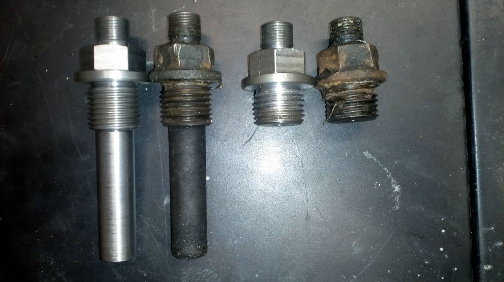

                            Finished – I think – some bits for a Polish tank engine on a steam railway.
                            They screw into the valve chest on the outside cylinders, and I think they're lube injectors – 4 of the long 'uns and 2 of the short.
                            Screwcutting the thread in front of a gasket face was bit hairy at 180 rpm and 10 TPI, but I quite like the low torque of the higher speed range on the Warco – it's saved me damaging components more than once.
                            The thread is also puzzling – it's either 2,5 mm or 10 TPI, but the top diameter on the originals I was copying is 12 – 20 thou plus on 1 inch BSF. So after screwcutting, I finished off with a 1" BSF die opened to maximum. And what's extra odd is that a standard 1" BSF tap is a smooth finger-fit in the 'ole in the valve chamber. So far as I can see, there ain't no M26x2,5 standard thread. These locos have a complex history and I don't know whether the 1" BSF thread was original, though I believe some think it is.
                            Still, if it doesn't screw in, we'll just run the die down it with increasing closure until it does.

                                          Yep, 4 out of 6 fitted straight away – the other 2 needed one run of the die a thou or two tighter. I think I'll be making the pipe union cones and nuts once someone tells me the pipe diameter.
