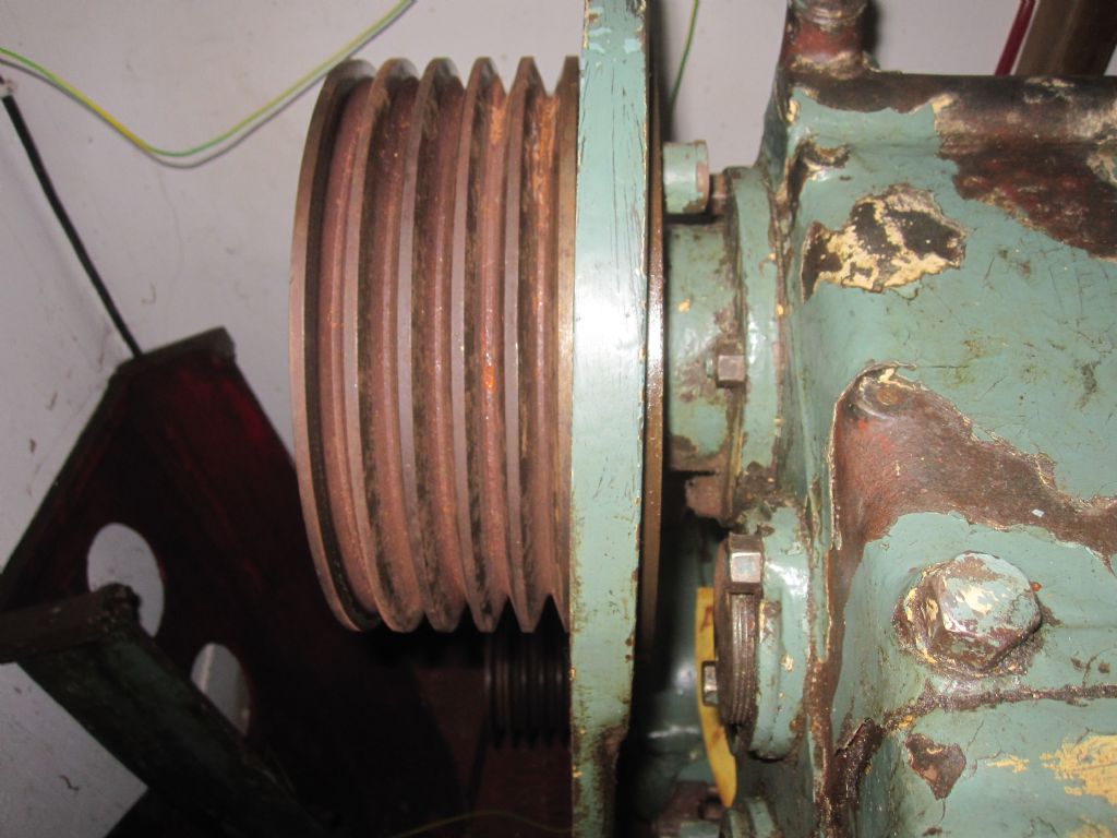

  • #346419
    Bob McDougall
      @bobmcdougall63250

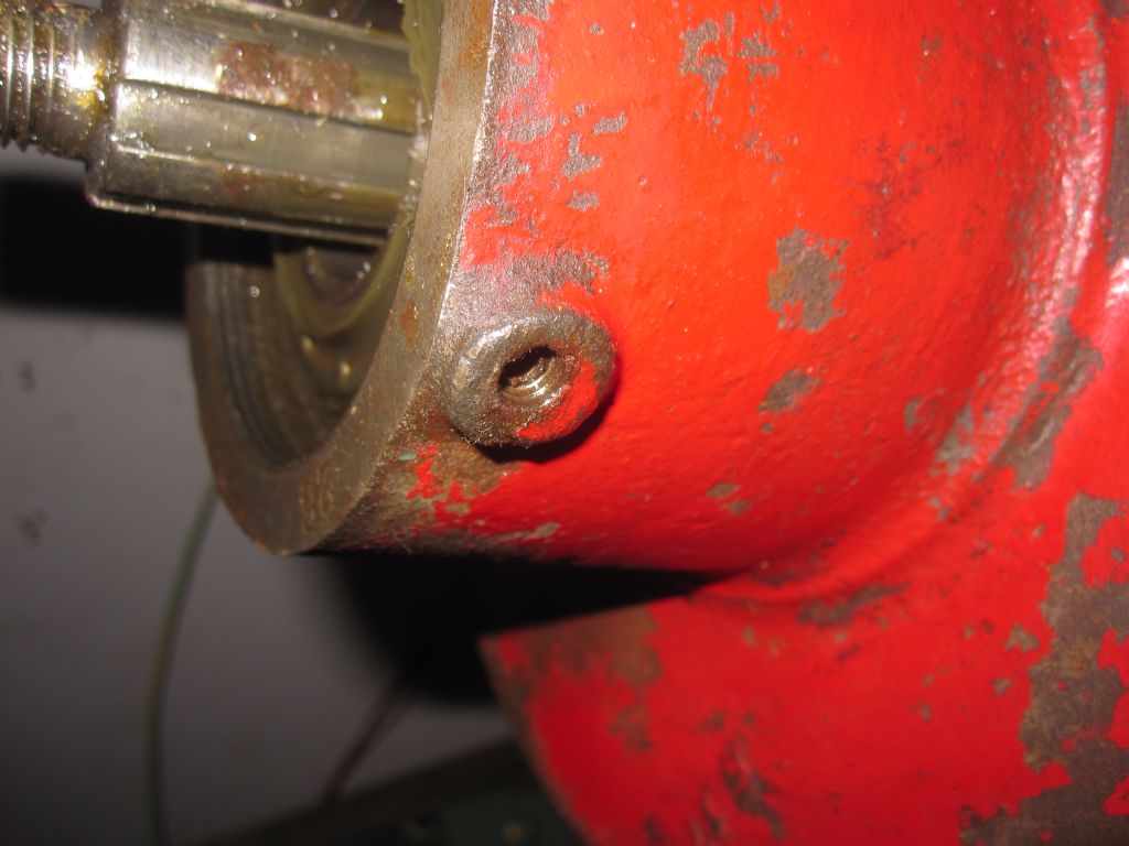

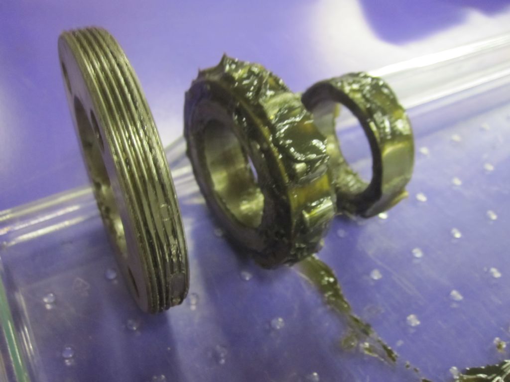

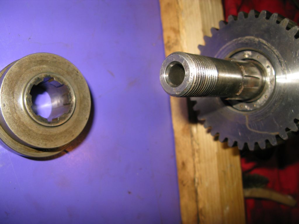

      When viewed through the top inspection hatch one of the shafts in the gearbox was moving sideways when th egear selector was moved and one of the four clutches was obviously siezed so further work was needed.

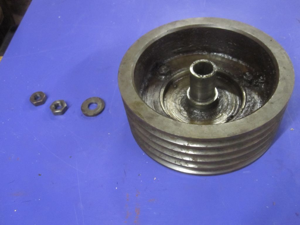

      The gearbox pulley was removed . The bearings for the shaft were in a housing external to the main gearbox . the first roller bearing held in by a ring which was held by a grub screw we missed. img_1061.jpg
      The grub screw came out unharmed after we hammered the ring clear of it. DoH!.
      The bearing housing was held to the main body of the gearbox by four studs, two came out , two nuts came off. but it wasn't free. It had a collar which enters the gearbox along the caseing split we found out when we loosened the case bolts and the end bearing covers. img_1070.jpg
      We had a break when my Downham Mini Borer arrived. It only took four of us to get it out of the Van and upright.

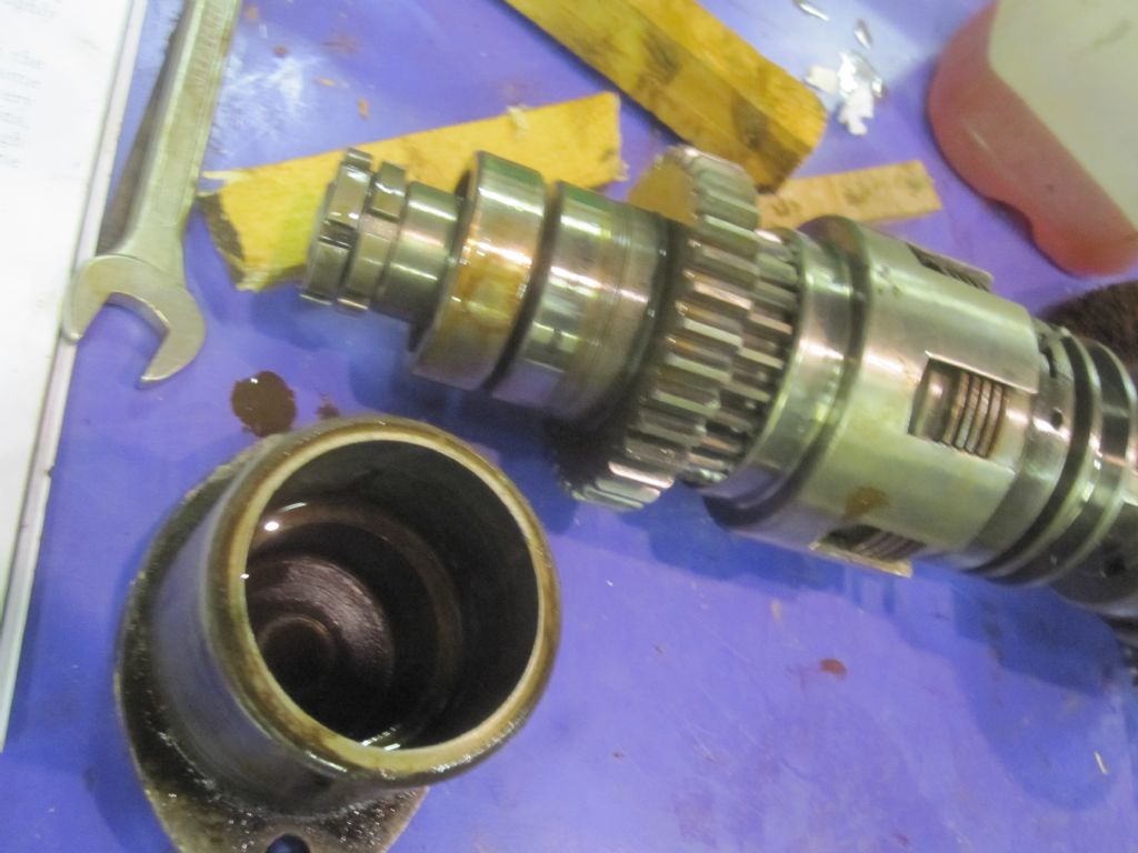

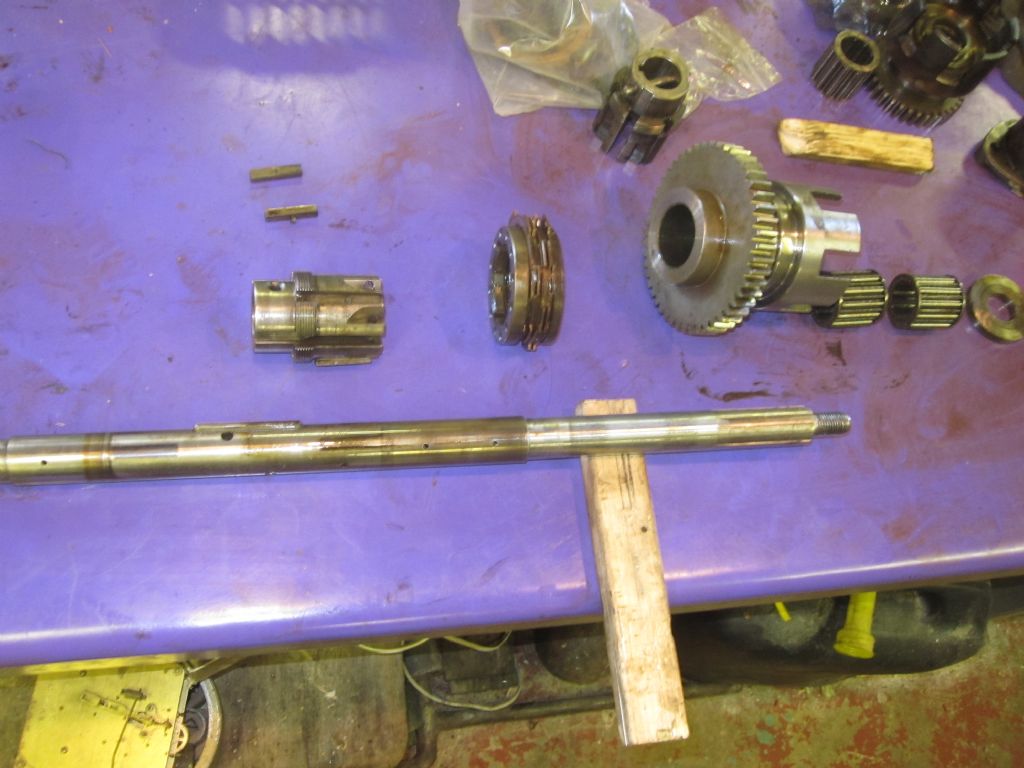

      #348207
      Bob McDougall
        @bobmcdougall63250

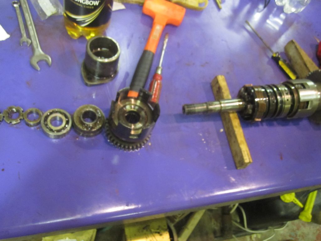

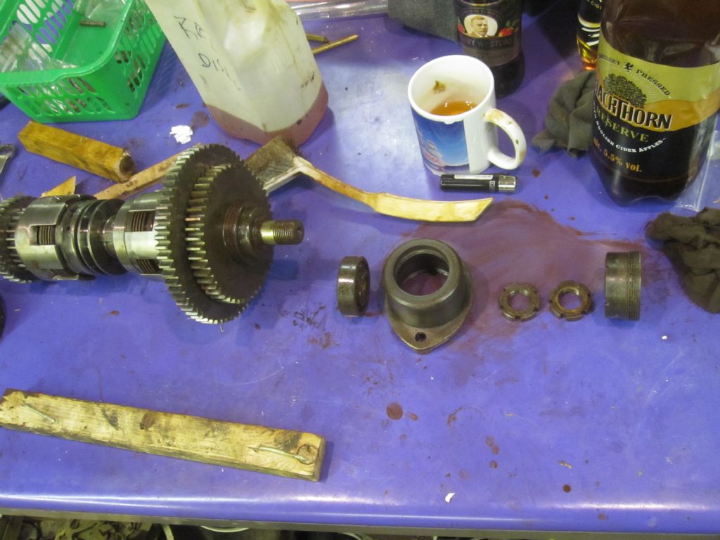

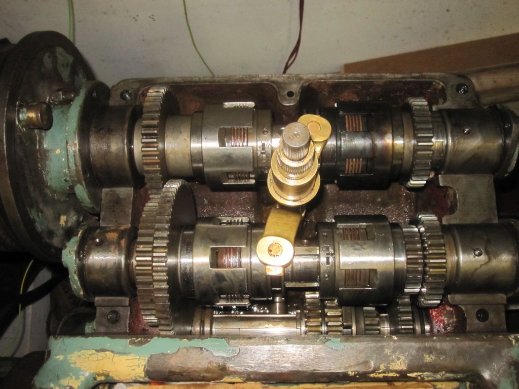

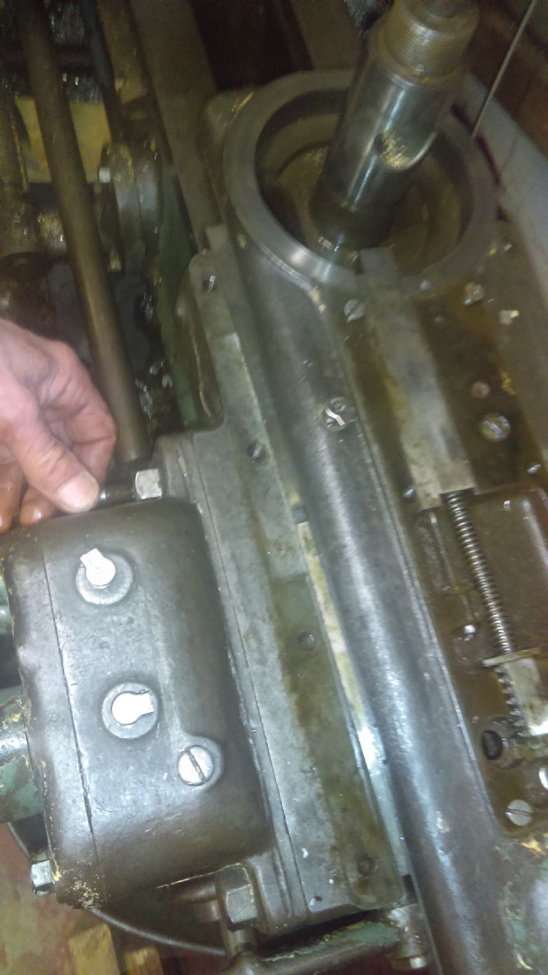

        Unfortunately the gearbox had problems and when we looked into it (through an inspection hatch) there was lateral movement one one of the shafts and one clutch appeared seized.
        ward 2A gearbox
        The the motor pulley bearing housing was sunk into the gearbox so the case needed to be loosened to release it. Once inside we found this four clutch system. used for rapid fast /slow, forward/reverse. One has clearly overheated and bits of metal were in the gearbox gunk. The end bearings were shot and one was stamped Germany so I assume it was replaced during its 1961 referb and not an original 1950 part.
        The whole shaft assembly is an amazing bit of work. the clutches are taper pinned to the shaft and run on spiral grooved roller bearings. All the pictures in my album.
        and some bits in the gearbox.

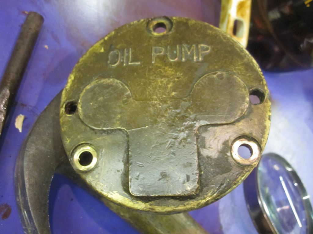

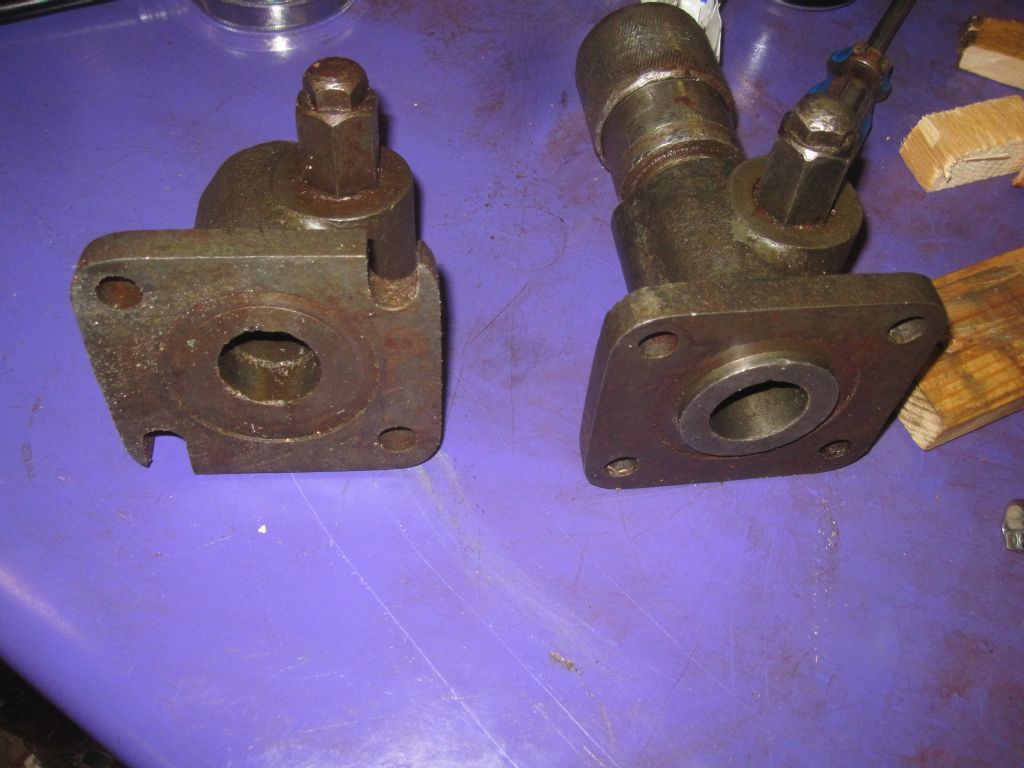

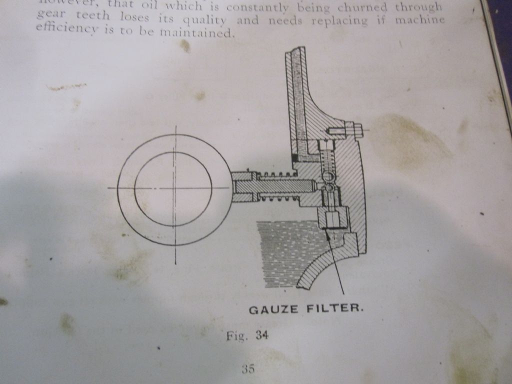

          The oil pump runs off a cam (below) on the main input feed shaft the cam pushes a lever which rocks onto the oil pump via a shaft that was seized. So possibly in its past the oil pump seized then the clutch overheated and spat out a plate. The clicky worn bearings will be replaced and a new clutch plate (err.. ) made . local CNC shop will spit one out in a day. grit my teeth and pay. img_1143.jpg

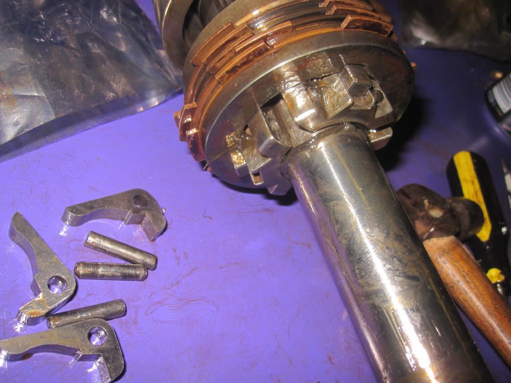

            #349118
            Bob McDougall
              @bobmcdougall63250

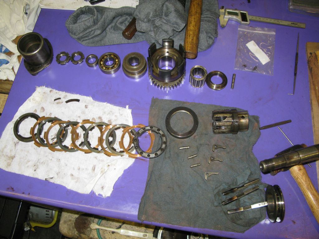

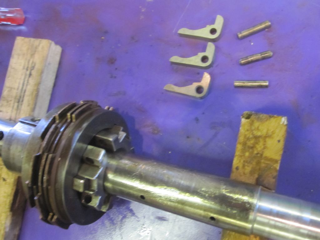

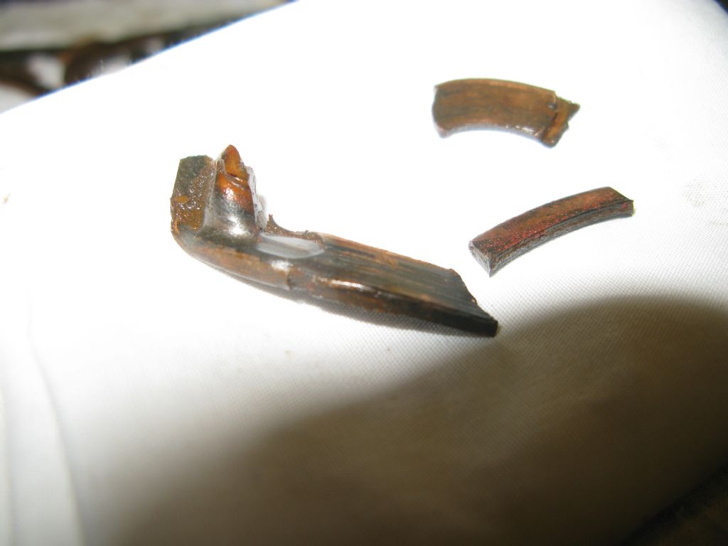

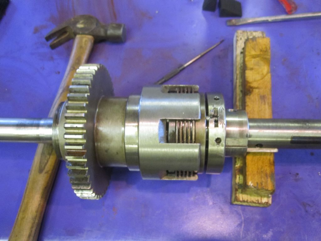

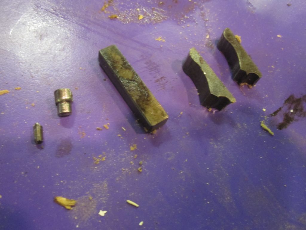

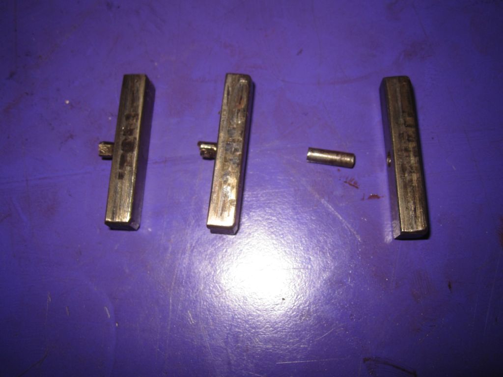

              Further dismantling of the second clutch on the power input shaft, the sliding pin in the outer ring had sheared . The outer ring unscrews but the clutch doesnt come out over the middle . the taper pin must be knocked out and the clutch assembly pushed out from the shaft centre away from the woodruff key not over it.
              broken lever arms and a sheared pin on the square bar fell out . img_1177.jpg
              All replaceable. we were getting close!. just the end bearings to replace.
              This end fell off whilst we were braying the other end. LOL.
              So this end bearing was inserted from the outside as opposed to the other end which was inside so the end cap just popped off. This had an externally removable cap that we could'nt get off in the vice so we re-assembled it into the gearbox housing to get best purchase then the cap gave in. The bearing was onto a groove so cant be pulled off without removing the double nuts. One end bearing was really chewed up and Im amazed it hadnt broken the cage. The bearings are 7/8 inner, 2 1/4 outer 11/16 . MS9, ordered 3 for £21.
              The oil pump ! well half of it is missing. its not in the sump. The main body is there but the piston and spring are nowhere to be found. img_1189.jpg
              Not sure if this is the correct pump, the internals are there with the double ball bearing valves but the piston and spring are missing. Also there are two holes in the housing that dont hatch any fixings.
              Does anyone remember the oil pump ?

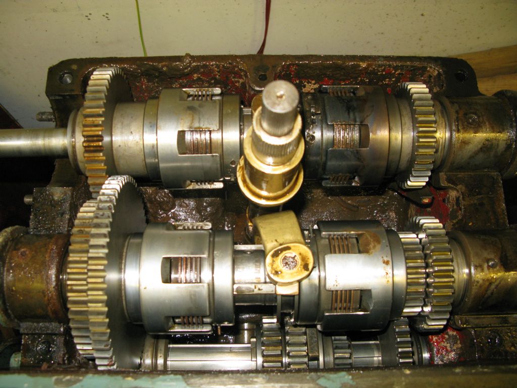

              #350026
              Bob McDougall
                @bobmcdougall63250

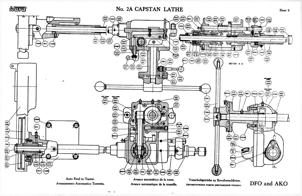

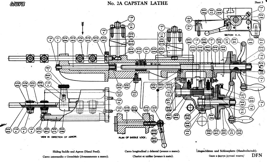

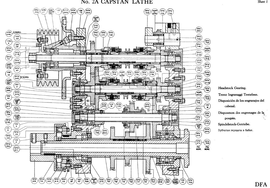

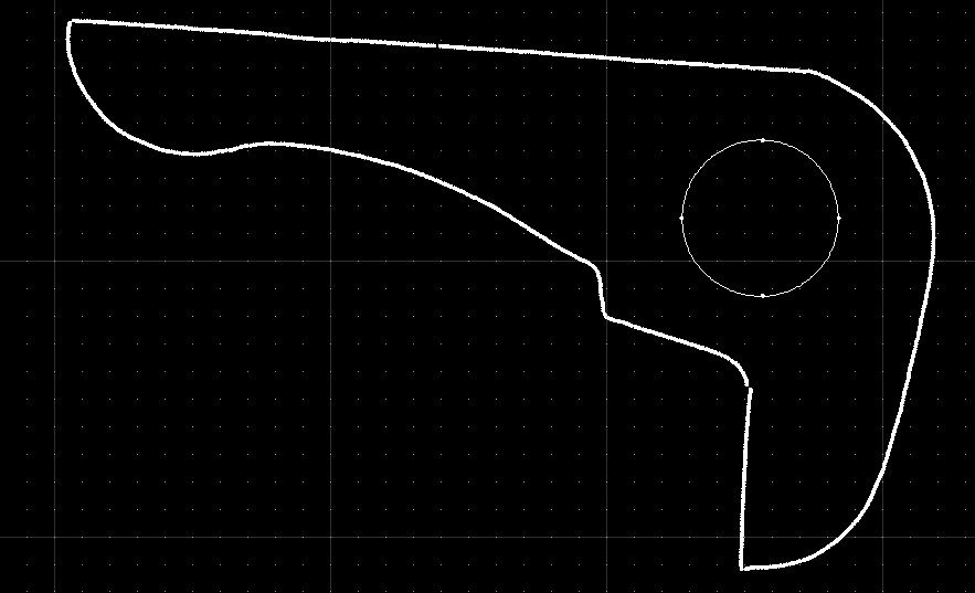

                profile scanned the broken lever thanks to kind work colleauge .

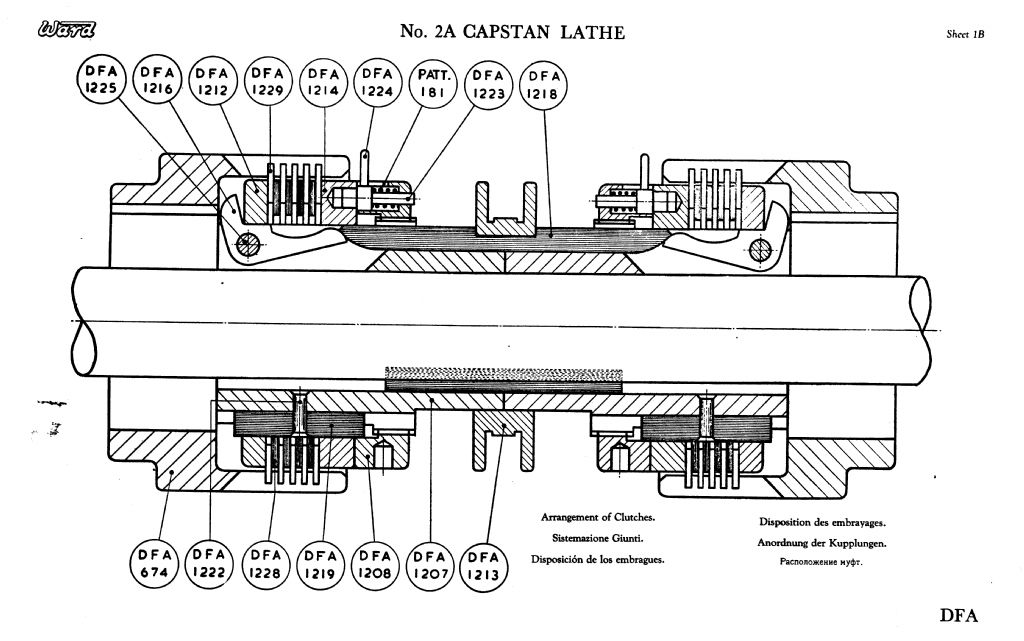

                Thought I could get it water jet or wire erode cut but tangi-flow ward spares contact came through with origional spares.

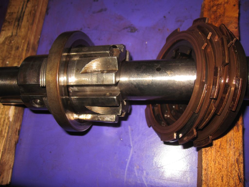

                #350931
                Bob McDougall
                  @bobmcdougall63250

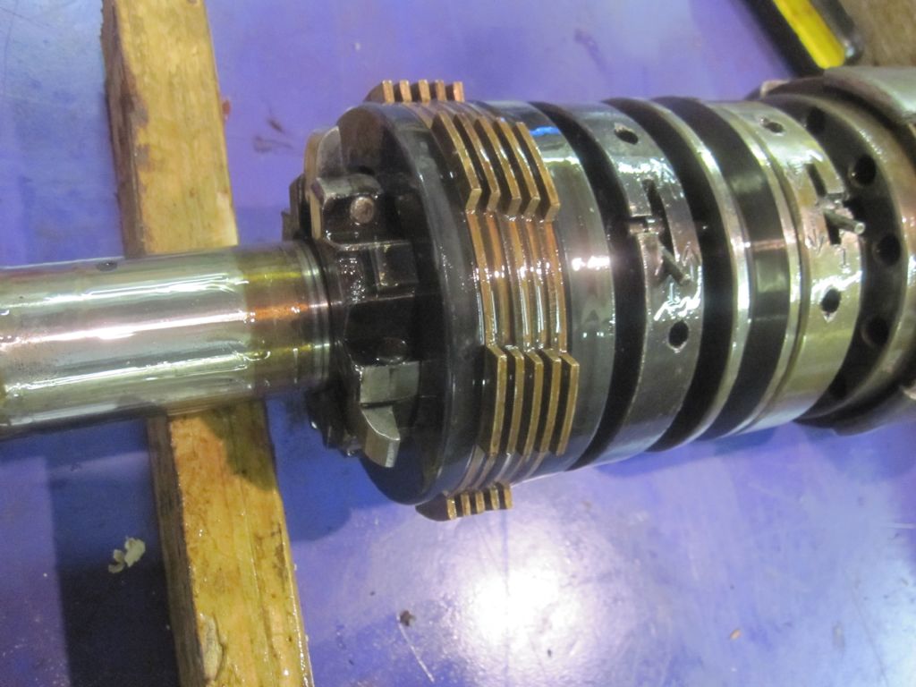

                  Thought I only needed two new levers but when testing the other clutch pair found I needed another three. Tangi-flow gave me a very good offer after discussion. So we started the re-assembly. stripped the input shaft to knock out the broken pin in one of the fixed barsimg_1211.jpg
                  replaced the pin and re asssembled the clutch with new levers.
                  put the clutch housing back on the shaft and pinned it in.
                  put the clutch plates back on
                  then put the levers back in. the new levers were tight on the pins so had to emery them out a bit to be free.

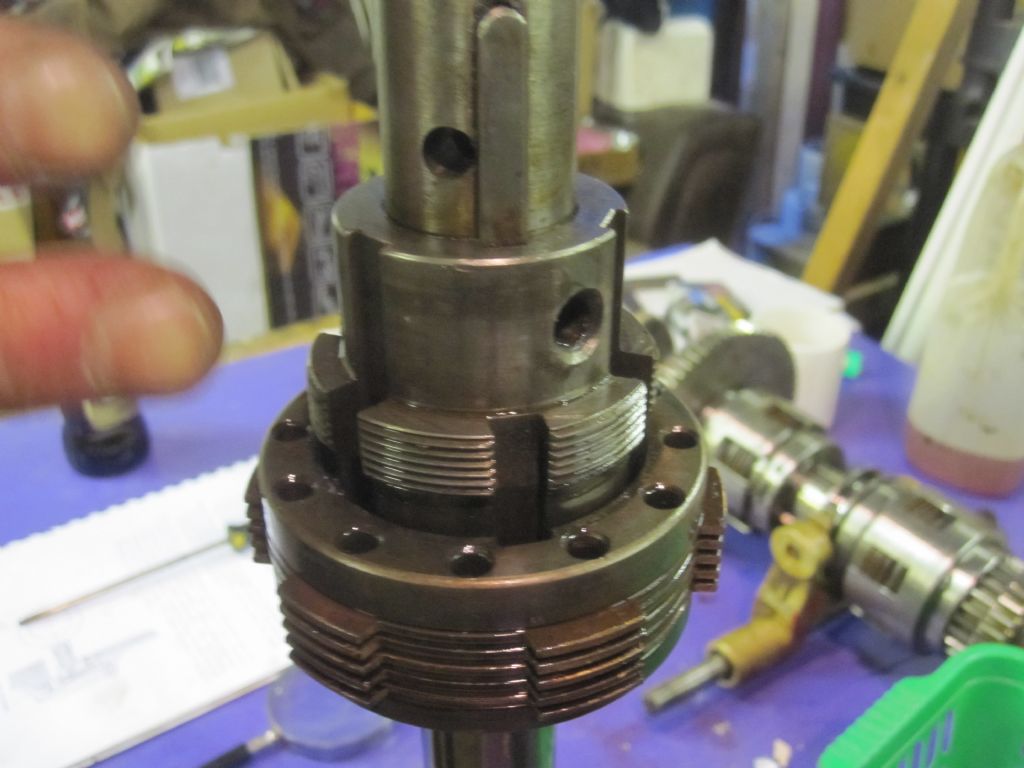

                  the outer clutch adjustment ring assembly. ! we didnt know the function of this ring or the sprung pin until we looked at the gearbox cover. img_1224.jpg
                  JESUS! . since the dissasembly the cover had been upside down and we never saw this and had no idea what the sprung pins were for. it was only as i said, well why are there two access hatches in the gearbox cover we looked. The four clutch assembly was so alien we just thought the pins were to do with the clutch engaging automatically. But they are a manual means to adjust a screw thread to a locked position to allow for wear. Beautiful. img_1223.jpg
                  And the full gearbox gear and clutch system is re-assembled. I adjusted the four clutches with the sprung pins for bite and release. . lets see what happens under power !

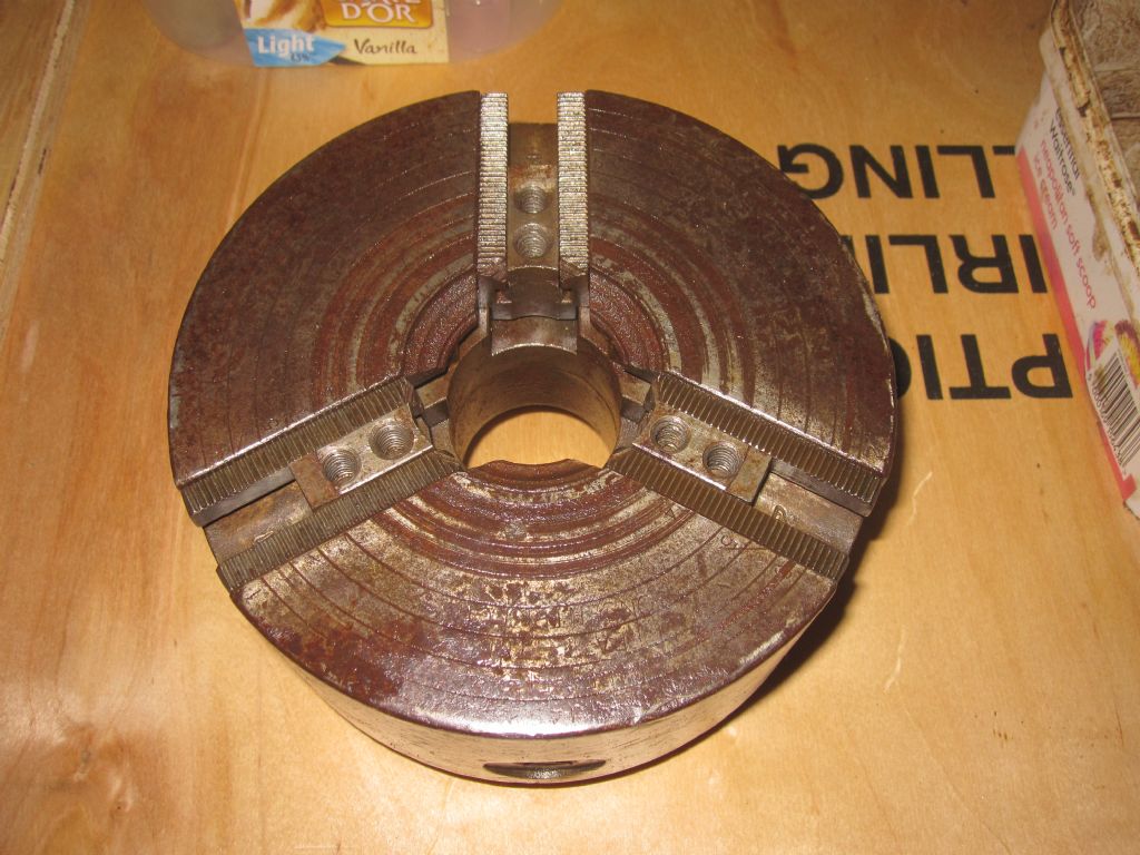

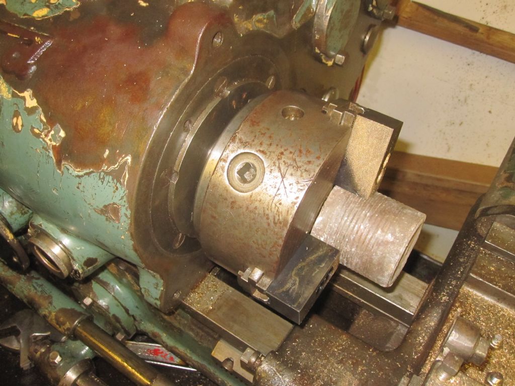

                  #350933
                  Bob McDougall
                    @bobmcdougall63250

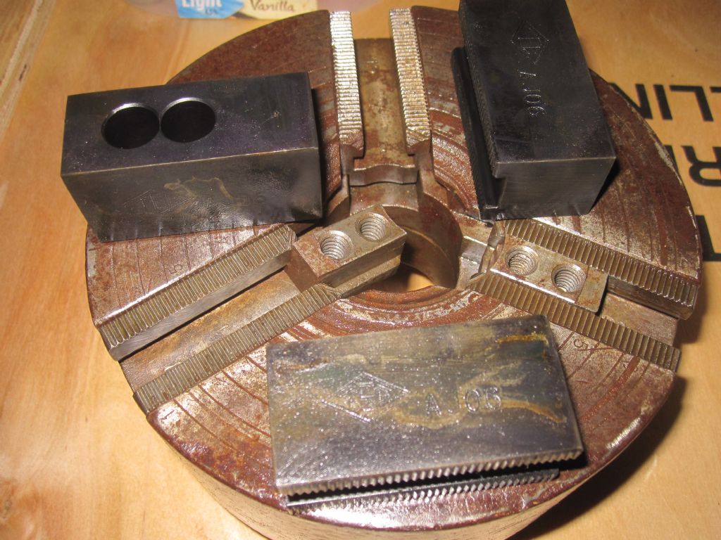

                    WARD 2A CHUCK. It finally was found in the same shed the gearbox had been stored in. Covered in rust. img_1225.jpg
                    No makers marks. but it has very abused soft jaws marked as TEC JA6, THAME jaw JA06, for a Coventry /Tudor chuck. The chuck is 6 1/2" which makes it a TUDOR. serrations on the jaw 1/16 which is very slightly over the new metric 1.5mm. 10 teeth measured 15.8mm. 90 degree cut not modern 60. but as a consumable they were available and I had a new set of jaws in my hand this morning. Fantastic . img_1227.jpg
                    the backplate on the ward is a 5 1/4" with two sets of 120 degree fixings at slightly differnent diameters. The Tudor chuck pins into the outer set. but the 5 1/1/4 is the concentric seat. .
                    All going well and a happy week .

                    #351911
                    Bob McDougall
                      @bobmcdougall63250

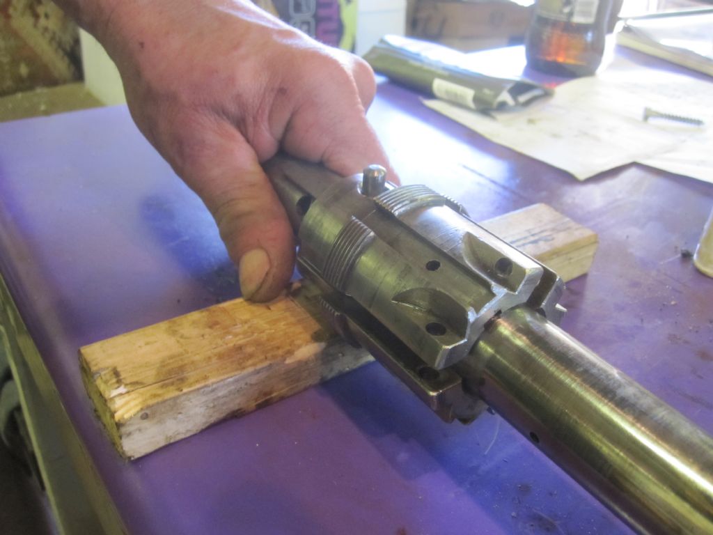

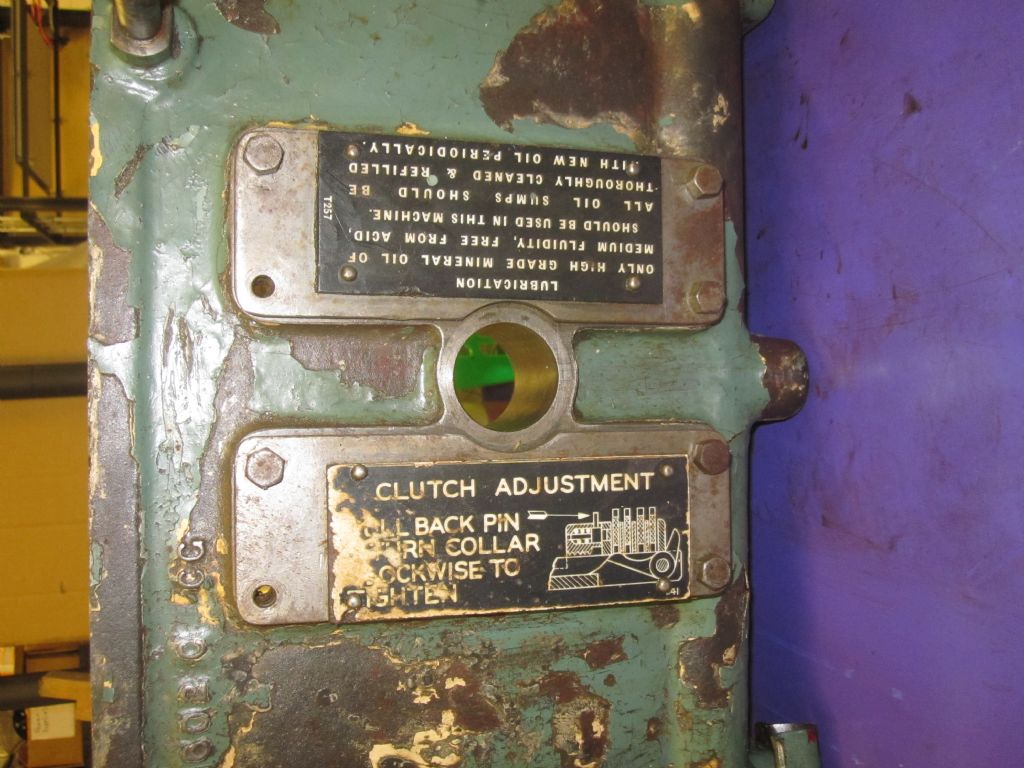

                      The parts all back together we started her up with the two top inspection plates of the gearbox open to watch the four clutches in action. A few adjustments . and a few more. The forward clutch was at one adjustment tight and at the next notch not engaging. . …. strip it back down !img_1229.jpg
                      It seemed like the clutch plates might be worn ? it was the forward clutch .
                      The clutch plates are compressed by three hooked levers , two visible above they compress the first black ring which should slide back when the levers are open but the ring was catching on the lever pins so not disengaging properly . When measured one was 1mm longer than the others.
                      Would like to hear from anyone who knows how to adjust the clutches to the correct grip/slip. Not sure if the plates are supposed to have friction material on the surfaces , all these ones are absolutely smooth. Thought we had it running this week but no.

                            The two tapped holes are for jacking the oil pump out for removal, the clutch that over heated is the high speed clutch and if the oil level drops or fails this is the first item to suffer. Ward made very good capstan lathes, you may have a mix of gearbox parts 1A, 2A or 3A, the nicest machine to work on were the 7A and 10A, 2" and 3" cap, from memory I think.
                            #351939
                            colin brannigan
                              @colinbrannigan54160
                              To adjust the clutch the gearbox has to rebuilt and ready to run, it's a simple case of withdrawing the plunger and turning the adjusting ring as if tightening a nut, return the plunger to fit in nearest hole then move the clutch lever to engage the clutch, if there is no click as it engages the clutch then its too slack, if the lever wont engage the clutch its too tight. You will soon understand it when you try. Have to go out now but will return later if you have any questions.

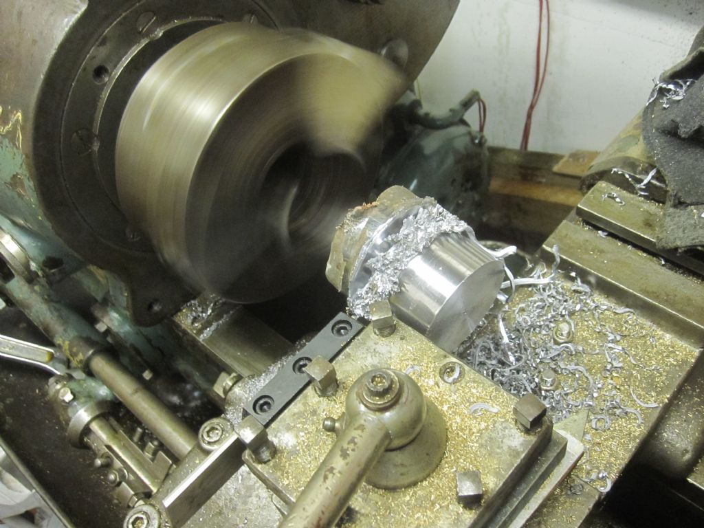

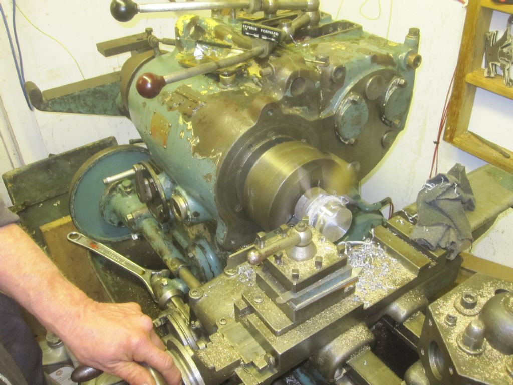

                                  Cutting a lead weight for my Lehman seismometer. . The oil pump still only feeds a drip onto the clutches . I recut the piston on my myford and overcut it, doh! , not as bad as the first time, but by 0.1mm dia. and it still doesnt really pump fully. we will ream the cylinder and take more care next time. The pump CAM also has a rim on it so might be worn so not really pumping to full capability. The cam is on a tapered spline so options are to replace whole or build up from weld and regrind. Once the gearbox is at full speed the oil splashes pretty freely anyway.
                                  The tin cast lead weight in the Jacobs 3 Jaw chuck with new jaws, not shamfer cut for small bars.
                                  Parting it off obviously too fast, it melted the lead and ripped it from the jaws.
                                  But tonight we ran the lathe through all combinations of clutches and gearbox settings. fast forward, fast reverse, slow forward, slow reverse. for all three gearbox settings. and it behaved beautifully.

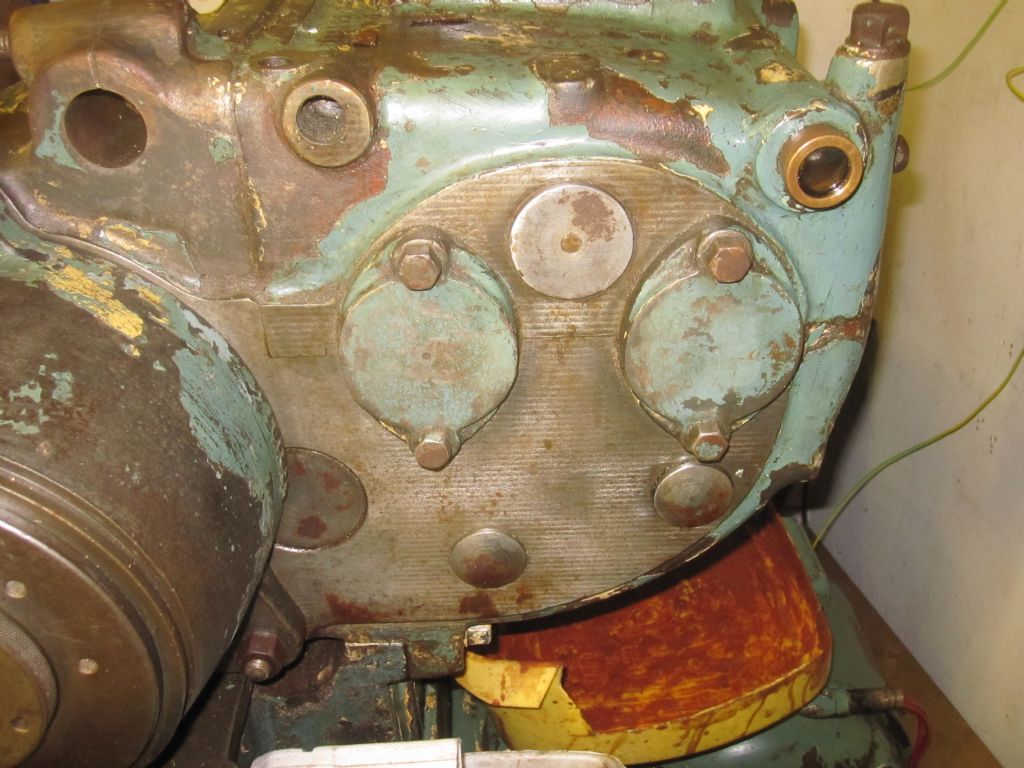

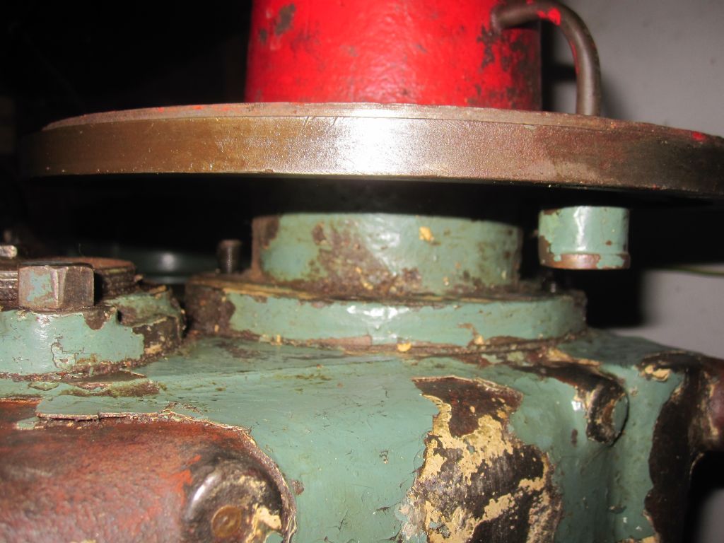

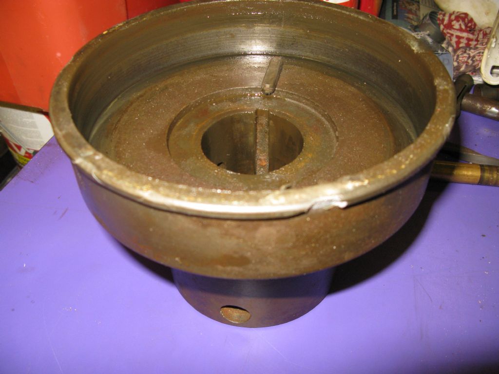

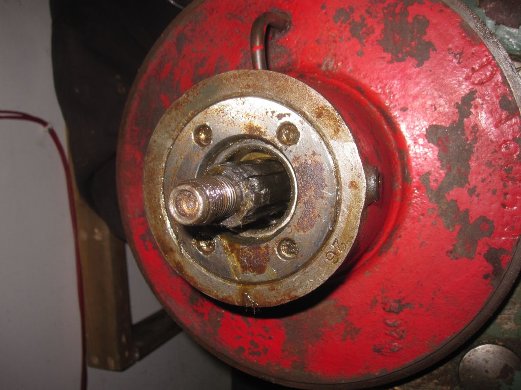

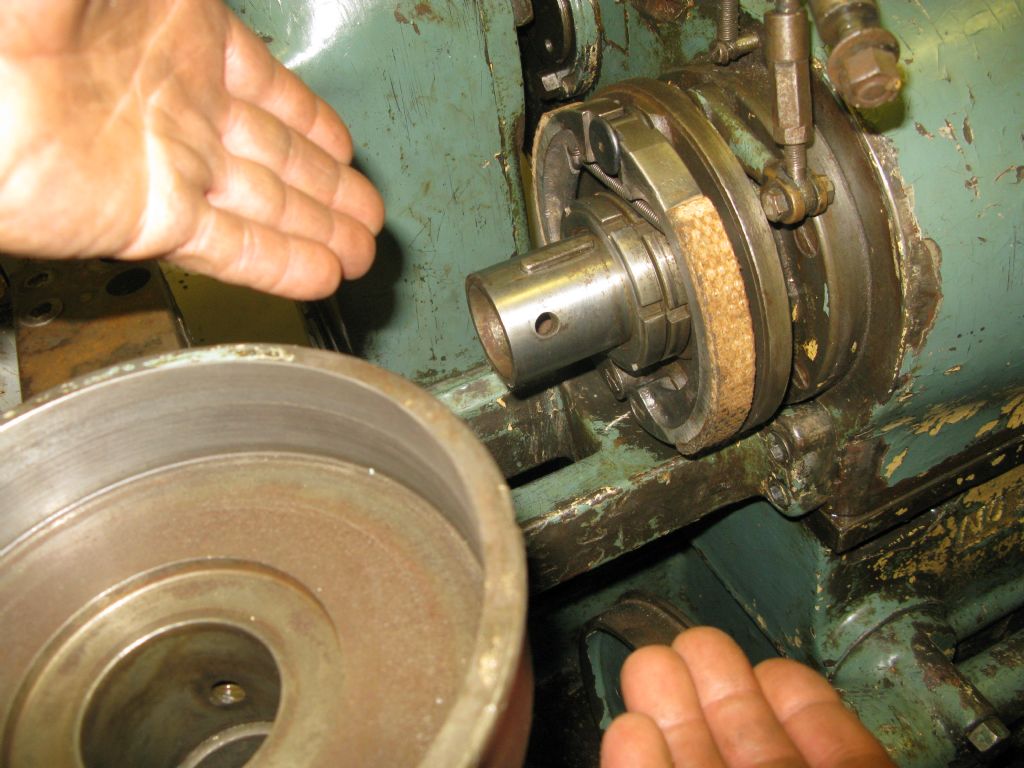

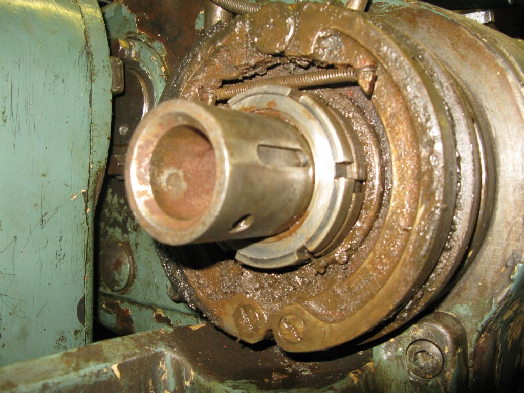

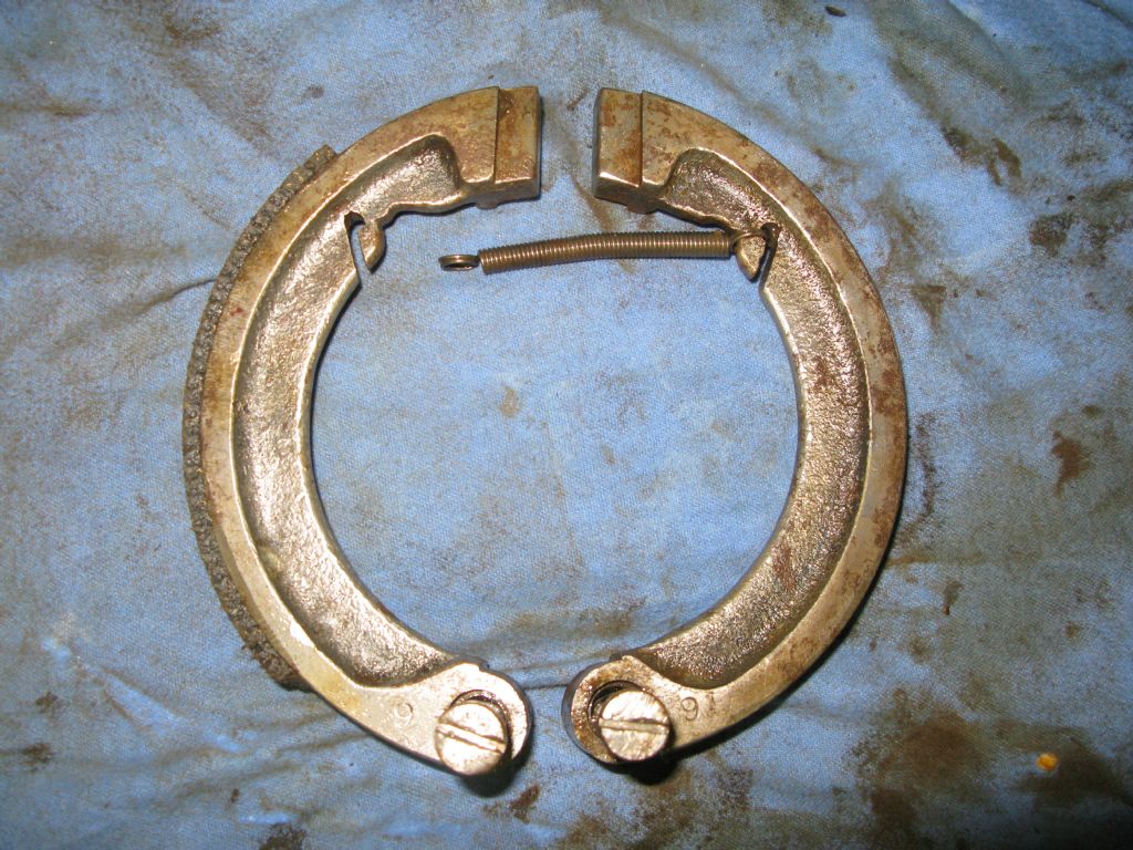

                                        Home straight, just the Brake on the opposite end of the headstock from the chuck to look at, removing three deep grub screws holding the outer housing to the inner shaft reveals the brake shoe levers and the cam at the top. There's plenty of shoe left on one lever. img_1199.jpg
                                        One missing shoe, and the three screws ! holding it in.

                                          #361090
                                          Bob McDougall
                                            @bobmcdougall63250
                                            New brake pads fitted by Villiers Services in Birmingham . nice job £19.50. img_1274.jpg
                                            re fitting the drum . should have been easy……..
                                            first fit. the cam arm was in the wrong position.
                                            second fit , the cam arm was in the wrong position.
                                            at this point we realised the cam arm was on a spline that had moved during the origional dissasembly.
                                            what we thought was a 10 minute job is now next weeks job. She is hard mistress.

                                              NDIY, only a guess under the muck in 1st pic/08Jun, think the third screw could be a 'top-hat' shouldered screw acting as a pivot point for the 2shoes, up by the spring.

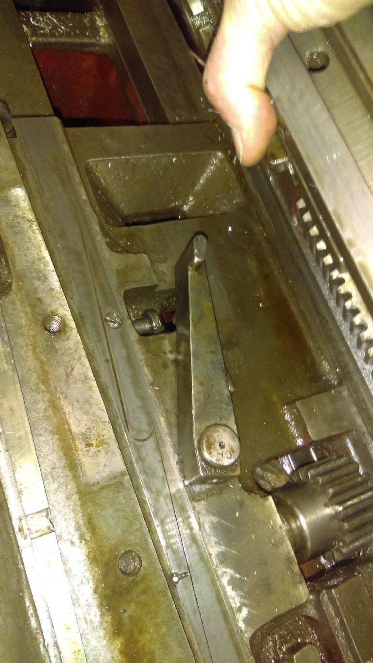

                                                Found an assembly error on the capstan feed that makes the feed jam. There is an arm inside the capstan saddle that engages with the capstan turret lower sprocket to push the head to its nest location. There is a button which can move this lever out of position so the turret doesnt auto turn when you move the mechanism back. This lever has an underside peg which needs to be on the INSIDE of the flanged button rod. we assembled it on the outside and it worked for a while then jammed. Image 1 is the outside button, image 2 is the lever in its incorrect position outside the plunger head. it should be on the inside. .
                                                After we fixed it we drilled 1 inch holes in 5mm steel plate with no pilot drill. Nice.

                                                  A look at the 'fitted' photo shows three holes in the lever that shoudl be for (presumably recessed brass) screws to hold missing the pad in place.

                                                  Bob McDougall
                                                    @bobmcdougall63250
                                                    three screws, not sure this is the right post.
                                                    Latest problem is the capstan slide is so worn it sits low centre height by about 1mm. so thinking of shimming the whole capstan head rather than the slide.
