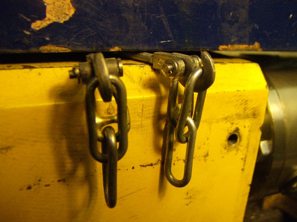

                    I made the cross holes in the pins for these links using a No. 60 drill, and just made a tiny flat with a file before drilling. Just used my clarke pillar drill, but drilled teh pins before parting them off the stock.
                    The spring clips are from guitar 'e-string' – annealed so it will bend then re hardened and tempered. Looking at the picture perhaps I should have used heavier wire.
                    The heat treatment was a bit his and miss and I had one that stayed brittle and broke.
                    I like Jason's split pins.

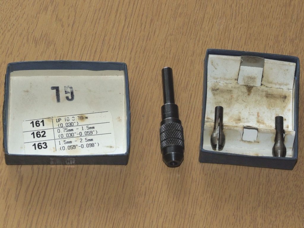

                            Something like this from ARC would be safer

                              The problem with your first suggestion Jason B is that I need to hold the drill to drill a hole to hold the drill………..etc!
                              I like the second idea better, and the micro drill adaptor will be very useful as will the small chuck.
                              I have ordered from ARC Euro Trade in the past and their service is astounding. On both occasions I placed an order on Thursday night (Eastern Australian Standard Time) and the items were delivered on the following Monday morning to my Melbourne address. And the prices were about 60% of what I would have paid here, even after air freight of about $45 per kilo. And the delivery was quicker than when I ordered from a firm on the other side of Melbourne.
                              I have a number of pin chucks, and have used them in the past for small drills, but none are concentric and they can only be used with a hand held drill where they centre temselves. A bit too fraught for 25 thou.
