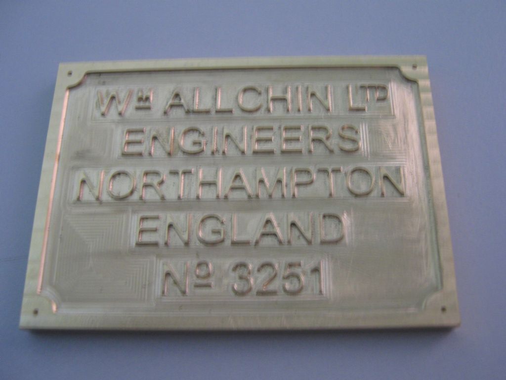

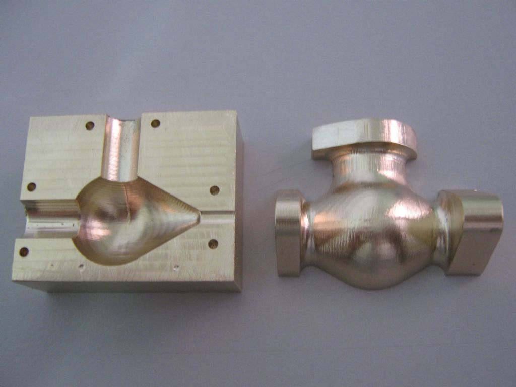

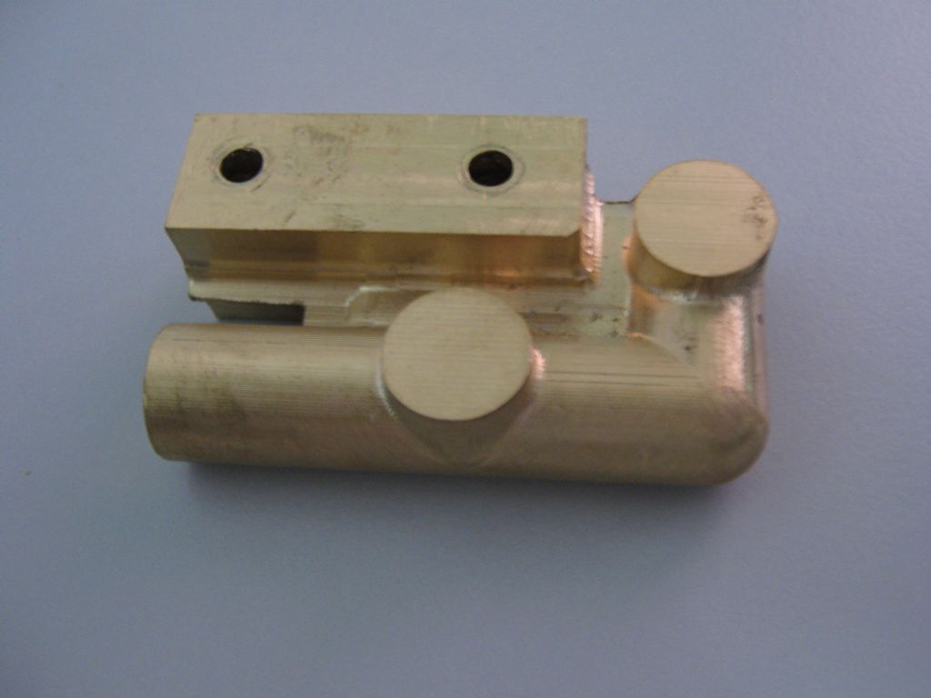

      Hi
      I recently added a small cnc facility to my workshop, while I prefer conventional methods which are much more interesting and challenging the CNC adds some options for parts that I can’t do other wise.
      In this respect I limit my CNC to a) Parts that need engraving/etching b) parts that would otherwise be expensive or long delivey castings c) parts that would require alot of fabrication and silversoldering. Here are a few examples.
      Above is a water lifter in 2 halves to be silver soldered together and finished by conventional machining and by hand. Left is one half finished on the inside only, on the right the matching half complete inside and out.
      Above is a steam header just off the cnc and ready for conventional turning/drilling and finishing. This would otherwise be a casting or fabrication.
      Above are brackets ready for hand finishing. Could be done by conventional machining but I think most modellers would prefer a casting.
      Above is a name plate ready for finishing and infill painting. This would otherwise probably be a casting or maybe etched.
      For me the cnc adds some conveinience and control over buying castings. While I can fabricate I don’t like fabrication involving alot of parts, my preferance here would be to cnc what I can.
      Nigel
      PS sorry for any bad spelling, I wish this forum had a spell check.

                          Just to concur with John S comment about learning G code.
                          Reference to my post above, each part was programmed in 5 to 10 minutes without any knowledege of G code. The post processors used were Vectric 2D and Meshcam. 30 minutes is enough to learn how to use these programmes and start producing G code for real parts.
                          Getting started was not without problems, this and other forums provided fantastic support.
                          Nigel
