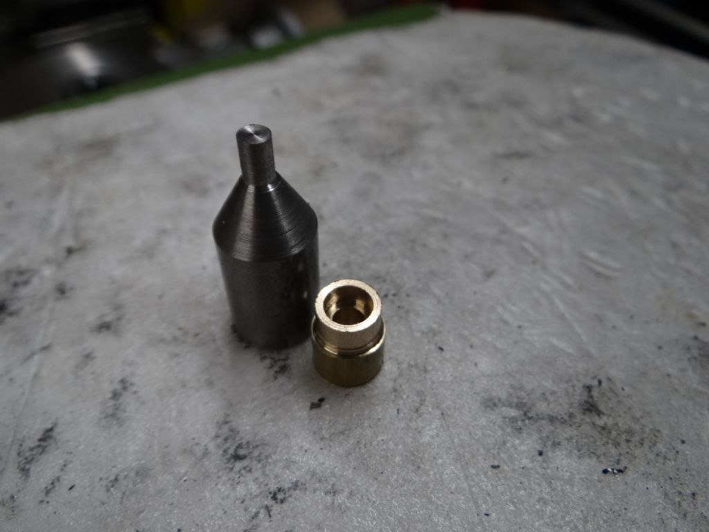

      I tried again yesterday with an annealed boss. Slightly more successful but still a failure. Also, the whole softened brass boss deformed under pressure, not just the flange. I will try lengthening and undercutting the 'to be swaged' part of the boss though I doubt it will make enough difference.
      As Jeff reveals in his educated post, this job isn't as easy as I thought. My plain punch and brute force approach didn't work! However, I was able to move the metal enough to suggest that a combination of angled punch as per Jeff plus a thinner swage section might work. (In the hope the job can be done in an ordinary home-workshop.)

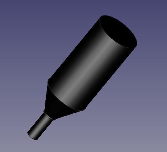

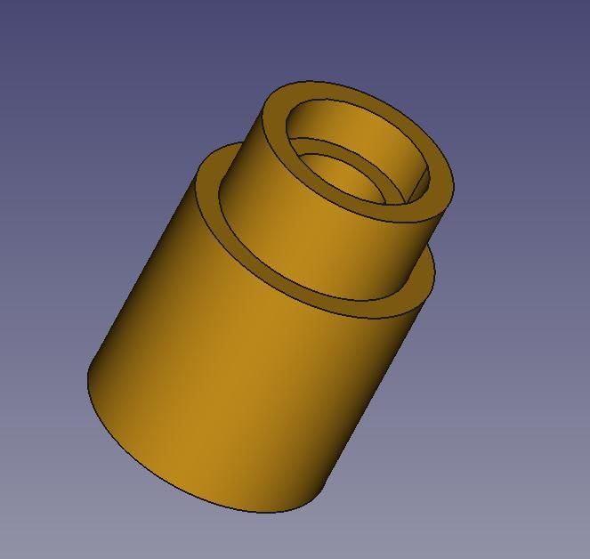

      The boss might be counter-sunk like this:
      And the starting punch shaped like this:
      The tapered punch would be used to start the swage, and a plain punch used to crimp it down to finish. Pesky domestic commitments mean I won't be able to try until tomorrow.

        That latest boss looks a bit more realistic. You should make the thin section as thin as possible, consistent with being strong enough (it's only a toy? Sorry!). If using a manual process, rather than a 2 stage tool starting with that conical punch, I'd expect a single tool with more of an annular section (semi circular in section), so that the thin section is bent back onto the flat surface of the gear, rather like a hollow rivet.
        I suspect the material may be a ductile flavour of brass. Often you will select a specific alloy to suit the production process for a particular part. Having said that I have very little experience of brass myself.

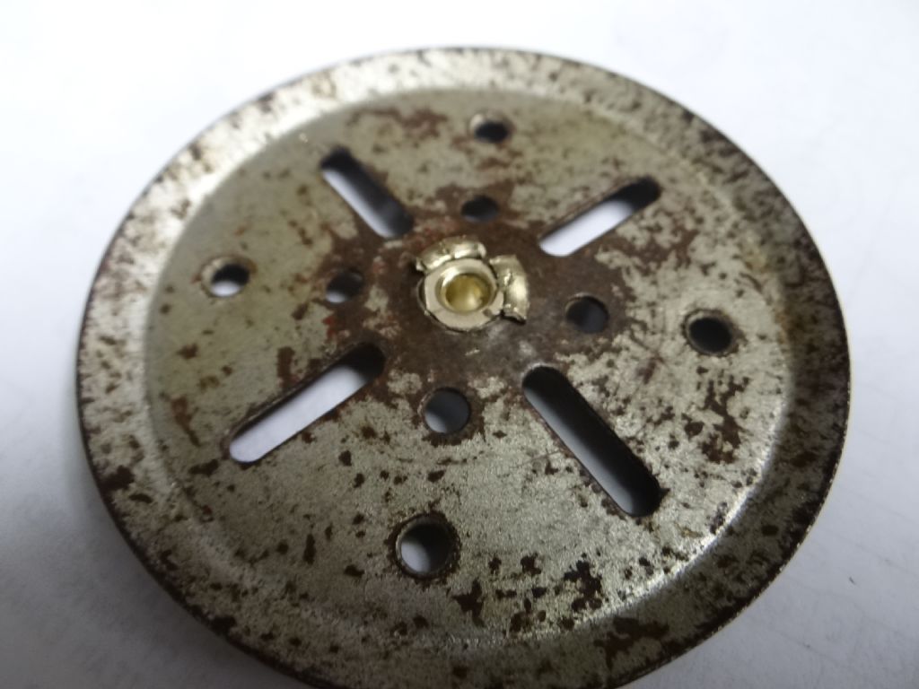

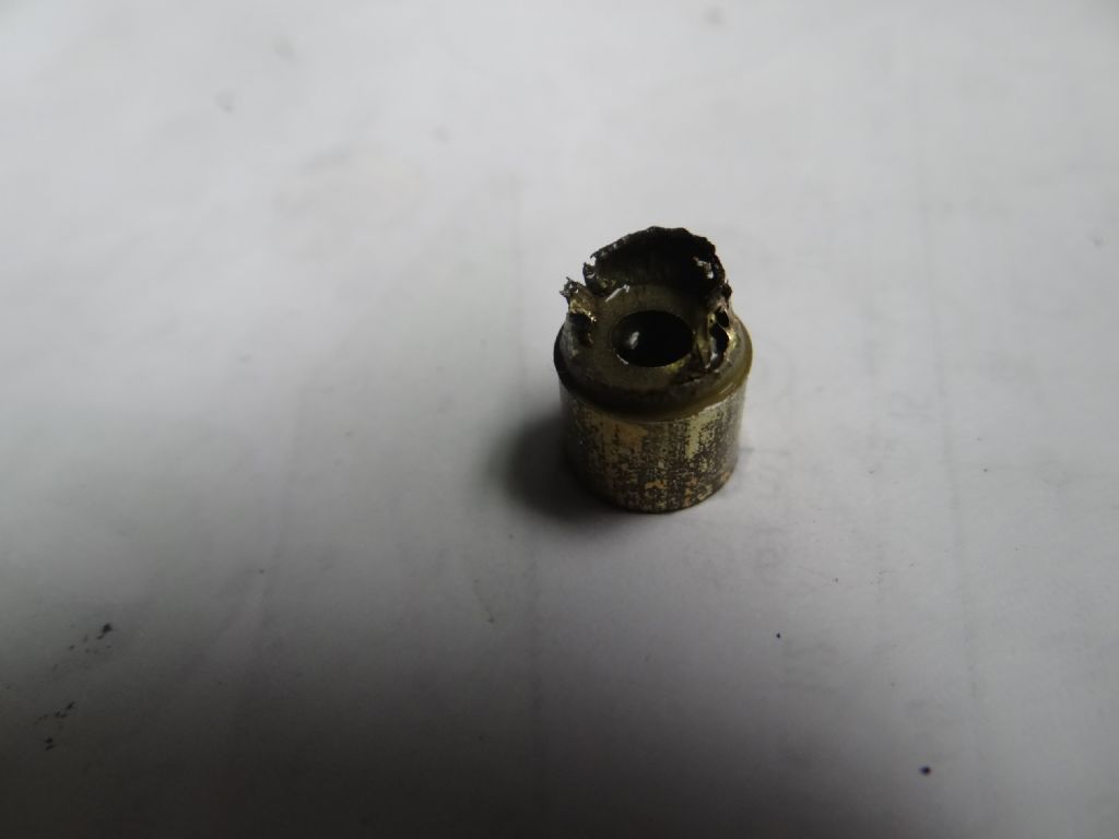

                  Got home early despite the road to the village being closed and had a quick play.
                  Made these:
                  Didn't bother annealing the brass before giving them a squeeze:
                  I'm using 3/8" brass rod and have no idea what the specification is. It's quite hard. Bit blurred but the brass has started to split. I knew Clive and Muzzer's advice about ductile brass would be good, and now I've proved it! After more squeezing a vice, bits start falling off:
                  Despite the brittle failure I think the result is promising. Next I shall try annealing the thin cup end of the boss and see if I can get an undamaged swage from softened brass.

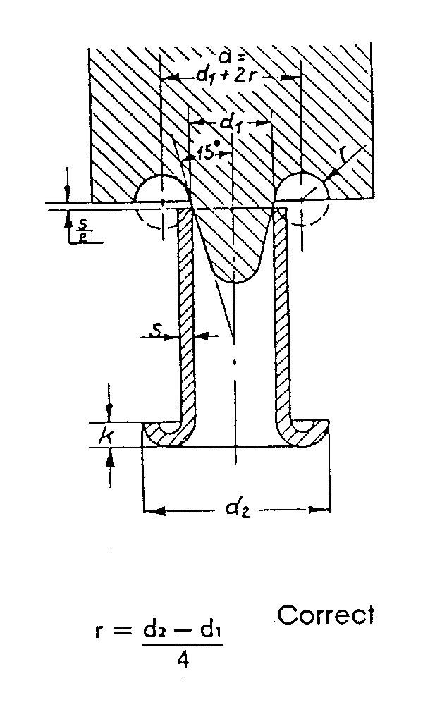

                                          Attached pic of drawing supplied to me by a tubular rivet manufacturer giving correct proportions for a swaging tool.
                                          I have made several of these in the past from silver steel. They need to be hardened, preferably dead hard and with a well polished finish.
                                          For brass rivets up to about 3/16" dia. I used the tool in my drill press running at a slow speed and with lubrication. I have successfully closed a 1/4" dia. tubular steel rivet with a short tool in the bench vise.

                                            It looks to me the problem is the correct material, even if you anneal the brass normaly used in machining it will crack if you try to deform it that much. Why Mr. Penman makes use of a extra bush for fitting a wheel on to a pinion is me not clear. If everyting is supported and lined up correctly you can force the pinion direct into the wheel. This for small and thin wheels or for larger wheels. An old way to fit wheels onto pinions is to force the brass of the wheel into the pinion teeth, but for that method the modern brass is also to hard. Niko.

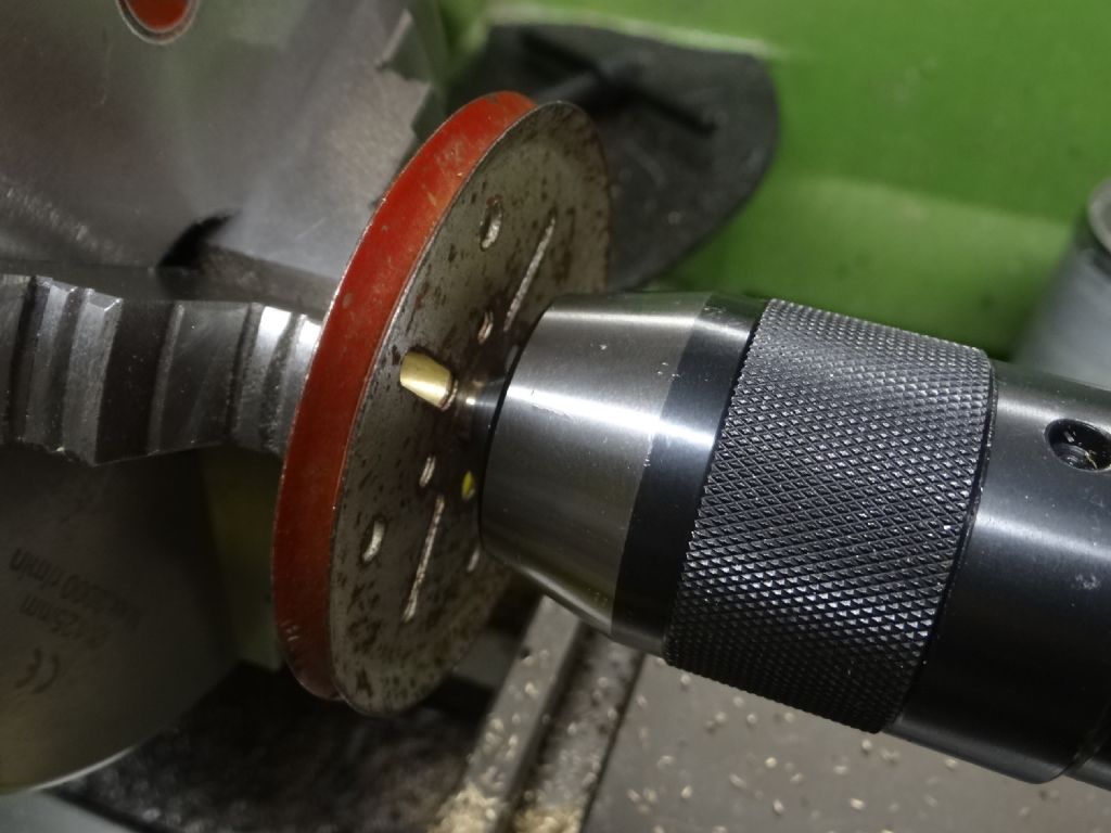

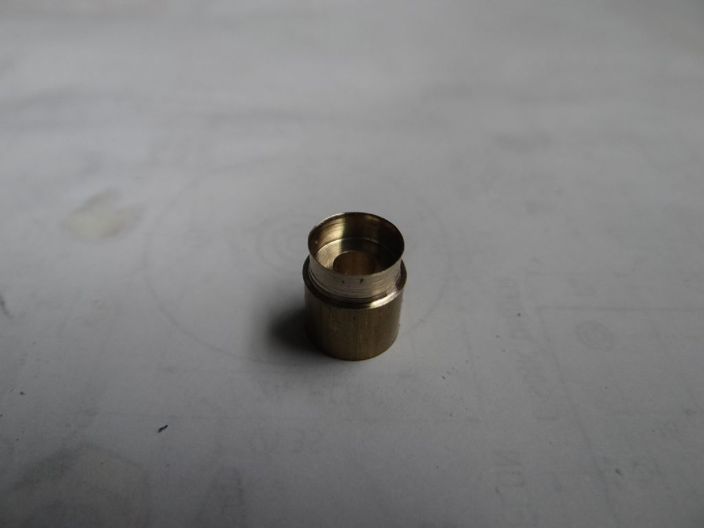

                                              More disappointments. I get fairly close before the cookie crumbles, which is frustrating. Never mind, I'm learning lots of new tricks.
                                              Here's the lathe method ready to go:
                                              I modified the boss so that the swaged section was about 0.4mm thick. Without annealing it flattened fairly well as the lathe turned but, just as the edge of the swage pinched the pulley, it disintegrated. The die/punch approach does the same. The brass gets very brittle the more it's pushed.
                                              I made another boss and tried to anneal it.
                                              Oh dear. I overdid the heat and the thin part crumbled in front of my eyes.
                                              I'm going to try a few more times with the brass rod I've got. Glad for comments on my annealing technique as it may be faulty. Using a blowlamp:

                                                You're right, you are asking too much of the brass you have it's probably wrought brass which seems to hate being deformed. (Been there,done that). You'd be surprised at the difference it makes if you use the right stuff.
                                                And you wont have to anneal it!

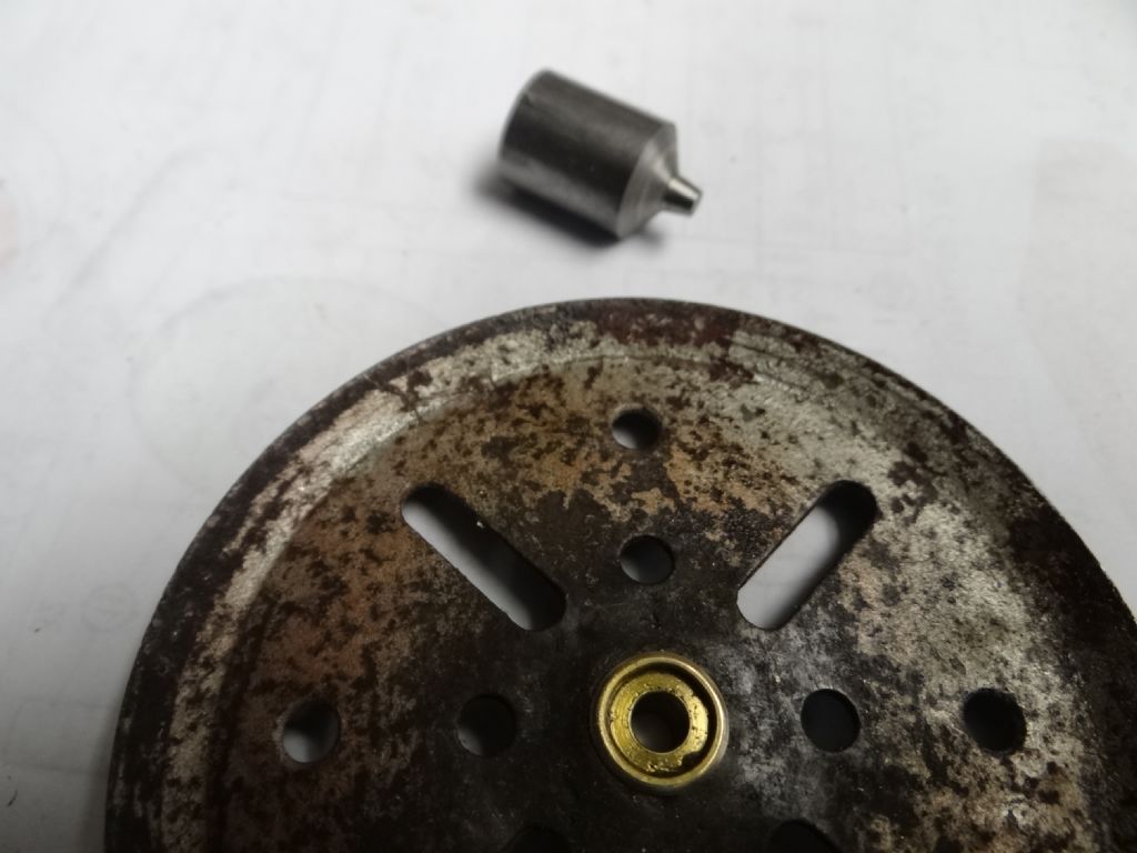

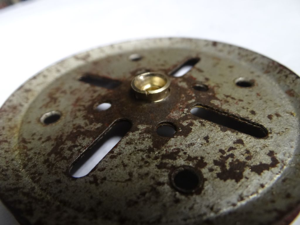

                                                    Success! (Much to my surprise!)
                                                    Despite a few imperfections this boss is a solid fit on the pulley with no splitting. On the downside making it was labour intensive. After countersinking the 4.1mm meccano shaft for 2mm using an 8mm slotting mill, I turned the boss down to 8.4mm over a length of 3mm to fit the pulley tightly. Before attempting the swage, I warmed the end of the boss with a pencil torch until the brass went blue and I quenched it. Then with the pulley spinning at 150rpm in the lathe plus a squirt of cutting fluid I used the tail-stock and the 60° punch to take the fold half way. Then I reheated the swage part of the boss to blue heat and quenched again. Once recovered from breathing burnt pain fumes, I finished the swage off with the flat punch in my vice. The brass folded and gripped the pulley without splitting. (I would have finished in the lathe but the punch I made is too short to fit the chuck. Doh.)
                                                    With a more ductile brass it might be possible to do the squeeze in two steps using a 60° punch and a flat one to finish off. I'd expect the tool shown in Keith's drawing to do an even better job – it starts gently before completely turning the swage over.
                                                    Whilst not a perfected process, I'm happy that this can be done. With a bit more work, a Keith style punch, and the right brass, I think these could be knocked out at speed with just a lathe.
                                                    Many thanks for all the help! You chaps sure know your stuff.
