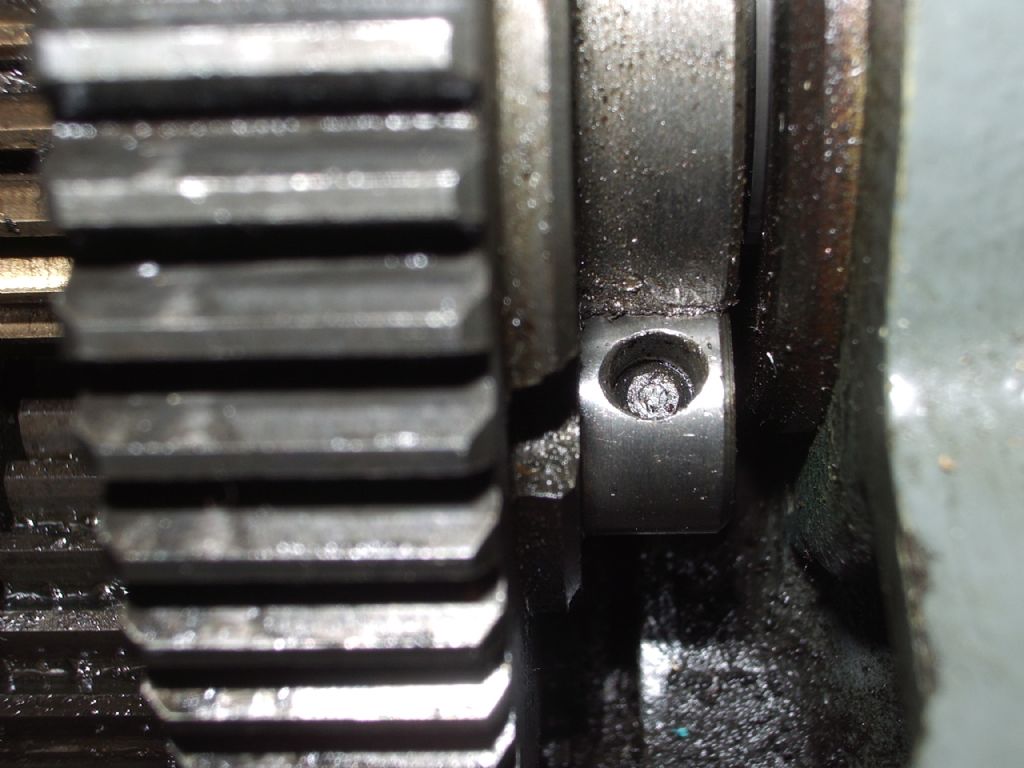

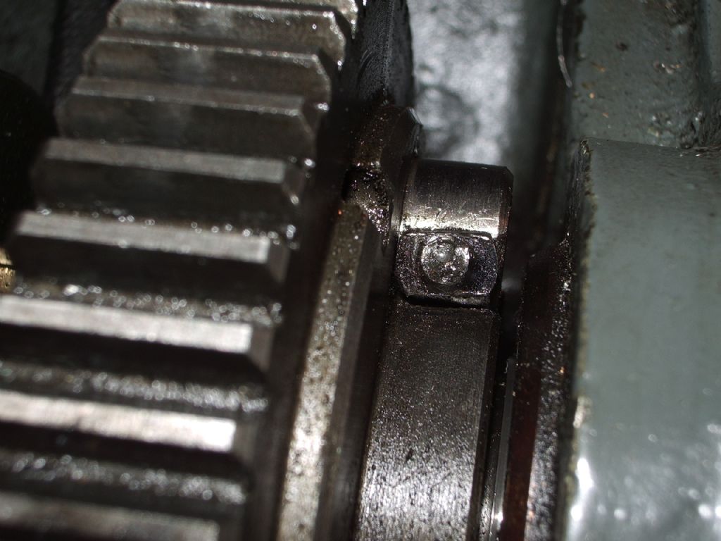

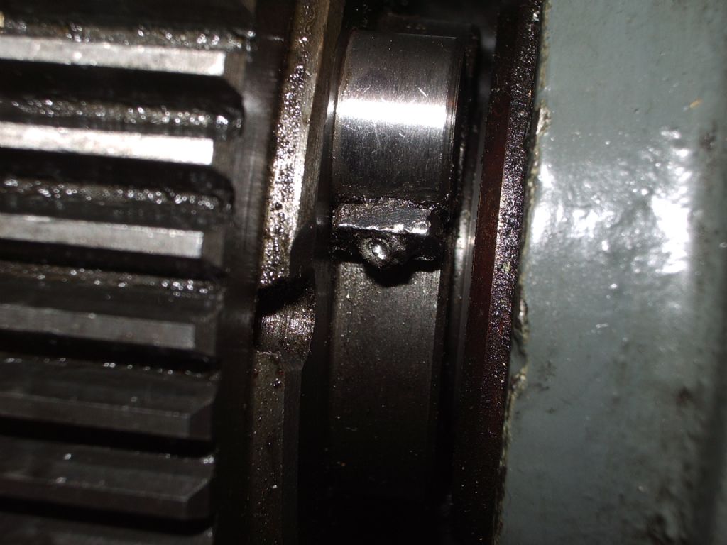

      Folks,
      I have broken off the back gear key lever on my Super 7. I can't see how the lever is retained so that I can remove it to make a new one. Any advice gratefully received. Please see photos.
      How did it happen? Well, I was playing with the bicycle speed display and had wound the VFD up to 3000 rpm. There was a magnet taped to the chuck which was making it out of balance. I guess that the vibration plus the speed flung the lever from its home position and it hit the headstock casting.
      cheers,
      Rod

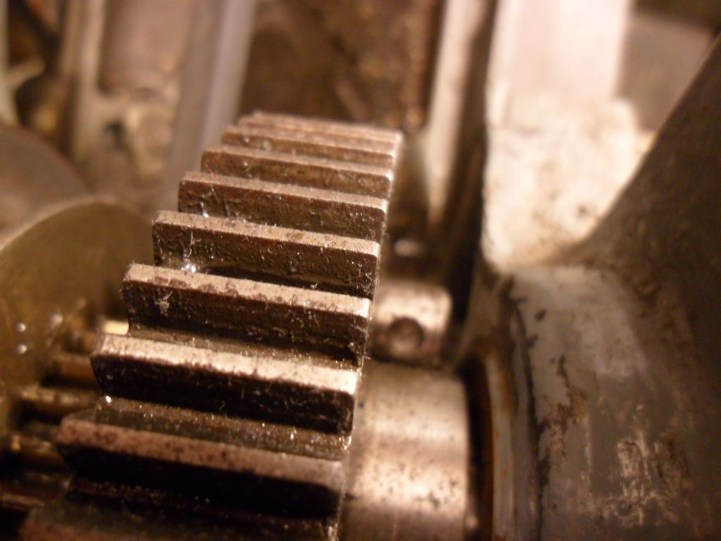

          The lever on my super seven the arm is fitted on a taper and caan be tapped out from the back . I tried to upload a photo but with now luck

              Nobby,
              You're a genius.
              Eternal thanks,
              Rod
