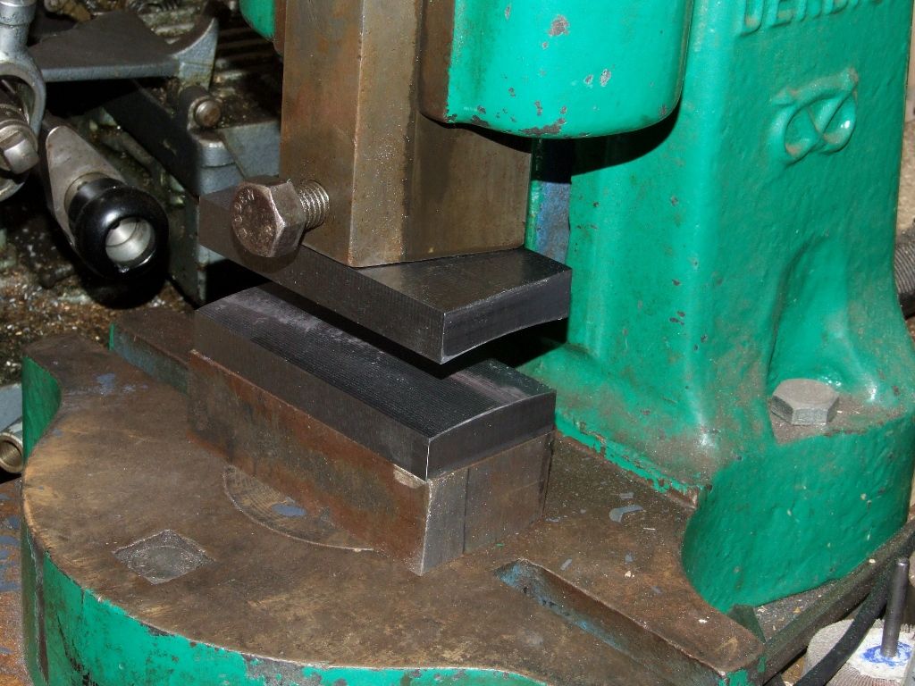

                      #435060
                      Anonymous
                        Posted by Phil H1 on 28/10/2019 14:24:05:
                        Black mild steel very definitely distorts when machined.
                        That's interesting; I've machined a lot of hot rolled steel and never noticed a problem with distortion. How did the problem manifest itself?
                        Andrew
                        #435063
                        Phil H1
                          @philh196021
                          Andrew,
                          Yes I am also puzzled because I see the same information about black mild steel being so stable on this site over and over again but it is not my experience.
                          Typically, it has happened when the edge of a rectangular bar has been skimmed (along its edge) or the face of a plate has been skimmed – almost exactly what you might expect of BMS. Another case was when I was trying to get 'clean' bright steel by filing a face of a 1" wide by 1/8" thick piece of black steel about 6" long. I achieved a nice clean shiny surface but it was banana shaped by about 1/16".
                          My point is that distortion can occur – it is not completely stable.
                          Phil H

                            #435065
                            Anonymous
                              I tend to use much larger sections, so may be they're less prone to distortion. When I made some press tooling for the flypress I skimmed the surfaces of hot rolled steel to form the blanks:
                              After the curved surfaces were CNC milled the tooling fitted together very well; certainly less than a thou or two gap:
                              But these blocks are about 5" x 2.5" x 3/4".
                              Andrew
