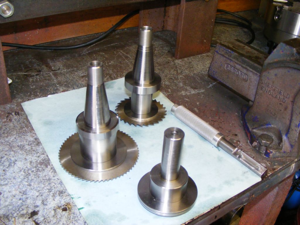

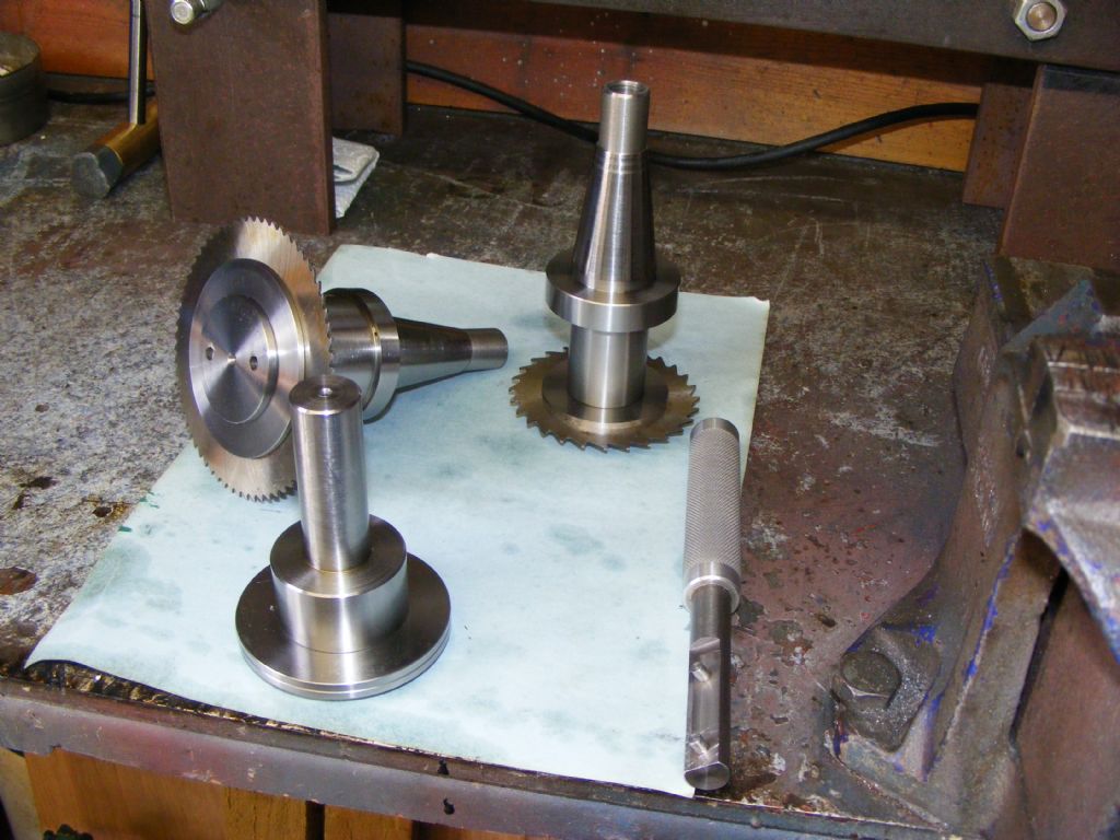

                              Carl, if you decide to do as you mention and finish turn the arbor whilst held in the mill spindle your mill head would need to be very well trammed in or else a taper will result. best if you did them in the lathe. A slight radial runout on the finished arbor is not so critical, but any Axial runout [wobble] is. Its the Axial runout that causes slitting saws to wander and jam up. There is no more than 0.005mm [Axial ] at the edge of a 100 Ø blade on these. They are made from EN24T steel, two are ISO 30 and one is straight shank. I have never need a key. Also you need to remember that when slitting deep,Slitting saw arbors the mill head MUST be trammed in very very close to perfect in the X and Y because if not, in a deep cut the blade WILL jam up.Slitting saw arbors
