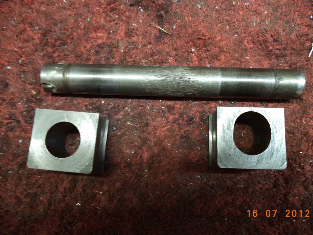

      I completed my Simplex three years ago and I've had it in steam for well over 100 hours in that time and its run very well.
      I decided to give it a good check over and clean the clack,injectors etc ready for the running season when the weather improves.
      And I found that one of the rear axle boxes had excessive wear, all the other axle boxes showed no sign of wear.
      As the ash pan sits over the top of this axle I thought that ash was getting onto the axle, but I have a brass guard over the axle that on inspection seems to be doing its job.
      All the bearings get a good oiling before I run so I don't think its lack of oil and the oil ways were clear.
      A friend said that he had seen this before on a 7 1/4" loco and suggested that it may be due to uneven axle loading from the springing, resulting in a lot of the weight being carried by that one axle causing it to run hot and wear. When I stripped it down I did find that one of the spring hangers had come lose which supports this suggestion.
      Has any one else come across this or has any other ideas as to its cause.

                      The axle journal on that side has worn down 0.4mm the other side has negligible wear.

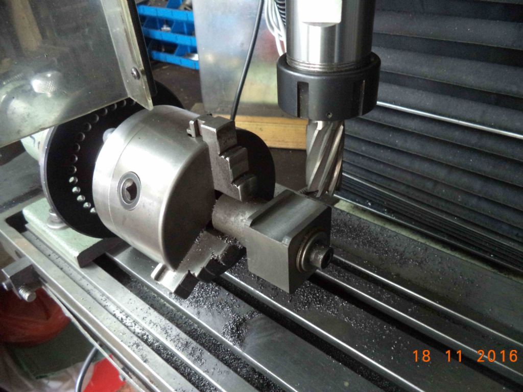

                          Using this type of a fixture, you could bolt up the axle block, of the pair, that has very little wear and dial it in to adjust the angle fixture. Then put the poorly worn one in, and re-bore it for bushings. Otherwise, the worn axle box leaves you very little for a reference to rebore it.
                          I did this for all of my axle boxes from the start and they turned out perfectly. Attached should be a photo of one of the boxes being bored and a photo with a test axle going through the bushed axle box and through the axle box on the other side.

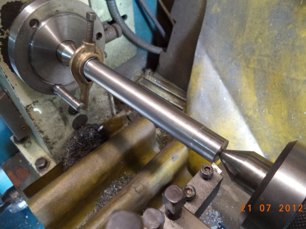

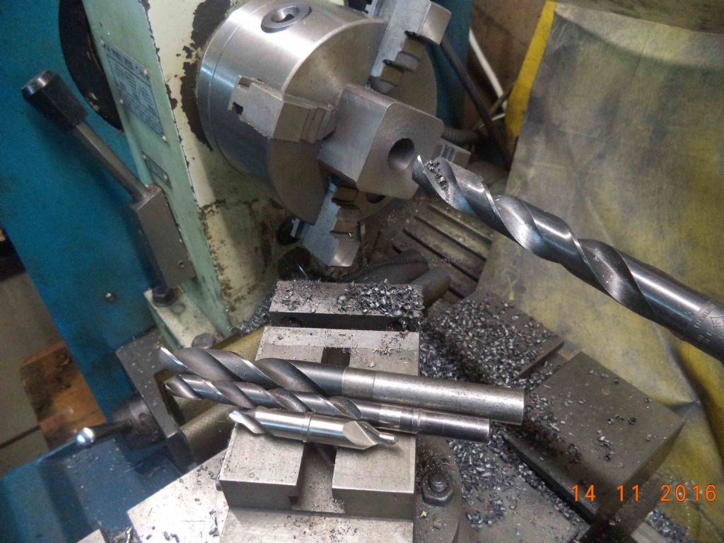

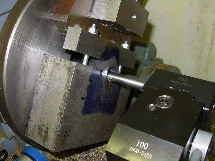

                              I use a slightly different approach to making axle boxes to David but both methods ensure that the critical feature of ensuring both boxes are aligned identical with the bore in the centre.
                              Using the four jaw I bore the boxes and finish off with a reamer.
                              Then I turn up a mandrel a close fit on the bore, I then centre this mandrel true in the spin indexer
                              Mount the axle box on the mandrel then mill the groove for the horn box taking the same amount of each side, so when the axle will be exactly in the centre of the horn.

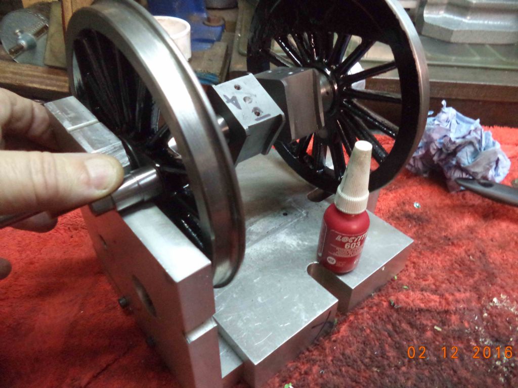

                              To quarter the wheels I use my home made quartering jig.

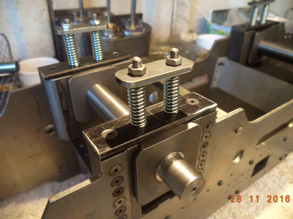

                                Nice photos. I have used nylock nuts on the spring studs, maybe something to consider for yours?
                                I have noticed, on my Super Simplex that the front end is much heavier than the back. I have had to put stronger suspension springs in the front, medium in the center, and lighter in the back. For me, this was the only way I could get it to sit level! Also, with nylock nuts, you can individually adjust the tension on the springs, and be sure they will not loosen.

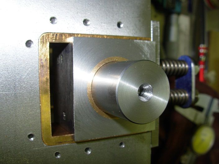

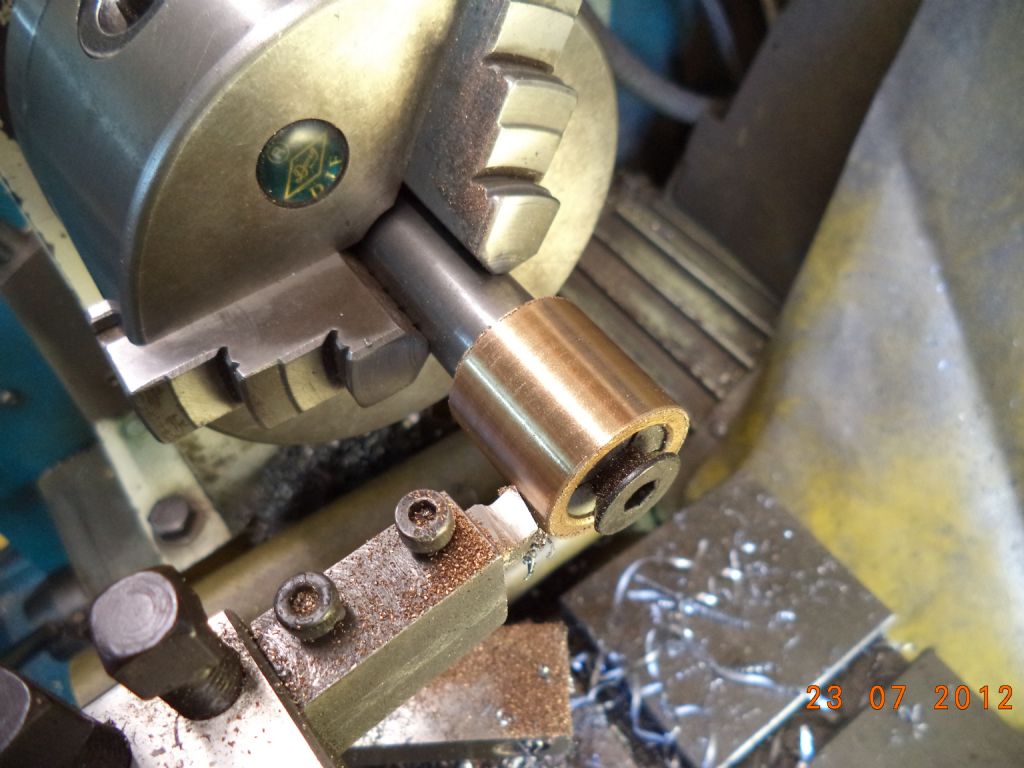

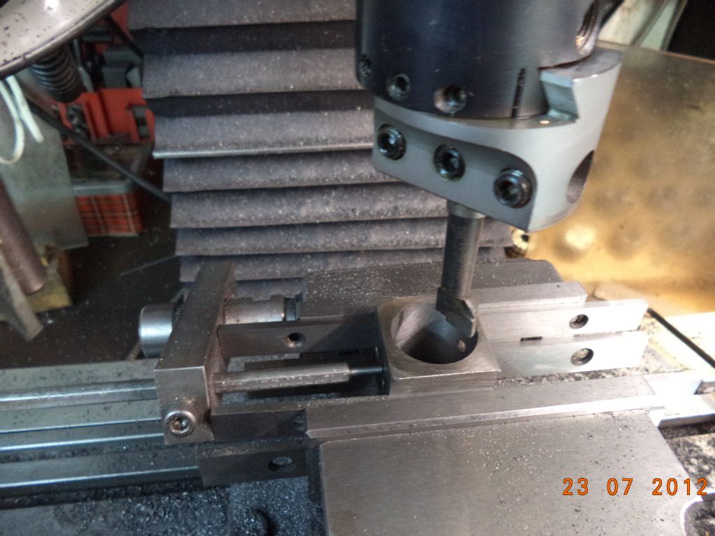

                                  I've repaired the worn bearing by pressing in a oilite bearing I did both journals just to keep that axle the same.
                                  This is how.
                                  First made a new axle.

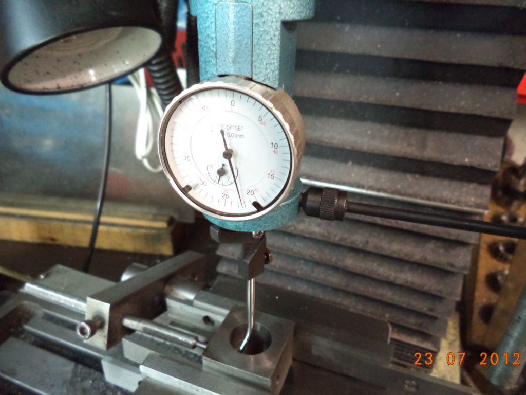

                                  Then centred the mill on the unworn axle block using a co-axle clock.
                                  Zeroed the DRO and locked the slides and with a vice stop
                                  Bored out the worn axle box.
                                  Then bored the unworn bearing out.

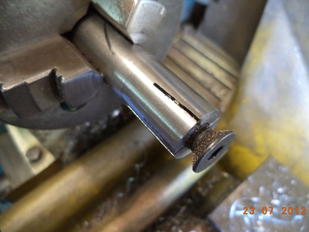

                                  The Oilite bearing were over size on the OD so made an expandable mandrel.
                                  Turned the bearing down for a tight fit in the axle box
                                  Pressed the bearing in with a spot of Loctite for good measure
                                  Job Done

                                        The axles had worn about 1 mm undersize, they are fixed to the wheel with loctite and a grub screw along the joint of the wheel I when I replaced the wheels I put in a bigger M4 grub screw, in the same location.
                                        The good axle box had about 0.1 mm ovality when I clocked it that was the movement of the clock that I got so I figured that would be acceptable.
                                        I secured the thread hanger studs in the axle boxes with thread lock and used nylock nuts that shouldn't come undone, but I will keep a close eye on them.
