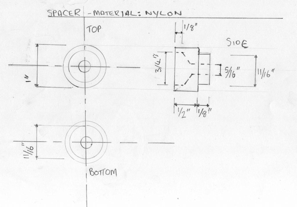

      Hi. I hope this post is kosher.
      If I cannot source any spacers that I need, then I'll have to try to get some made.
      I attach a picture of the spacer, with dimentions. Originals are porcelain and are used to hold the meter board to the wall. I thought nylon would be a good substitute.
      If anyone is interested in making a dozen for me, then please inbox me. I was thinking to pay £1 per spacer. So, you would get £12.
      I'm near Wakefield, West Yorkshire. Nice if a local would make them.

          Hi Richard,
          Just a hint but I think you may need to consider the cost of 1" nylon rod…
          **LINK**
          Even in God's Own County it's not that cheap.

            Do not try to do anything with the meter it is the responsibility of the supplier electricity network operator (the company you pay your bills to is responsible for the meter and the isolation device/s is down to the electricity network operator) , if the board is falling to bits or has come away from the wall then contact your supplier. If you want it moved, again it is a job for the supplier electricity network operator, I know this as I recently had my meter moved from what used to be the kitchen to an external box.
            Spacers are available from electrical wholesalers like CEF.

                Nylon also has the ability to absorb moisture

                        I made a board for the Sparks to mount a new consumer unit in my shed. I made some plastic stand offs for it but they were much simpler than that.

                          If it's just a spacer which won't absorb moisture then how about these…
                          **LINK**
                          10 for £1.20.

                                  You need to buy plastic from a plastics supplier: LINK Works out at three quid for half a metre. Buy £50 and it's free shipping or I just collect as I am going past.

                                              Make items from Nylon and then boil them and they will not absorb moisture or swell!

                                                Hi. I'm wanting the consumer unit on a suitable board above the DNO's board. And I'm wanting to achieve a sort of "match", Ahem. I know, I'm a bit finicky. . Anyway, someone can always make me an offer.
                                                Tempted actually to get myself a lathe. I could make them myself then, and do other useful things.
                                                Wonder how much I might have to spend to get some lathe that would have spindle bore of 1".

                                                  A lot more than the cost of a hacksaw to chop the rod into say 3" lengths that would fit into the chuck body.
