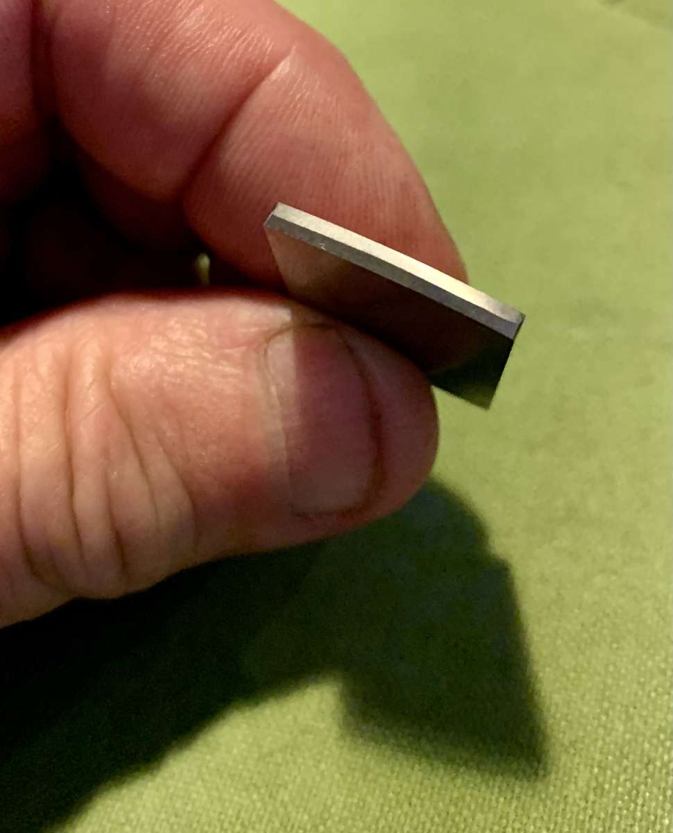

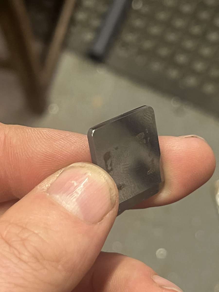

                    Just been in the workshop.
                    The one thing I did do was just run the corners on a diamond plate to round them.
                    Out of the box:
                    IMG_6930
                    Rounded slightly:
                    IMG_6931
                    This helps stop them causing a gouge when you inadvertently catch a corner.
                    The Sandvik inserts have a mirror finish on them, the eBay ones probably need work to get there.

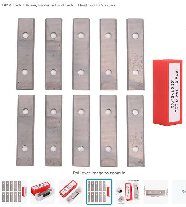

                    peak4
                      @peak4
                      On flatline Said:
                      Bill, many thanks for the ebay link, certainly an attractive price…. I think my Sandvik is likely to arrive sans-blade, so I may well give these a try👍
                      I wasted a considerable amount of time & money looking for a suitable grade of carbide to make a hand scraper during the first Covid lockdown.
                      The ones I linked to have one appeared since then.
                      What I did find, for making a small scraper for internal dovetails, was some carbide blades marketed for Linbide paint scrapers, which seem to take and hold an edge OK.
                      This is an Amazon link for some which look identical, in both shape & outer box, but I’ve no idea if they are the same grade of carbide as the ones I found

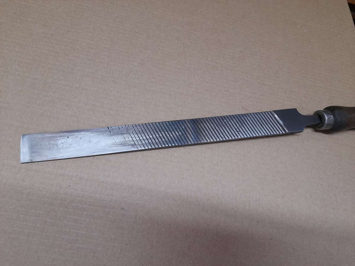

                              I have had one of these for many years, they are great for roughing out but as already said more difficult to sharpen.
                              Don’t wish to be thought “old fashioned” but, my best scraper was made frome an old millenicut file, much easier to sharpen and much more delicate “feel”.
                              Andy

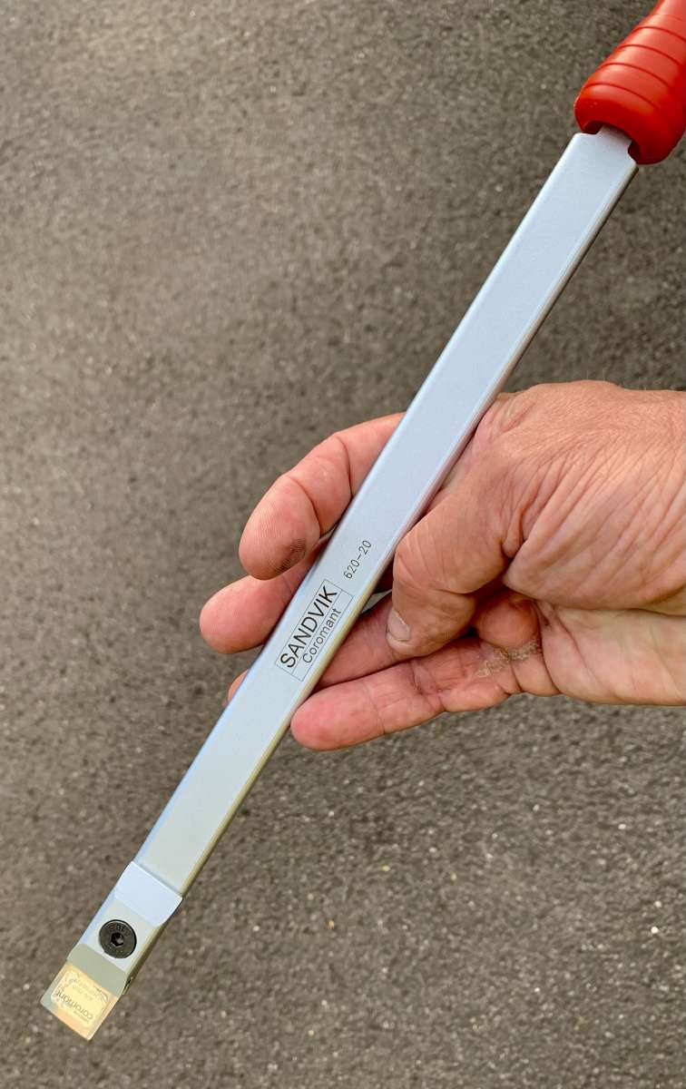

                              flatline
                                @flatline
                                My scraper has arrived from Sandvik, and it came with a blade which was a bonus given the cost of the tool… 😎👍

                                    #800921
                                    Bo’sun
                                      @bosun58570
                                      Pl
                                      IMG_5957
                                      IMG_5957
                                      Please feel free to correct me if I’m missing something, but the holder looks simple enough to make, and would even benefit from a tactile wooden handle.  Assuming I’ve been looking at the same tool, £80 or thereabouts seems a high price for what it is.  Although, if it does come complete, most of the price seems to be for the insert.
                                      #801010
                                      flatline
                                        @flatline
                                        I paid around £70 direct from Sandvik. The blades are £40 each (so £30 for the tool itself), and are sold in a box of 5… 🫣😳

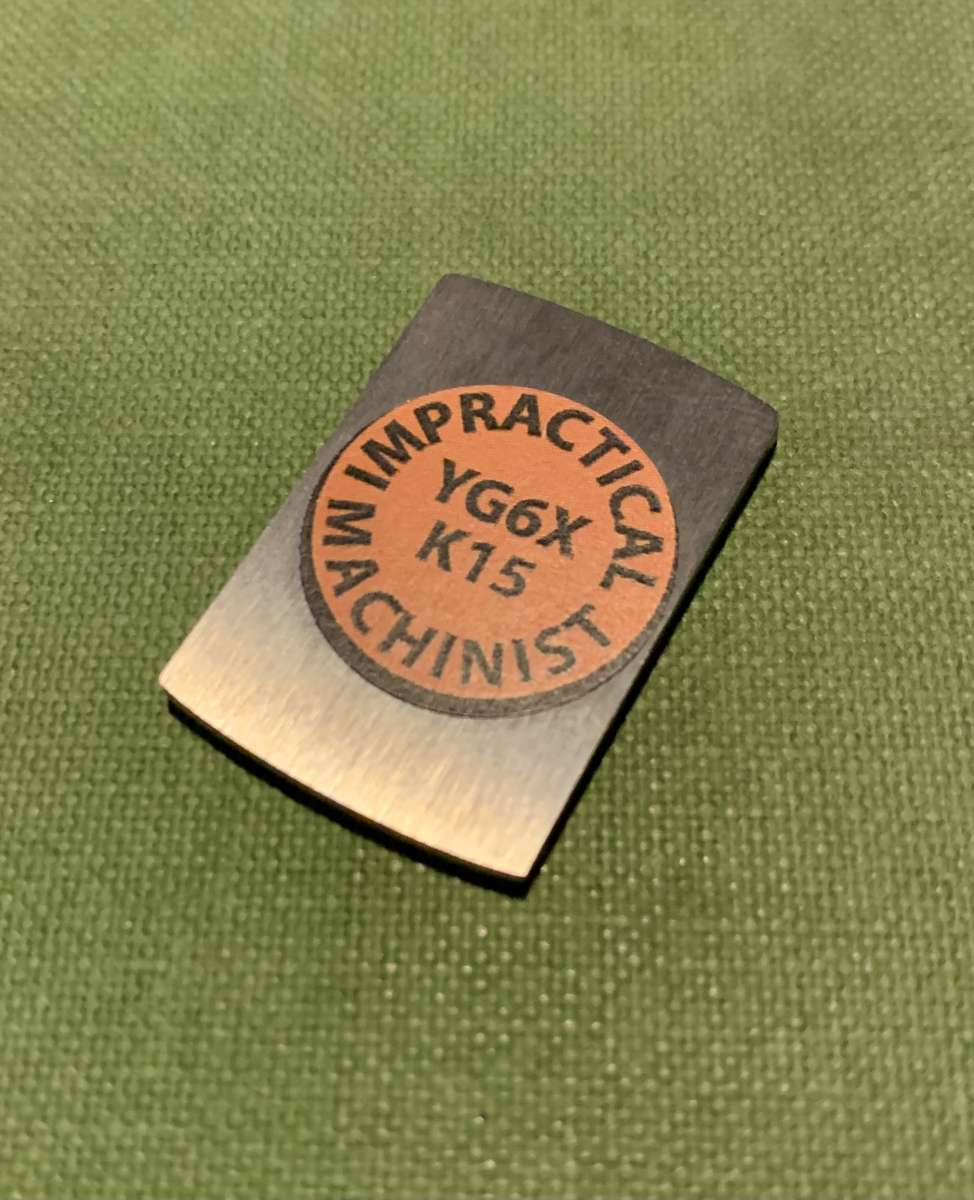

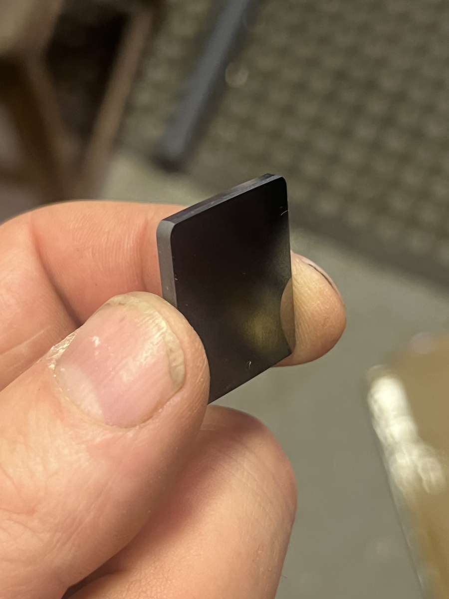

                                        flatline
                                          @flatline
                                          Today the eBay blade arrived, from ‘impractical machinist’ …. At around £20-quid probably around half the price of a genuine Sandvik item…
                                          I have yet to give it a try, but it looks well finished, with an unknown radius (Sandvik’s are square) and what looks like a decent negative relief…
                                          I am looking forward to seeing how this goes… 😎👍
