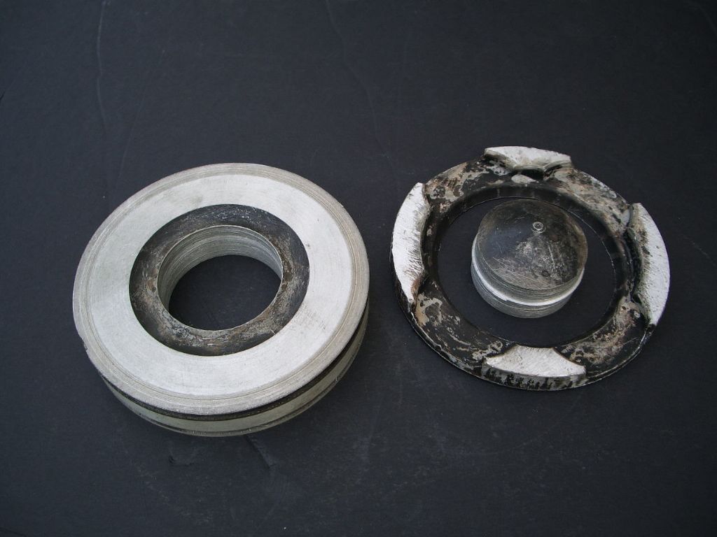

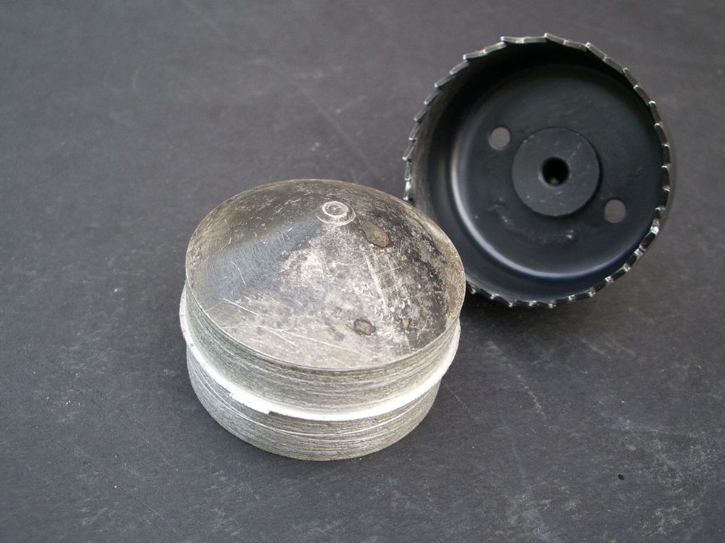

                    Hi Petro1head, I used a holesaw to cut the middle out of an old lorry piston blank that I'd previously cut off. It was only about 60mm diameter, but I had to cut as deep as I could from one side and then turned the blank around and finish the cut on the other side as the blank was about 25mm thick to the high point. I removed the pilot drill in the holesaw and cut at a faily slow speed with plenty of cutting fluid. Once cut it gave me a usefull blank without a hole in it.
                    Regards Nick.

                      A hole saw is normally fitted started with a drill that drills and centres the saw at the same time, however the drill is fairly weak compared to the lateral forces imposed by the hole saw, allowing it to jiggle.
                      If you fit a solid piece of steel Ideally high tensile steel in place of the drill in the hole saw, and pre drill the centering hole, and then lubricate the pre drilled hole well prior to making the hole with the saw, you will find the finish achieved by the hole saw is better.
                      Hole saws are not all created equal the sizes are nominal at best. If you have several saws the same size they all will be slightly different. Do a test hole to see if it is right for your job.
                      When drilling deeply into material the teeth will clog very quickly, particularly with aluminium, you have to withdraw the saw very often to clear the swarf built up in the gullets of the teeth. if you don't it will jamb and you may overheat your tool or break it.
                      Watch out for any blue chips when cutting steel…..You are probably going too fast! If the saw teeth themselves are blue, it is probably too late….Go out and buy another saw. hmm
                      Coolant will help keep the saw and work cool and reduce the tendency of the chips to weld themselves together and to the tool.
