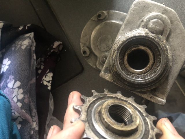

            Could you show some picture of the arrangement please Ian Whittaker, just to make the arrangement clear and useful to pass on to others if needed?

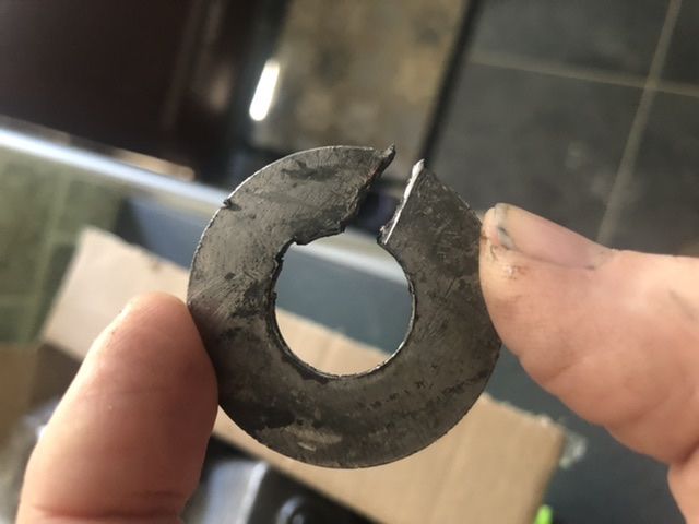

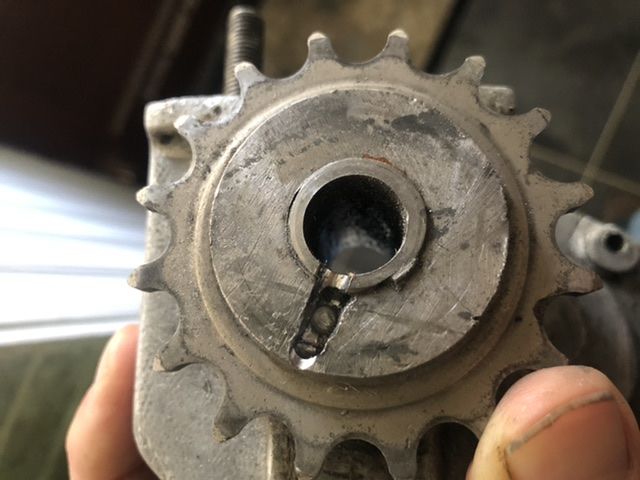

              e9c8b05d-c272-4af5-a0ac-cb62c7b42564.jpegece8993d-5f4d-44bc-ad4d-f8b95f88bbb4.jpegFYI Images of breakdown of Albion Gearbox

                  Metal locking nut wasn’t required for next stage hence why I drilled it!! The only thing is gear is locked on the thread by a metal insert, once removed, it can be removed from the thread by locking the inside cog (to stop it moving) then tapping the outer clog anti clockwise very carefully!!

                    Good result, a strange early system, not what most of us expected.
