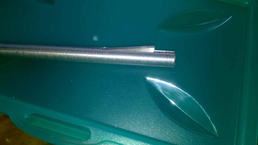

            Hi Iain,
            I made a small adjustable broach to make such keyways, see:
            http://mikesworkshop.weebly.com/small-hole-slotting-tool.html
            Mike

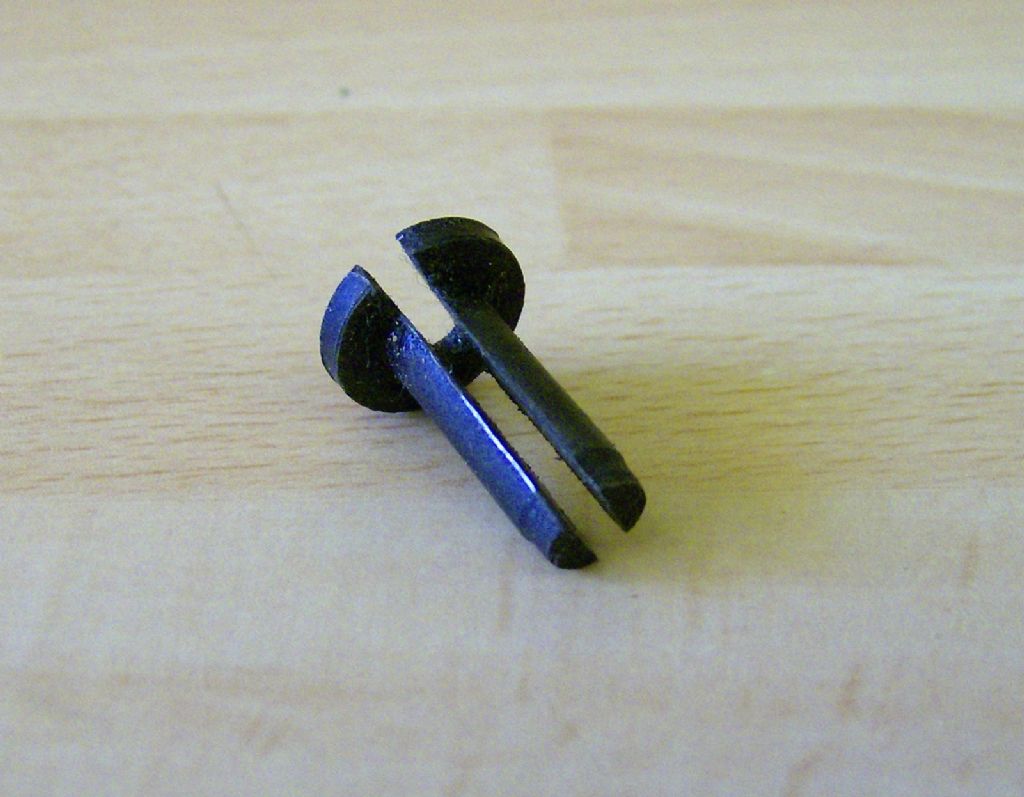

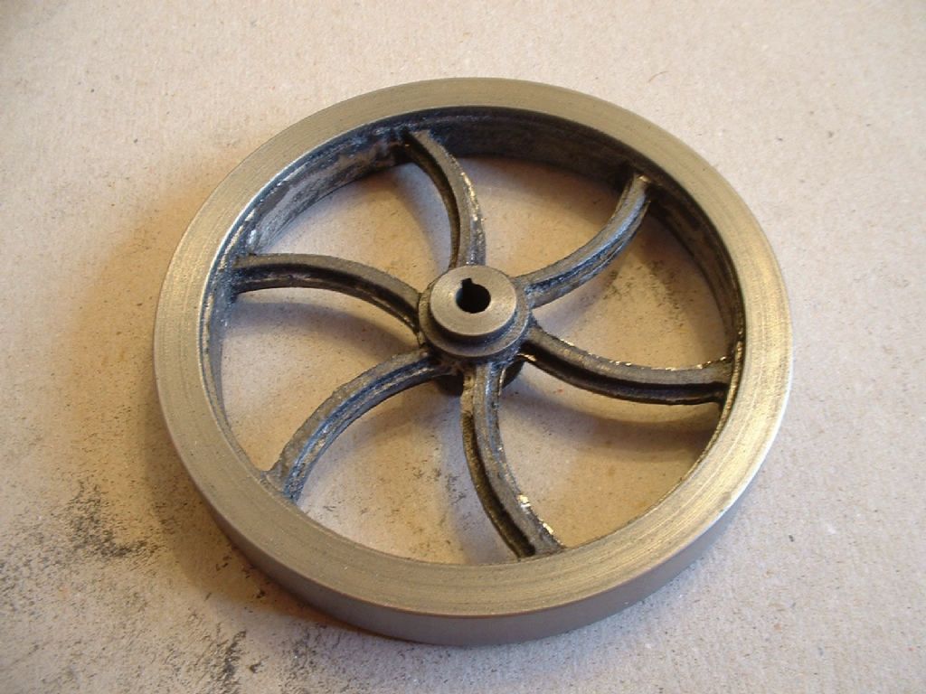

                        I've made small keyways by turning a 'top hat' to fit the bore, then cutting a slot to match the required keyway. Use silver steel , harden but don't temper.
                        You can then use the 'top hat' as a filing guide – bearing in mind you can file the top hat away if you aren't careful with a diamond filel. I've made 1/16" keways in 5/16" bores this way.

                            Iain Downs
                              @iaindowns78295
                              I ended up following Michael's (Cox) approach and made this.
                              It worked pleasing well and I've got my gear on the mill feed.
                              I could have gone on to see if my little motor would now turn it, but I think I could do with rebuilding and freeing up the table first. And also, having had a little success, I thought I would quit whilst I was ahead!
