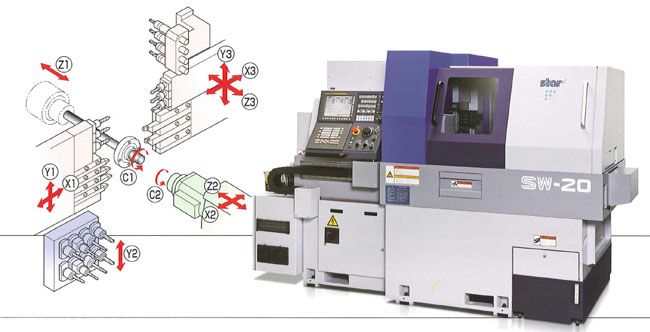

                                                      Today, engineering is deep into CAD/CAM, and 'our' sort of engineering is a niche. True it's important for prototyping & ad-hoc requirements etc, but what Model Engineer's do isn't mainstream. Technical Colleges don't teach machining because Industry has little need for those methods.
                                                      Plenty of machining still going on in the UK, but it's moved on to CNC and especially Machine Centres and Work Centres. In a Work Centre jobs move automatically through a group of Machine Centres. These have many axes, and are almost entirely automated. Myford, bless 'em, were never in this market.
                                                      Most Machines Centres are far too big for a home workshop, but this might do.
                                                      The Star SW20 has 11-axes of which 3 can cut at the same time. Weighs 7100lbs and can drill, tap, turn and mill. The main spindle and sub-spindle are driven at up to 10000 rpm by a 5HP motor. Front tool carrier has 4 turning tools & 3 rotary. Rear tool carrier has 6 turning tools & 3 rotary. The Back-working tool-carrier holds 8 turning tools and 4 rotary tools. All three carriers have 1.6HP at 8000rpm.
                                                      Most of the skill is at the design stage, not at the machine. The tool is operated remotely or from the console pictured. No-one cuts metal by hand or sharpens HSS!
                                                      These things are fairly useless in a home workshop. My Chinese Lathe & Mill are far more fun. But for manufacturing, the day of the manual machine, however well-made is over. Difficult to make a living out of them.
