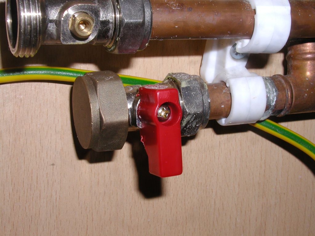

      New washing machine arrived today. Old one had twin hot and cold water feeds. New one just has a cold feed. So I need to blank off the hot water feed. It has an inline check valve but there is still a slight weep even when its turned off.
      So I need to buy a blanking nut to seal the end of the check valve. The brass pipe attached to the check valve is 15mm OD.
      SWMBO wants to wash tomorrow as we’ve not had a washer since last Saturday and we’ve got a 2 and 6 year old who need their school kit cleaned. What size blanking nut do I need to but tomorrow when Screwfix open?

          Hi I commisterate but your supplier should have supplied one these are usualy a BSP thread and very standard go to your local builders merchants and explain take the blue pipe along and they will give you a suitable blanking nut go home say job done and then back to workshop with SWMBO singing praises.

            Hi John, if it is anything like the photo below.
            It should be 3/4 BSP I believe.
            Take a look at the link below.
            Regards Nick.

                Yes I can confirm it’s 3/4″ BSP
                Also make sure there is no drip around the “tap” shaft as these type of fittings can leak from there once disturbed after a period of time.
                And if buying from a shed make sure no one has pinched the rubber disc washer from inside
                J

                  JasonB makes a good point. If the tap is weeping then it is a sign that the seals are worn so the “O” ring seal on the spindle is likely to leak as well. Why not just replace the tap with a stopend fitting. The threads on most compression fittings are the same so I would suggest that you leave the original nut and olive on the pipe. Screwfix sell 15 mm stopends in packls of 2 for £2.49 ( Code: 65021) and Toolstation sell them singly for 95 P
                  (Code 87972) When wee replaced our washing machine I used the nut and rubber washer from the old flexible pipe and made a brass disk which fitted in the nut with the rubber washer between the disk and the end of the tap. (The nuts from some garden hose fittings are the same thread.) To make the disk put a heavy centre pop mark on a piece of brass, cut it to a rough circle then held it between a live centre and a block of wood in the chuck and turned it to size. I think I also put some double sided adhesive between the disk and the wood. I think I also turned a small shoulder on the disk to locate it in the hole in the nut.
