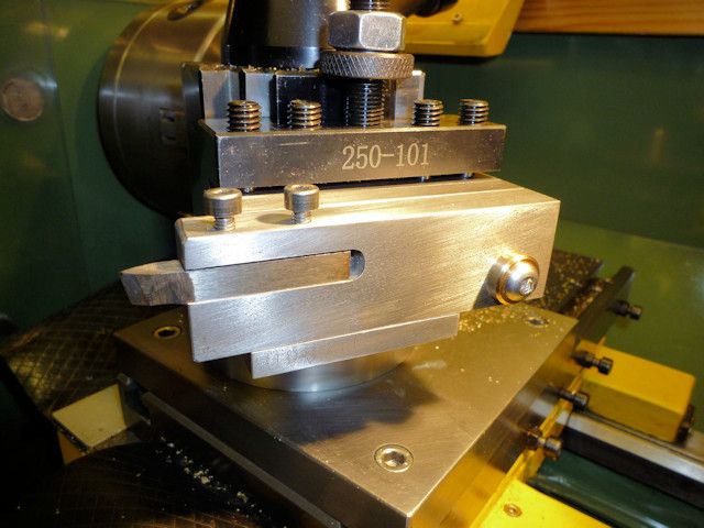

          I can recommend the use of a flip-up tool holder for use on a metric lathe. Provided the lathe has reverse it makes things quicker and saves losing your place winding the cross-slide or top-slide in and out.
          Details of mine *** HERE *** other write-ups are available.

                This tool retractor can be used without the relief groove as it retracts away from the workpiece.
                Lever operated retractor

                  Posted by Journeyman on 14/04/2020 10:27:32:
                  Posted by SillyOldDuffer on 14/04/2020 10:14:00:
                  … Is a metric TDI worth having? My answer is 'maybe'. I use mine when it's obviously faster, otherwise I don't bother with it…
                  Excellent idea! I've downloaded the PDF plan. If I've got stock, I'll make one. (Was getting ready to visit my local metal Emporium when the lock-in started.)

                    Dave: Thanks for the plug!
                    Derek: Don't know why you cant see the images, they are all self hosted, no PhotoBucket involved. Try ctrl F5 key combo to refresh the browser.
