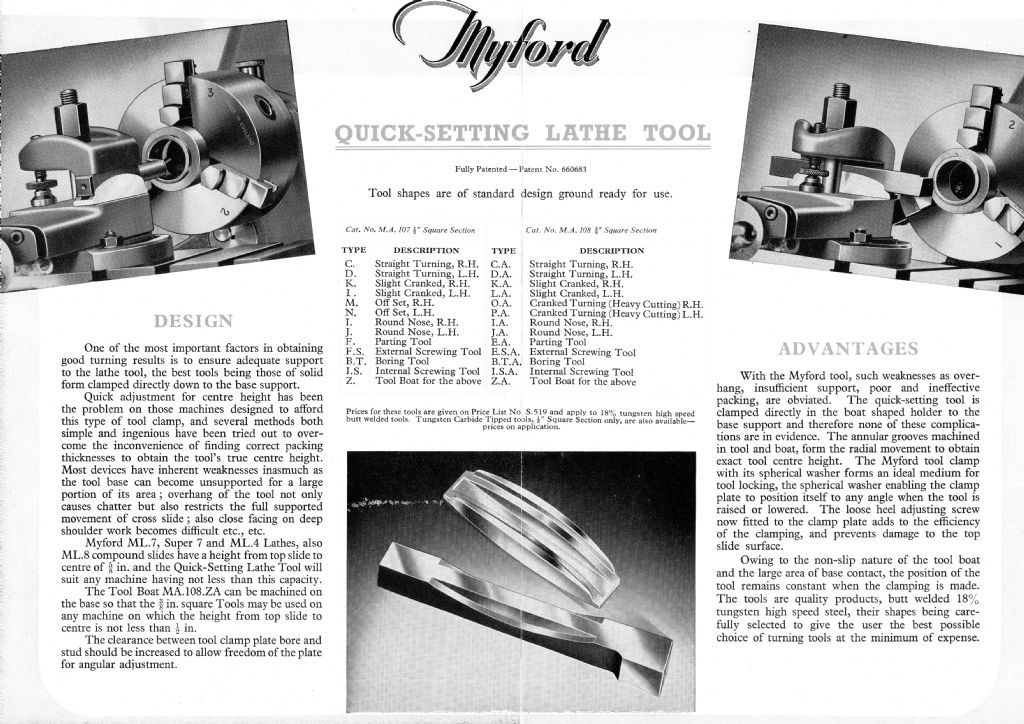

                                  Myford leaflet on the quick-set tooling – helpfully shows Myford's "numbering" system

                                    Robbo and Fury: Thanks, the bridge or boat was in the tool post clamped with the ES tool in place when I got it. I just didn't include the boat in the photo. Clever design and I hope for most uses the original tools will do me fine as it allows quick swapping.
