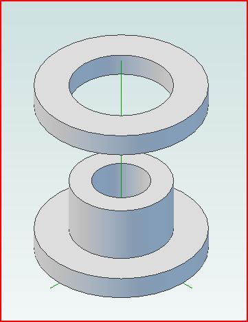

        Hi all
        I'm hoping to mount a metal U-bracket on a 5mm steel rod so that the bracket can freely rotate on that rod.
        The rod should protrude about a few millimetres into the bracket. Does anyone know of a good way to mount the bracket on the rod so that it won't slide along along the rod? Would some kind of a stopper be needed?
        Any help appreciated.

                    Hi Ian,
                    Actually, my original plan was to use two e clips. Do circlips and e clips serve different applications? The bracket is rotated and the torque is around 0.3N-cm.
                    My current idea is something like this
                    (bracket end) E clip, washer, teflon washer | teflon bushing | teflon washer, washer, E clip (rod end)
                    where | xxxx | denotes the bore in the bracket.
                    I wonder if a washer is needed between E clip and teflon washer? The clip is held fixed by the groove, so it wouldn't exert much pressure on the teflon washer, right?

                            Michael's will be easiest as no groove is needed provided you can get to the other end of the rod to slide the inner one on.
                            If not stick with your idea of E-clips, large flat washers and then teflon washers if you make one washer a "top hat" one with a spigot then that will bush the hole in the bracket too.

                              I used the term circlip in a generic sense.
                              Since you know the operating speed, loading and presumably other details, what you end up using is going to depend on what materials are involved, what engineering facilities you have and also how much you want to spend!
                              Mainly though its the end use or purpose that will determine what is the best approach.
                              How much play/looseness can you tolerate in the joint, does it matter if it a rattling fit, there might even be a rattle (noise) that detracts from the final product's acceptability, Slightly preloading the already mentioned PTFE washers would prevent noise.

                                  Right. How come flat washers are needed to sit in between of e clips and teflon washers? Can the e clips not push against the teflon washers directly? The grooves should stop the e clips from moving – right?
                                  #230306
                                    Well you obviously thought they were needed as you thought of it first!
                                    My thoughts are that E-clips are quite small dia so could start to cut into the teflon washer. What was your reason for suggesting washers?

                                      Well, there really wasn't a clear rationale, but I thought it might be better for a piece of irregularly shaped metal to press on a metal washer rather than plastic (teflon). I haven't used teflon washers before, so I'm not sure how durable they are.

                                                    It's meant to be a grip for a camera. It'll do about 30,000 rotations during its life. Yes, it can be lubricated with grease and there won't be a great deal of dust.
                                                    Couldn't a teflon bushing do rather than a bronze bushing?

                                                      For the camera application described, PTFE (teflon) washers or PTFE washer and bushing would probably be fine. Similar parts could be made in bronze if need be, as drop-in-replacements or an upgrade. JD
