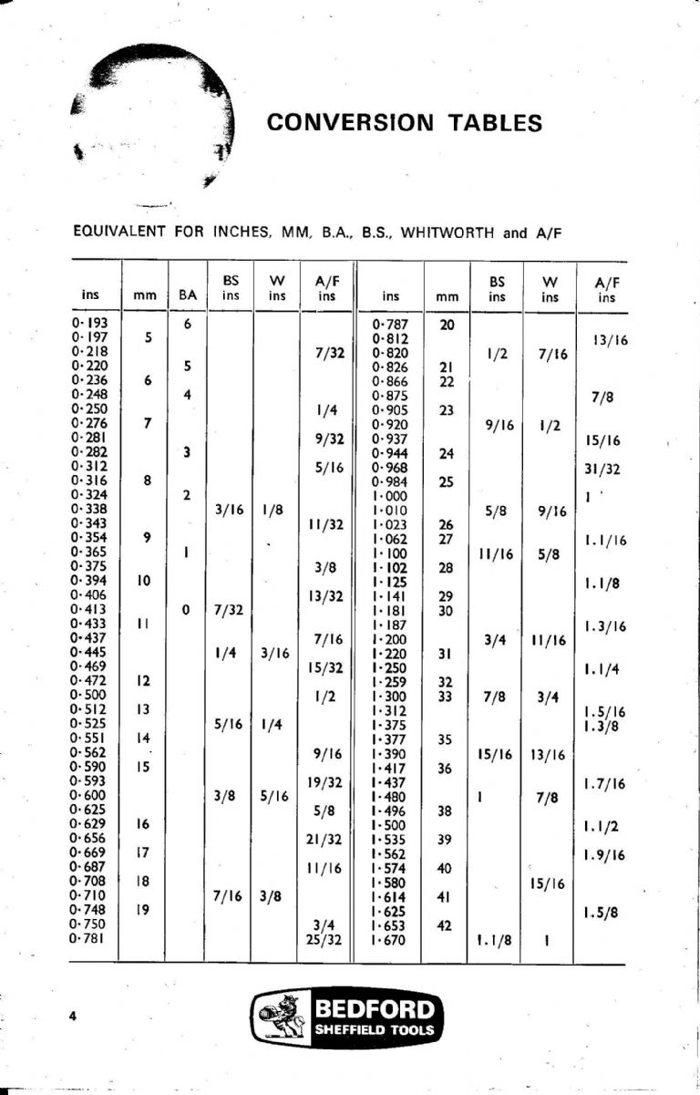

      Swarf, Mostly!
        @swarfmostly
        Posted by ega on 12/12/2018 17:28:09:
        This extract from an old Bedford catalogue may be helpful:
        SNIP
        Sorry about the bleed-through from the reverse!
        A trick that usually works to stop bleed-through is to put the target document on the platen of the scanner or photocopier and then lay a sheet of black paper on top of it, then close the lid.
        Best regards,
        Swarf, Mostly!

              Posted by ega on 12/12/2018 23:18:22:
              The platen does, of course, have a cover but it is white. I wonder why black is better in this case.
              The white provides best contrast for single-sided originals
              The black masks the original contrast on the reverse, so the scanner is seeing black on [reasonably even] pale grey instead of black on a pattern.

                        I'm not sure why there is so much discussion about spanners. It matters not a jot what the label on the spanner says, its across flats distance needs to be just a shade bigger than the a/f measurement of the nut.

                              You were asking the correct spanner sizes. The myford spanner’s that came with my ML7 were 1/4 WW x 3/16 WW and 3/8WW x 5/16 WW. They were also stamped with their respective BSF sizes which were 5/16 BSF x 1/4 BSF and 7/16 BSF x 3/8 BSF. I hope this helps. Alan

                                    Posted by John Haine on 14/12/2018 11:10:54:
                                    Because when ordering online it is so much easier to order a 5/16" BSF spanner than for example "I need a spanner 15.25mm AF or slightly smaller which I can mill to size"
                                    Posted by Norboy on 14/12/2018 13:32:51:
                                    Alan
                                    Thanks Alan,
                                    That is exactly what I was looking for, and thanks to everyone else for the helpful suggestions.
