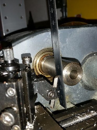

      Is there a guide to centering tools to workpiece using a quick change tool post?
      I guess the same would apply to using a DTI at initial setup in a tool post?
      There is a picture of a DTI in use in the manual but I could not find a device to hold it, not of the shelf.

          There are a few ways that a lathe tool can be set to centre height.
          One way is to face the end of a piece of metal held in the chuck. If a pip remains, the tool is not at centre height. Retract the tool, turn off the lathe, adjust the tool either up or down by about half the pip diameter and try again until no pip remains.
          Alternatively you could use a steel rule trapped between the tip of the tool and the workpiece. With the lathe off, hold the rule vertically against the workpiece, gently (so as not to damage the rule) feed the tool in trapping the rule between the tip of the tool and the workpiece. If the rule leans towards the back of the lathe, then the tool is too high, if it tilts forward then the tool is too low, the rule will be vertical when the tool is at centre height .
          You could also consider making a centre height gauge. Not only would you end up with a useful tool, but could also be a worthwhile learning experience. Geo Thomas described such a gauge in the "The Model Engineers Workshop Manual" a book well worth seeking out. Hemingway also do the gauge as a kit seen here

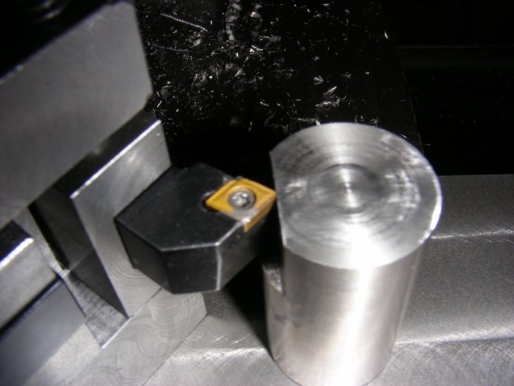

                            Yes, a Centre Height Gauge really IS that useful.
                            In my shop it gets used every time that a tool is changed, or sharpened. Using a tool that is off centre does not give optimum cutting or surface finish.
                            Having measured the eccentricity, and maximum height of a round bar, (Silver Steel of known diameter) those doimensions are allowed for in setting up a pack of slips, to which the gauge is set.
                            Occasionally, I have even found that changing a carbide tip can mean that the edge is very slightly off centre, (with a clean holder).
                            Maybe I am too much of a perfectionist, but I do not want a pip of any size on a faced component. Where I was trained, and the other Companies for which I worked, "near enough" was not good enough.
                            Getting it right first time is usually a lot easier than putting it right later on after things have gone wrong.

                              I use a digital height gauge also. Using CNC with calibrated tools, all the tools need to be at centre height for the offsets to work properly at all radii. The only way I have found to do this accurately is to measure the height and keep adjusting it until it measures right.
                              If you have a gauge that has a gauge surface above the tool, it is difficult to guarantee that the tool isn't a bit too high and slightly lifting the gauge.
                              So I use the height gauge, lowering the measuring bit until it touches the cutting edge while holding the gauge firmly down to the bed.
                              To measure your exact centre height, turn a short length of bar to say ~12mm dia, measure with a micrometer whilst still in the chuck, divide by 2 to get radius, then use height gauge to measure to the top of the turned length from the bed and subtract the radius. For my Super 7 the answer was so close to 76.2 mm (3.5&quot as to make no difference.

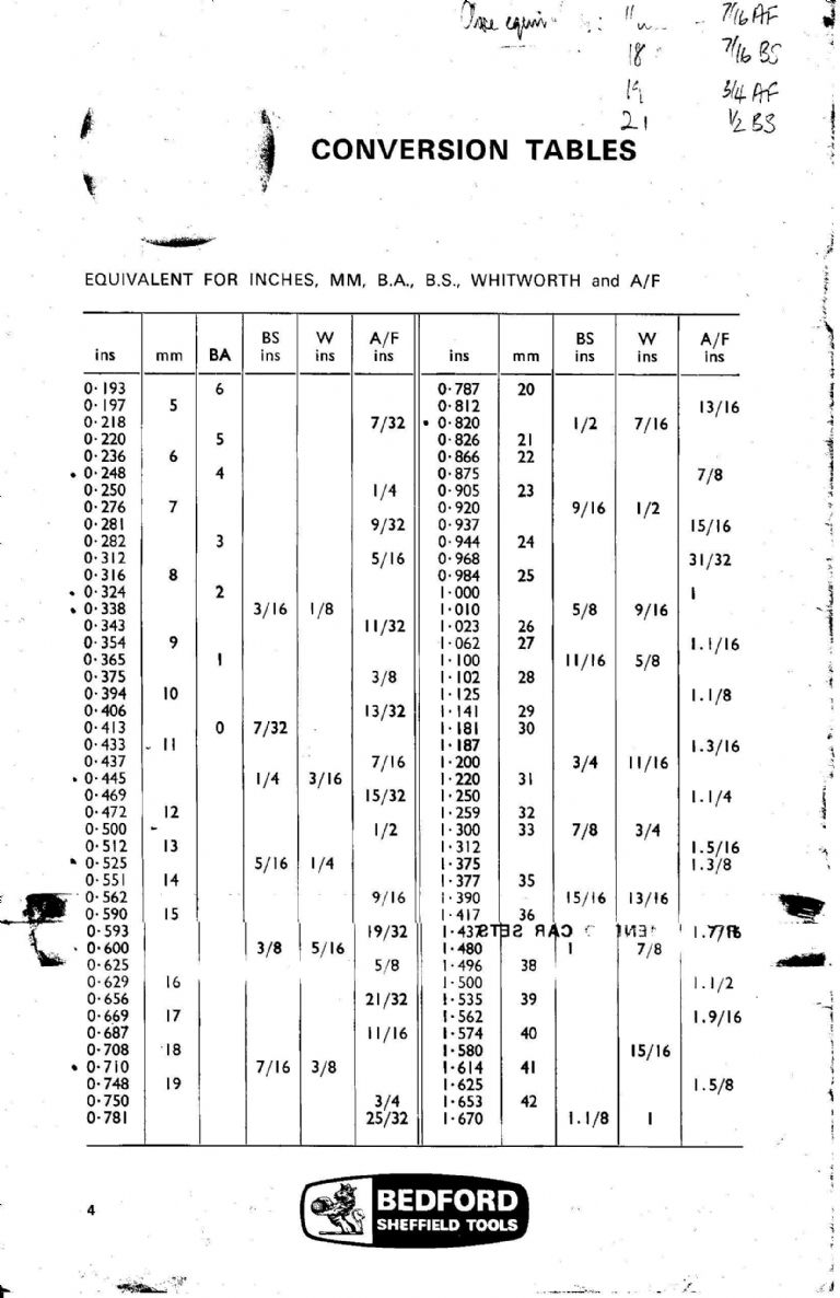

                                As nobody else seems to have commented on spanners (aka 'wrenches' ), here's my two penneth:
                                The rule of thumb on most ML7 machines is that all threads below ¼" are B.A. and all threads of ¼" or bigger are B.S.F.

                                      Your normal inch spanners will work fine with BSF bolts.
                                      It's Whitworth that you have to experiment with
                                      #385187
                                      Maurice Taylor
                                        @mauricetaylor82093
                                        Whitworth and BSF spanners are the same.AF spanners do not fit BSF , some metric ones might fit.

                                                  This extract from an old Bedford catalogue may be helpful:
                                                  Sorry about the bleed-through from the reverse!
