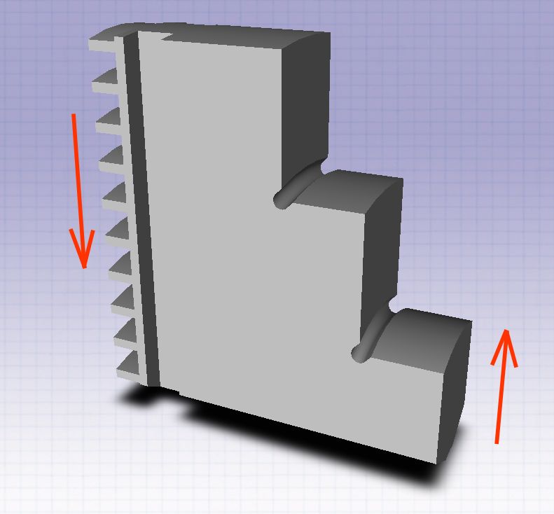

          Honing with a brass rod and lapping compound, I acknowledge, was a cheap and perhaps less desirable method of three-jaw ‘rectification’ and, upon reflection, hardly necessary anyway.
          Not wishing to labour the point, I would however suggest that given any degree of play between the jaws and the chuck body, and a respectable NGP in the vertical direction, the jaws would tend to rotate/deflect (anti-clockwise in this diagram),
          such that there would be more metal removed from the back of the jaws than the front, i.e. the opposite of bell mouthing. I would not care to determine what the results would be from lateral (jaw) twist.
          "Twist'ut jaw and lack'ut theen" was a phrase I recall, although my vernacular spelling might be a bit suspect.
          Given the need to carry out such 'improvements', I would certainly favour Old Mart’s hole-drilling technique.

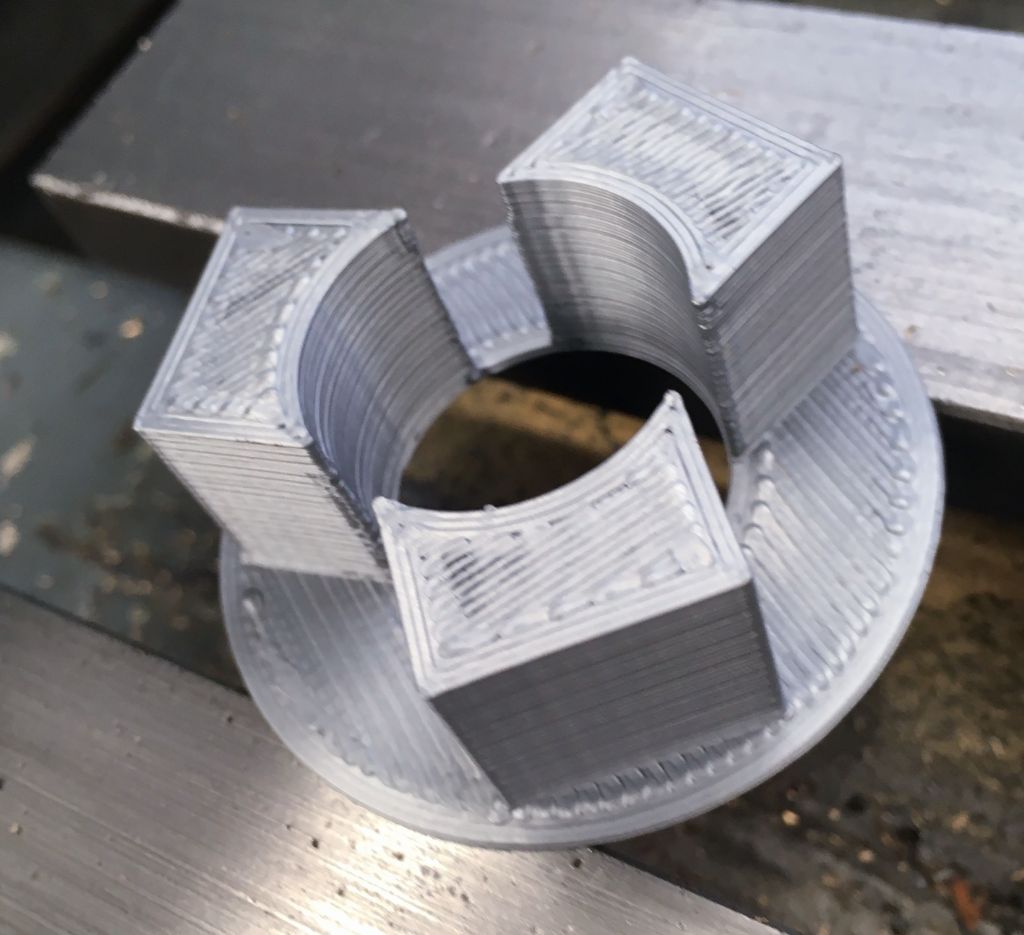

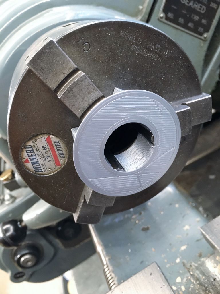

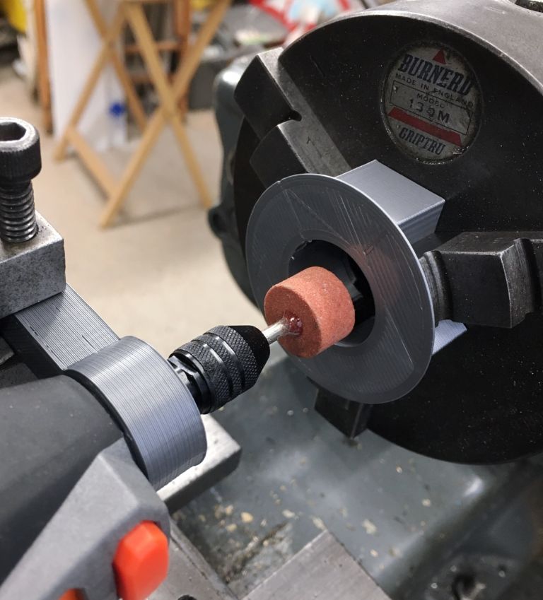

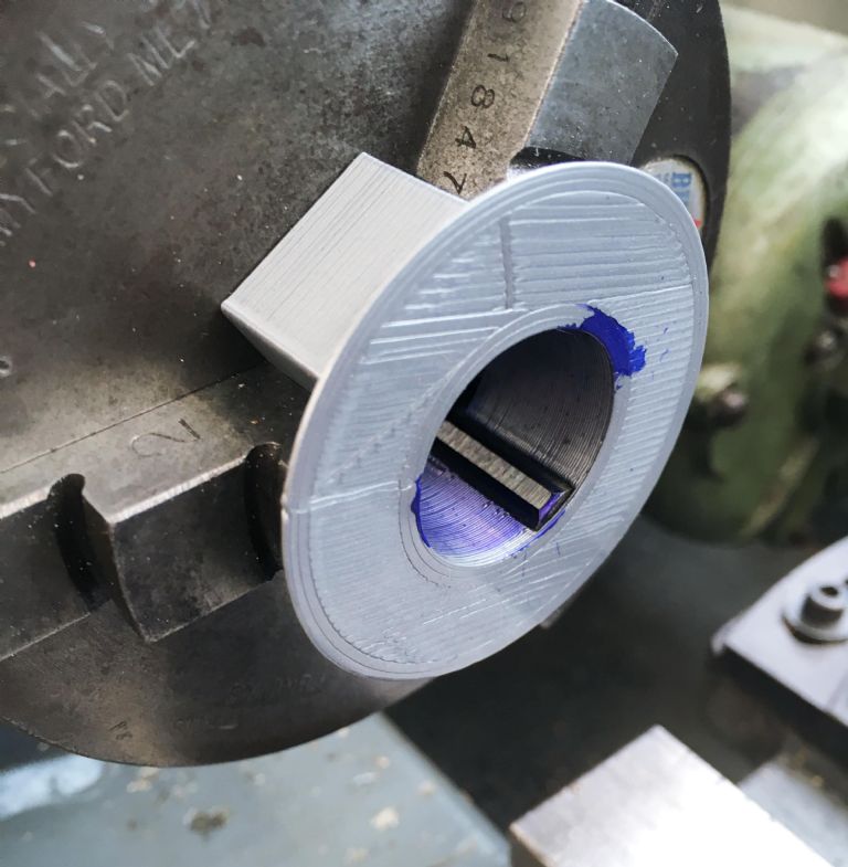

                A bit late on the scene here, but I also need to grind my chuck jaws true. All the advice made it clear that the jaws should be loaded during the operation. I looked around for availability of a Hopper's clover leaf plate but found nothing. Should I make one? Then I was inspired by Alan Jackson's solution, but accepted it must be a bit fiddly to set up. Clearly the jaws needed to bear on their angled faces allowing the 'bite' surfaces to protrude for grinding. Decided to try a design in plastic. No milling or drilling, just a bit of 3D printing. The plastic takes quite a load without any distortion. Oh! and the mount for the Chinese Dremel is plastic too. So before I spin things up, can anyone see a problem with this set up?

                  Tried this out today. Seems to work and hope it's improved things..

                    Adrian, 3D printing is putting a 21st Century twist on a traditional technique. Love it!
                    I reckon there might be a bit of a market for such a handy thing.
