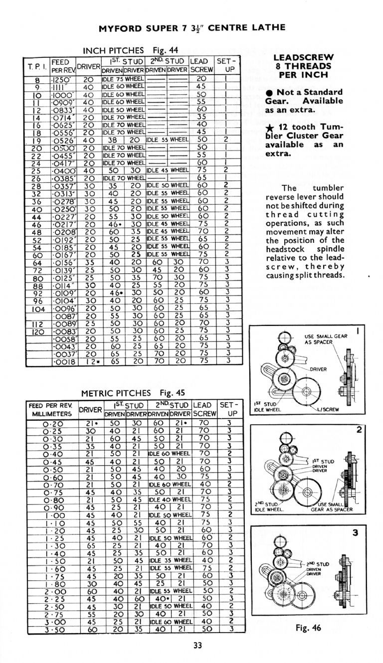

        Hi all newbie here both to this forum and to lathes. Ive been researching cutting metric threads and have got confussed!!! The first fixed wheel on my ml4 is a 25 but your ml4 thread states theres is a 20? Also i have found charts saying different combos of gears. I’ll try and add some picks if I can work out how.can you please help me to know what sizes I need? Thanks

              A good source of info on ML4s might be the Yahoo Group for Myfordlathes.
              Charts of change gears for cutting metric threads with 8tpi leadscrew and standard changewheels appear in Martin Cleeve's book Screwcutting in the Lathe, which is quite inexpensive.
              The gear on your lathe, or the one in the other thread, may have been changed over the years if it is the removeable type. Not sure if they went to a bigger gear when they went to the larger diameter spindle. It's possible.

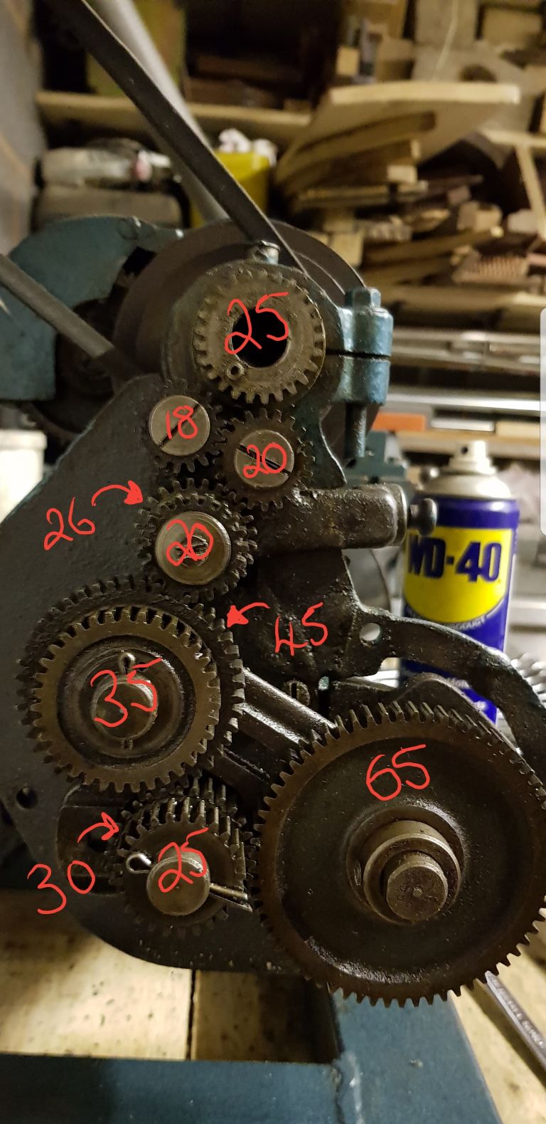

                what i was trying to ask was if the tables i found were correct. as they have different information in them. or are they just different ways of reaching the same outcome?

                  Ah, there's a bit of a trap for young players shown in your pic there. Your lathe has the optional, but very handy, tumbler reverse mechanism. So the gear on the spindle is not the first gear in the train used to set up for screwcutting. Usually, the gear you have marked as 26T would be 25T the same as the spindle gear. That way, it rotates at a 1:1 ratio with the spindle, regardless of the sizes of the two intermediate idler gears. No idea why or how yours is a 26??? Try recounting and see if it is in fact a 25T.
                  With a 25T on the reversing tumbler, the 20T gear you have shown coupled to it becomes the first gear in your gear train for using those screwcutting charts. You then follow those charts for the first gear (labelled either mandrel or driver on your charts), first stud, second stud and leadscrew gears.

                    Martyn,
                    I agree with Hopper, and you can easily check the truth by measuring the diameter of both gears, they should be identical without having to go to the trouble of counting the gear teeth.
                    ML 4 lathes were all fitted with a 25 tooth gear on the spindle, locked as yours is with a grub screw across the joint and it was matched after the tumbler reverse gears by an identical 25 tooth gear. The stud that is mounted on was extended to fit the first gear in the chain, the so called Mandrel gear.
                    The reversing gears are both idlers and play no part at all in the calculations
                    And your earlier thinking on the differing charts is correct, there are often several ways of setting up gear trains that give the same result for the pitch of a screw thread, no one result is better than another.

                      Martyn,
                      Looking properly at your picture, the only working gears are the 20 as Mandrel and 65 on the leadscrew.
                      The 45 and 30 are idlers and make no contribution to the calculation, the other two [35 and 25] are being used as collars to take up the space on the studs
                      So the threading calculation boils down to 20 divided by 65, multiplied by 0.125 [8tpi as a decimal figure] which gives a pitch result of 0.03846– inches. Expressing that as the reciprocal gives the final result as 26 tpi and if you look at the entry for that pitch on the ML 4 table it is identical

                        My maths / arithmetic is pretty ropey but the OP says the mandrel is 25 tooth so by my reckoning it looks something like this, using all the gears that are in mesh:-
                        Ratio (Driver/Driven) = 25/20 * 20/26 * 26/45 * 45/30 * 30/65
                                                     = 1.25 * .7692 * .5777 * 1.5 * .4615
                                                     = .384615
                        Multiply by pitch (.125) = .048076 or 20.8 TPI or about 1.25mm pitch
                        I rounded the ratios a bit as they work out to about 8 decimal places as is usual with gear calculations. Don't know whether this is particularly useful, is the set of gears shown supposed to provide a specific pitch / tpi?
                        Of course my calculations may be off or I have misunderstood something (probably both) frown

                          Posted by Journeyman on 08/04/2018 12:08:07:
                          Yep. Get rid of all the idler gears out of your calculation. wink
                          IE, back to the 20/65 as per Brian Wood above.
                          Edited By Hopper on 08/04/2018 12:25:15

                            Journeyman and Hopper,
                            I have made the assumption that the 26T gear was in error, if fact I doubt if it could be made to fit on the standard ML4 reversing cluster anyway and mesh happily with the smaller idlers.
                            Regards
                            Brian

                              Yes, but the mandrel is 25 so should be 25/65 which still gives and end result of .048076 or 20.8TPI !

                                Sorry to have to correct you, the spindle gear, reversing cluster and the erroneous 26T gear are all part of the first stage in the drive down from the spindle and will normally be, in this case, 25/25 to give a ratio of 1, I have corrected the 26 to 25. Note they are all running as idlers however they are meshed..
                                The first WORKING gear in the change wheel drive is in this case the 20T gear

                                  Don't be sorry! I understand now what you have done. Always willing to learn a bit but things take longer to sink in these dayssad Just to put my mind at rest, I did the calculation again using all the gear ratios but using your assumed 25t gear and got the same answer as you. The idler ratios do indeed cancel each other out…

                                      Thanks Brian, I think most of my confusion arose from the "Mandrel" gear which I erroniously assumed was the "Spindle" gear not something that was in fact half way down the gear train. It's a long time since I used a Myford. I hope my error has not confused the OP, if so my apologies.

                                        Got things a little more straight in my mind now and know which gears I need to do m6 m8 m10.
                                        Taken gear off and yes I’m wrong it is 25!!!
