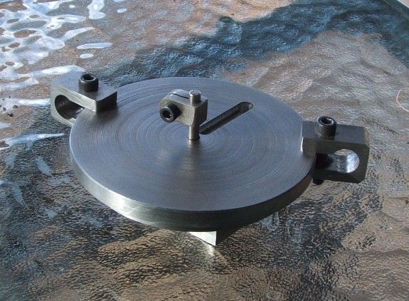

        Hello Gents,
        First post for me, complete newbie to model engineering so please accept my apology if this question has been done to death!.
        How are the round big / little ends of a coupling rod machined? I have a small lathe( 3 1/2 inch centre height) a vertical slide,so can do a little milling, but for the life of me I can,t picture how to go about this machining.
        Needless to say for someone who served his time at Leyland Motors in 1980-84,
        I am a little embarrassed My God was it really thirty years ago.
        By the way, the loco is the Achilles 0-6-0. Any help / pointers would would be greatly appreciated. Thanks Andy.

              Filing buttons will do the job, but this is a gizmo I made for use in the mill, you may be able to adapt it for lathe/vertical slide use.

                I use a rotary table on the mill, have used a bit of a stub arbour tapped .25 could be almost any dia depends on your kit, this goes into centre of table and I make up stubs to suit the job which screw into the arbour, or you can do what tel has done will post a pic to explain better.
                Good luck

                            Hi hope this comes out, pic of rotary table
                            Bob
